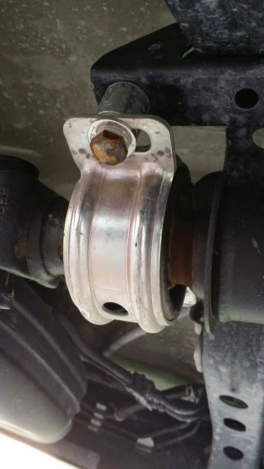

    This is it in the regular position. I don't see what flipping it does. Anyone care to explain.

    I had the same issue with the slight vibration then flipped the bearing and the vib went away.

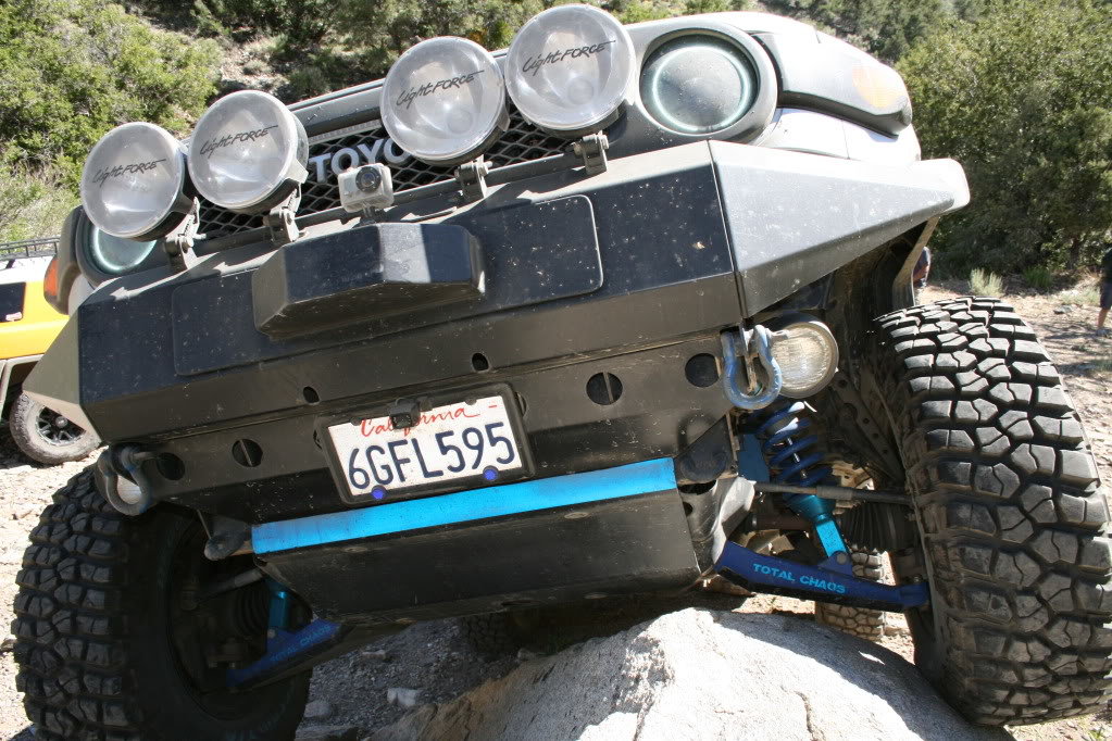

    As far as hitting yes the BD can hit stuff just like my FJ with the TC long travel and same size tires as my tacoma hit shit all the time and anyone that does any off roading besides fires roads hits shit and that why theres armor and factories back east making replacement parts everyday.
    Do i worry about hitting my BD on a rock? no just like i don't worry about a rock hitting anything else under there, now do I go slamming at full speeds into these rocks? no and it doesn't matter what vehicle I'm in I try and pick the best line and keep going forward.

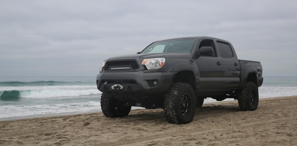

    I like the Magnetic Grey Taco. That yours? What beach is that? Surf looks small but clean and no one around:)

    Yes there both mine the tacoma is 2012 the fj 2007
    The beach is Hueneme, small but had some nice little sets that day.
