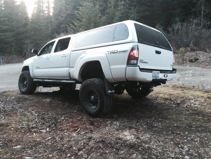

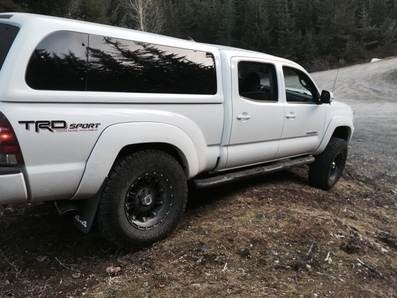

    Was finally able to get out and stretch the legs after getting my cab mount chop done! So happy with this lift and set up!
    C0FF5104-E88D-44A4-9013-F76ABBEF8661_zps_6ddc819c897c482ada380cdde3f33fb2f0824ff9.jpg
    92D0911C-A220-46AE-A255-2C7BB5E56855_zps_d24cf0f8d7bd96993af1e56f7c7a6d73eb2f1215.jpg
