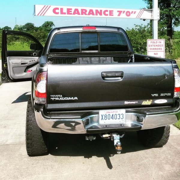

    Rcd lift, 883 springs, tss wheels with 35x12.5 tires.it sits .75 inches lower in the back. Where I'm parked makes it look worse. I had to run 2 inch wheel spacers with this set up. received_614800519455.jpg 20150430_154045.jpg received_614800514465.jpg,

    I would like to see a better picture of your cv angles with the 883 coils if you don't mind.

    Once I get home tomm, I can post a pic.

    Awesome that's not bad at all, I appreciate it!

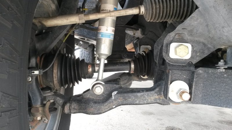

    I'd say I got 1.5" out of them. I didn't measure before /after but my cv axles were completely straight without them. Here's a few pics showing the cv angles with the Eibach. Ironically that I have a 1/4" top plate spacer on driver side and it's still a tad lower than the passenger side. image.jpgimage.jpgimage.jpg
