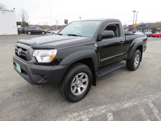

    Here's my new rig; 2014 RegCab TX Edition

    Texas Edition??? Never heard of such in a Reg Cab. You sure somebody didn't just put that together?
    Nice looking truck either way.

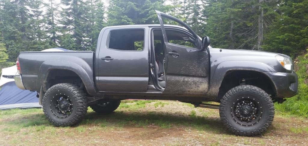

    I'm looking at ordering my RCD lift with in the next month or so. I'm going to be ordering the OME Dakar rear leaf springs as well. What size block do I need to order as well so I don't have the bro lean? Anyone have pics of this set up?

    Here is mine with Dakars and 1.5" blocks. Sits about 1/4" higher in the rear. Very slight rake.

    Dang sweet looking rig! How does it do once you put weight in the back?

    Thanks! It smooths the ride out with weight. Handles quite a bit too. Very happy with the Dakars.
    I used OEM bushings with them the first time and I couldn't get rid of the squeak. I called Wheelers and bought Energy Suspension Poly bushings. It's been a year and a half now and still no squeaks. I used Energy Suspension grease when I installed the bushings. VERY sticky stuff!
