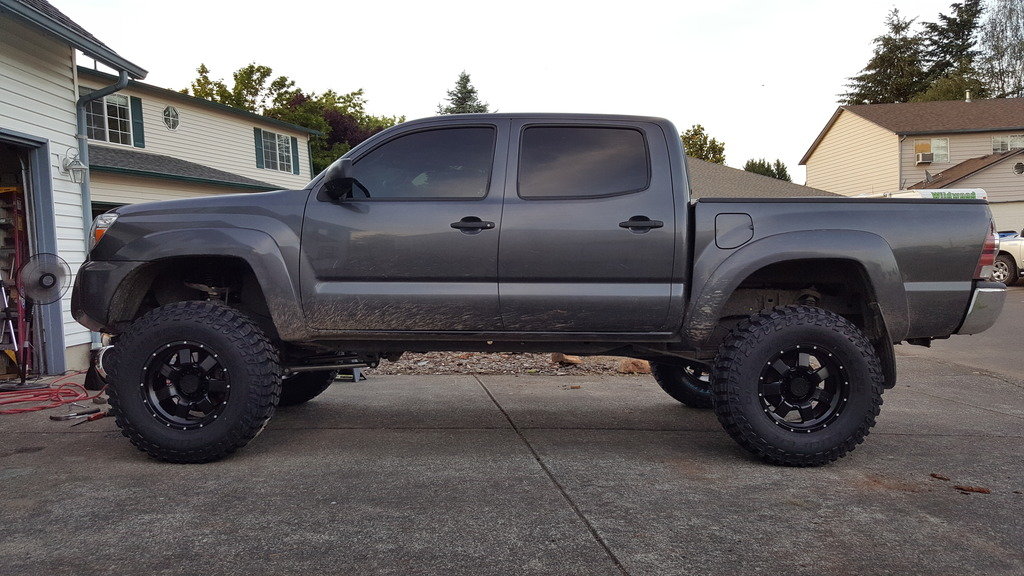

    Finally put eibach springs and 315/70R17 tires on.

    Eibachs installed with 1/4" spacer on left side.
    Measurements when I bought the truck new:
    LF 20 1/2"
    RF 20 3/4"
    Measurements now:
    LF 27"
    RF 27 1/4"
    Lift result from stock:
    LF 6.5"
    RF 6.5"

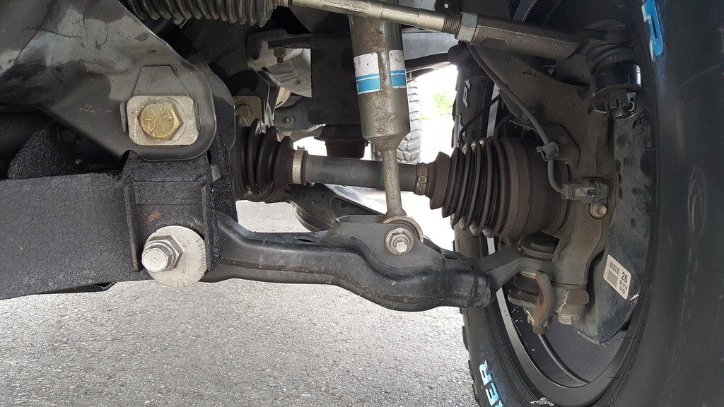

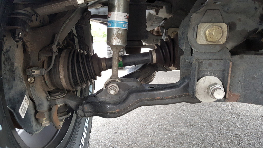

    Alignment has been done. Inner right CV boot fins are touching. Left side is close, but does not touch. The weird part is they did not touch before the alignment. The only thing I can come up with is that having such high caster has moved the axle forward enough to cause them to touch. Need to figure out something before they wear through. Either go with 883s, do boot slide mod, or reduce caster to see if that helps.
    Not sure if I will need to do CMC until I take it off road and do some flexing. Around town, no rubbing.
    LR UCAs are set a +2 degrees. Alignment numbers for caster are 3.50/3.59 (maxed out at LCA).
    CV axle angles:
    20160608_090814_zpszdtq9dd0_4da27f2e7eac6c1d60f9eb1f6df3e18c5c21d721.jpg 20160608_090749_zpsnaqo96vi_3a89c2842face8060387287744569ef6e87dd143.jpg

    Also worth noting the fins on the CVs no longer rub after springs settled a bit. Very happy overall. No regrets.
