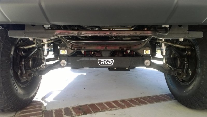

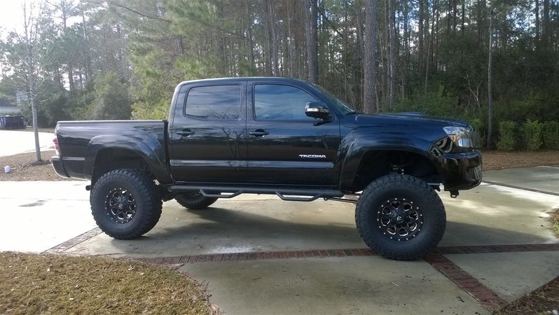

    I just installed an RCD lift on my son's 2014 along with OME 884 coils and Icon progressive AAL with the block that came with the kit. I haven't read about anybody else using 884s, so I wanted to post the results. We put on 315/75-16s. The combo yielded about 7.25" of lift and the CV angles look good to go.
