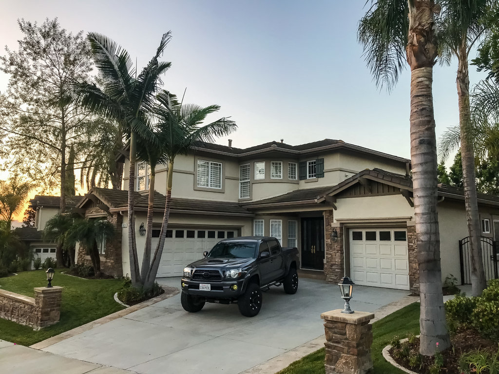

    7 years on the truck and still going strong. Custom Alcans in the rear is the best setup.

    I'm pretty sure I'll be getting a set next year. How much lift did you order for the springs, 4"?

    Yep 4 inch and a torque spring
