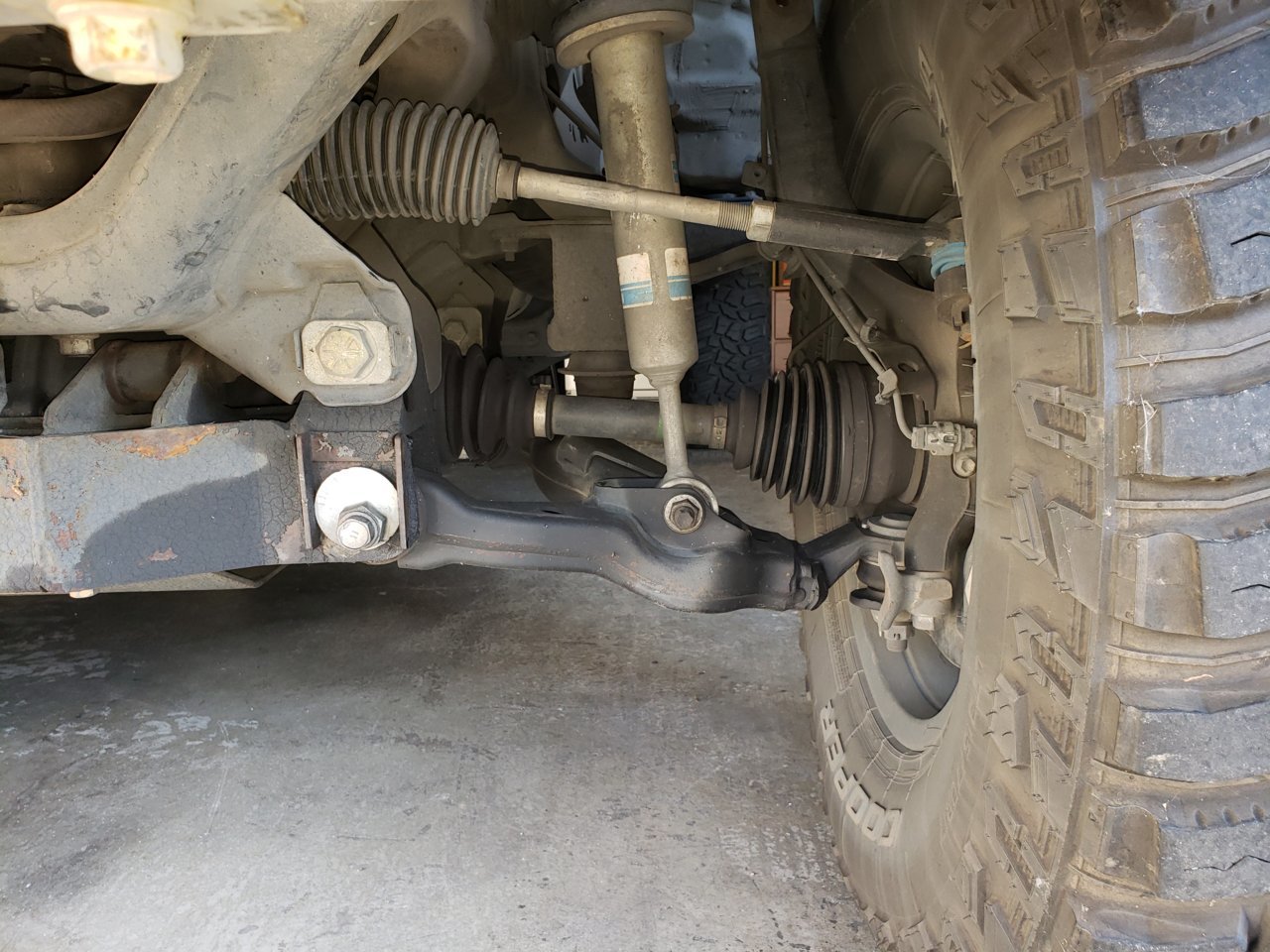

    With the Eibach 620 springs and RCD billies how are your front angles compared to the 3” setup on your previous truck? Since your drop is 4 1/4” the angles would be equivalent to about a 1.75” lift from stock height right? Are you happy with the ride of the 620 springs with the RCD Bilsteins?

    Definitely better angles than my previous 3" lift. I've been fairly happy with the ride.
    Here's a pic of the angles:
