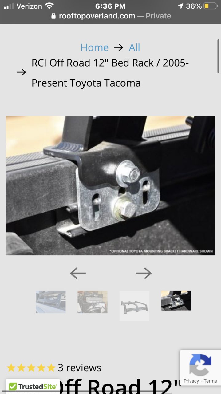

    Problem is my bed rail sits closer than what’s in the photo with the mounting hardware. I’ve tried putting plate in front and behind

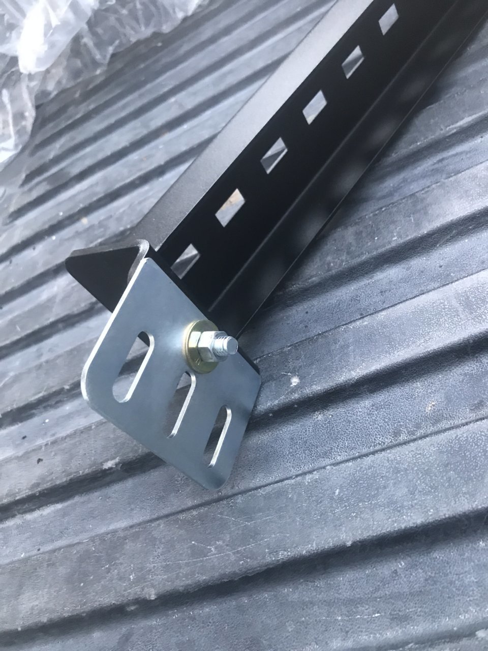

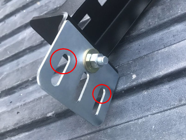

    2" is the rough height difference between 2nd and 3rd gen Tacoma railcaps, so the hardware probably needs different arrangement to work on 2nd gen compared to the 3rd gen pics on the web site.
    Put the plate in front. Use the two holes on the side so the washers don't clash?

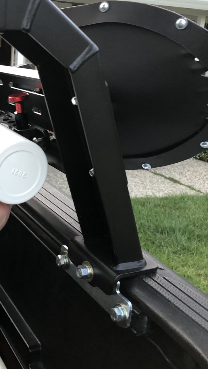

    I had the same problem with mine, but I reached out to them and they sent me the correct mounts right away. These are the brackets you need. RCI is a great company with great customer service in my opinion.
