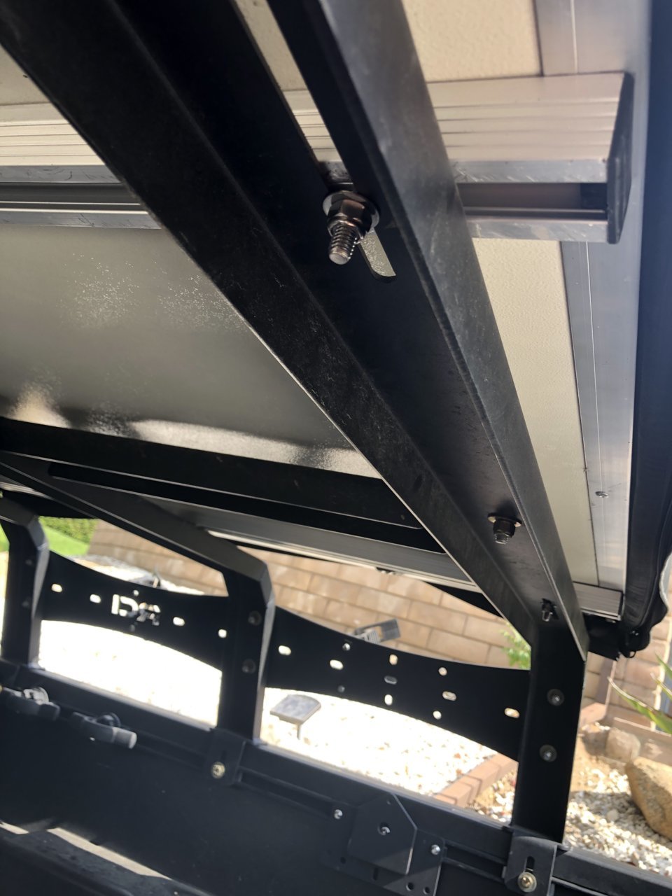

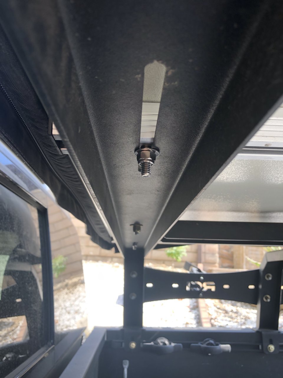

    I just changed the way I mount my rtt to my rack, I’m gonna test it out to see if it will give me any trouble or not. 3F3CE1BD-7A03-4A23-AE4D-036E668EC405.jpg

    how has it held up so far? looks like a good option for mounting RTTs

    So far so good, I check on it from time to time and it hasn’t budged. I’m happy with it. Also I think it looks a lot cleaner this way
