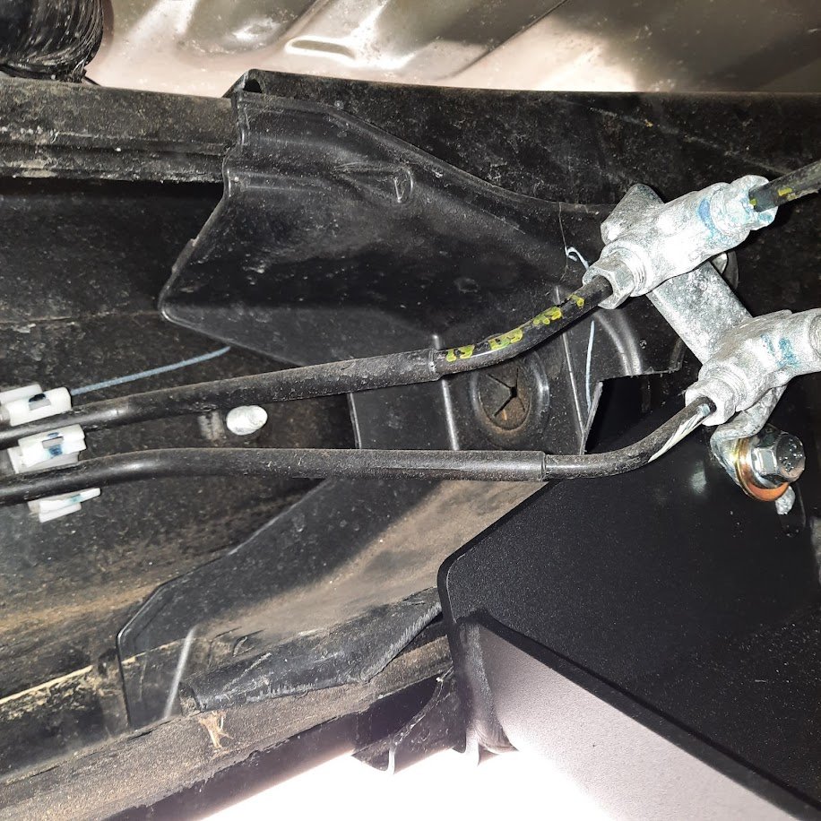

    Put the full skid set including the cat "wings" on Dad's 2020 Sport yesterday. Thought this might be helpful as he wasn't happy with removing the plastic "blocker" for the space above the frame rail on both sides that has to be removed in order for the crossmember that comes with the TC skid to fit. Guess they're there to keep critters and excessive debris out.

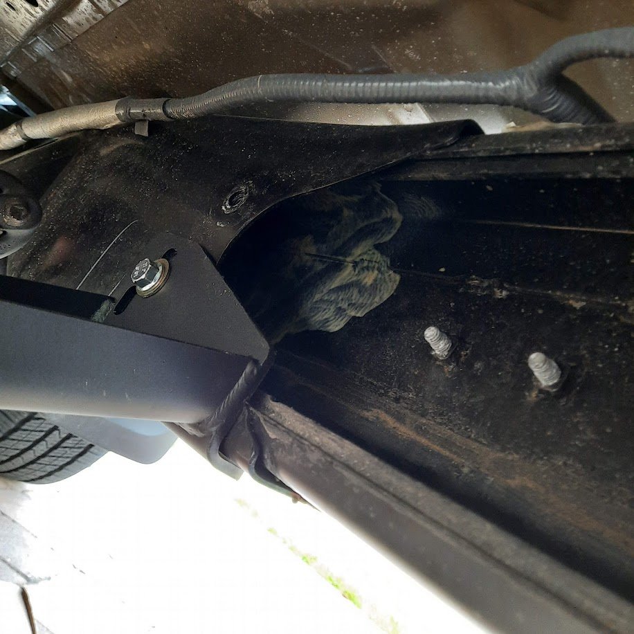

    Anyway, after looking at it a second, I cut some of the "blocker" away and was able to reinstall on both the passenger and driver side (pictured behind the brake line junction). This is probably obvious to most but didn't occur to me until he made mention that he didn't like the fact that they were there for a reason and were being removed.
    Really impressed with the RCI skid package overall. We put the transmission skid into place to see about where to mark for drilling and installing the "wings," which Pop took care of while I was crawling around underneath to put in the crossmember and putz around with the "blockers" shown below. Back to the kit, everything fit very will, all the hardware was spot on and it seems like the thing could take an IED blast and survive now. He should be good at his usual fishin holes from here on out I would think.
    Here it is on passenger side with the RCI crossmember attachment point and the "blocker" removed.
    RSJyDfKc2xJeAVoNHphQG3qLzQttMpDhL48HBvk9_1062d8427553b63f667e977003308c9d0db85509.jpg
    Blocker after being "modified"

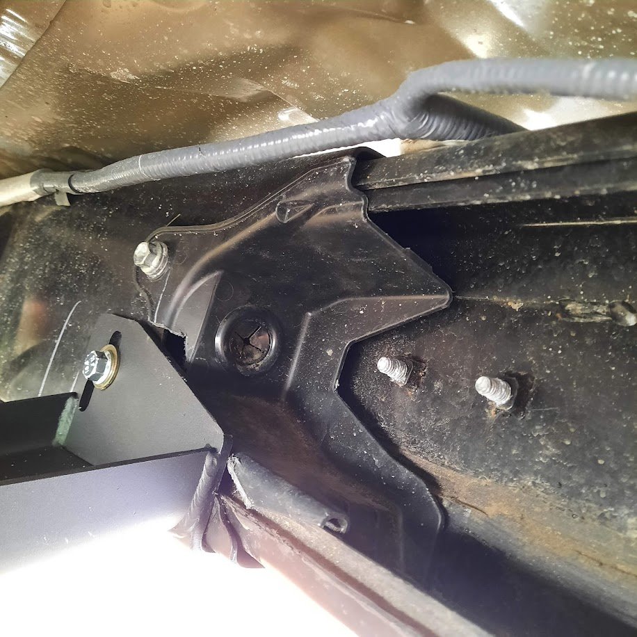

    And reinstalled:
    ZaKk3uFa1gEOJ-9YxoG3Q5WBhkScJUiKpbjI6_tu_084cff4a8b86f61b14beef9fc9fe59897a1bc04b.jpg
