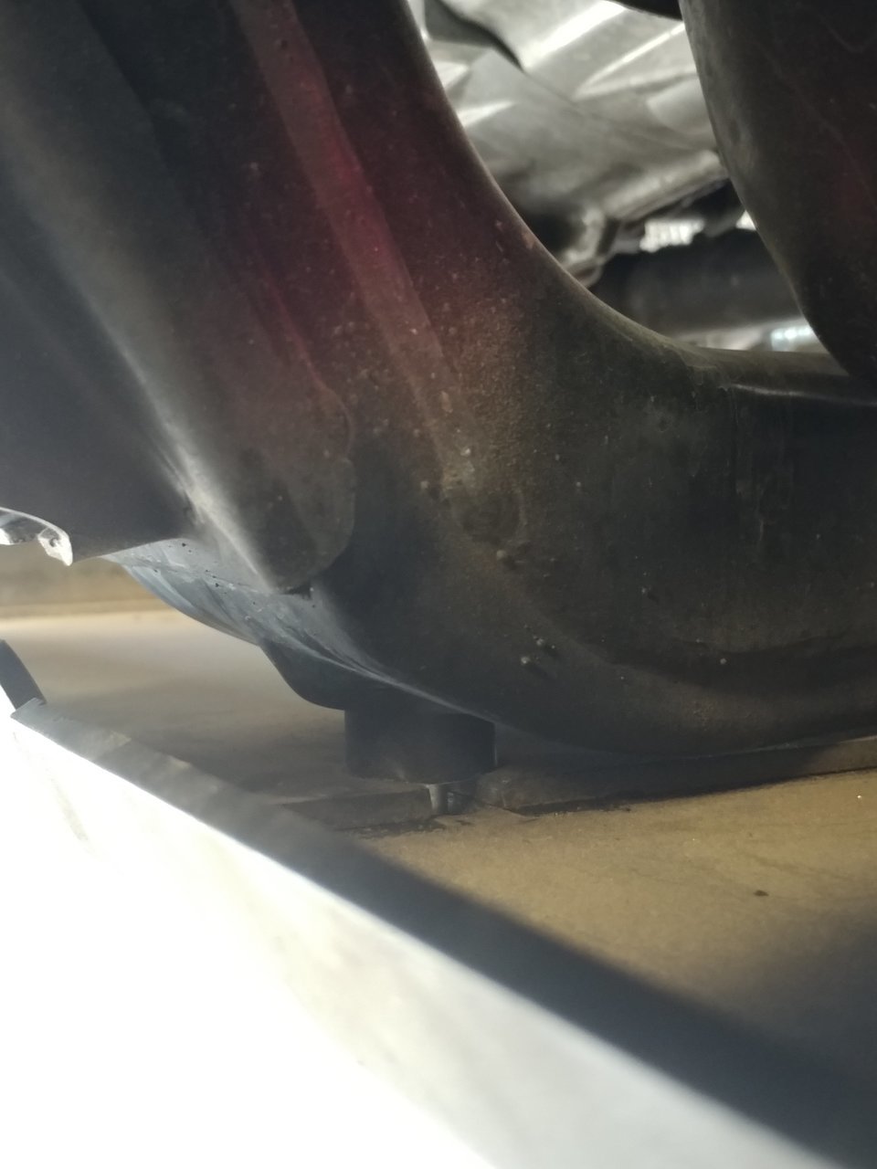

    So I've communicated with RCI about this problem and they say its normal and that's the way that these skids are built. With that aside I wanted to see if other people have the same issue, and this issue only applies to 4wd Tacomas.

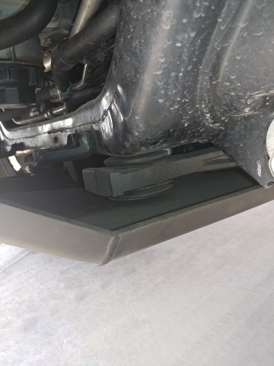

    My skid plate is making contact with my front diff 24/7, I didn't notice this upon installation, but my Off Road shop told me that they were making contact; and that it was not okay. My shop provided me with some washers to act as spacers in the mean time. I'm glad they noticed because the road vibrations have started to cut past the paint into the steel.
    Before you ask; I do not have a diff drop, so that is not the problem. Here are some photos of whats happening. Anyone Else have this issue that can confirm this is "normal"? I want to know because RCI will not stand behind their product. To me it doesn't seem right, but I could be wrong.
    *Update* they are sending me a diff cage to correct the problem they are standing behind their product. RCI took care of me, and I am glad they did.

    No Damage
    No Diff Drop
    Diff Making Contact
    Paint and Steel scraping away from diff

    My RCI skidplate came with plastic spacers that you can put on the rear bolts between the plate and the frame to keep it from hitting the diff. Did yours have the spacers and if so, did you install them?
    Edit: the spacers are about 1 inch.

    I have those installed.

    That doesn't seem normal. Maybe you need slightly longer bolts and bigger spacers?

    I would but, I don't want more stress only on mounting point, Those plastic spacers are fine because they are the same thickess as the middle of the crossmember creating a nice support flush with the crossmember.

    They advised me to install spacers and longer bolts on the front of the skid, that I could get it from a hardware store or pay them to ship some. They also offered to sell me a newer version, heres a copy/paste from their email.
    We have designed our new style front skid plate with the differential clearance in mind. The skid plate now has a diff drop cage as to provide clearance between diff and skid with or without the drop kit and will not require the spacers to install.

    That contact is so minimal, you could likely bump that spot on the skid with an angle grinder and flapper wheel and solve your issue. If not.... bump a spot on the bottom of the diff too.

    While that is an option, it should not even be an option IMHO. Plus, if that skid takes any kind of hit while off road, the contact will be even greater and that is no good.
