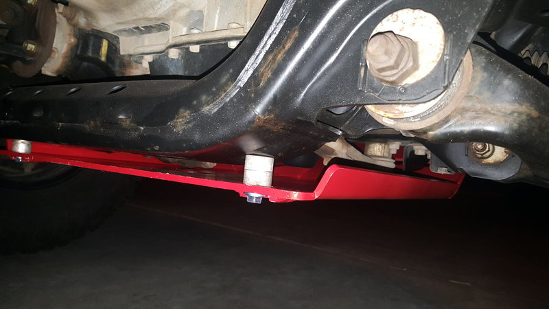

    Went the red route too after seeing the above :D Wound up having to use two nylon spacers on each of the front bolts, and two thick metal spacers that were on the stock skid to clear the differential, and it's still only a few millimeters from hitting it. Makes me a little worried the first time the skid is hit that it'll push up and maybe cause some damage. You can see the tolerance in the last photo
    Edit: only bugs me a little bit, but makes me wonder if i uninstalled the diff drop kit how big an issue I'd have

    have a diff drop
    Hitting the diff with stock spacers up front, nylon nuts not even touching the cross member, going out to depot to get some longer bolts and more spacers.
    Love the skids tho great stuff, kinda expected this diff problem

    Joe
    Eagle PA
    11 DCSB
    couple extra nylon spacers and a couple longer bolts......all good!!
    got about 1/4 to 3/8 clearance
