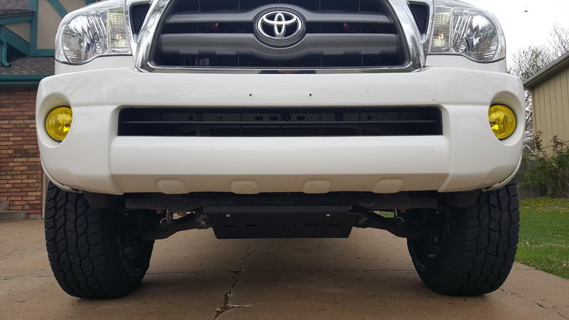

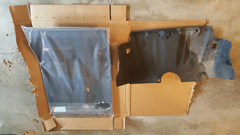

  14. Mar 25, 2016 at 6:03 PM
    #74
    1madmnky
    1madmnky Well-Known Member
    Jan 30, 2016
    #176630
    298
    Tony
    Kansas via Fullerton 714
    2010 Tacoma 4X4 DCLB
    Hella Supertones
    Did you mount it already? what size washers did you use? pics?
  15. Mar 25, 2016 at 7:31 PM
    #75
    1madmnky
    Jan 30, 2016
    #176630
    298
    Tony
    Hella Supertones
    You didn't need longer bolts? did you need it on all the bolts? what size did you use?
    Sorry, for all the questions, this would help me and the others when they only order the front skid plate.
    Thanks
  16. Mar 30, 2016 at 1:25 PM
    #76
    1madmnky
    Jan 30, 2016
    #176630
    298
    Tony
    Hella Supertones
    Skid installed, used 3 washers on each bolt, no vibration or rubbing so far.
    Compared to the stock skid plate.
    175908 likes this.
  17. Mar 31, 2016 at 4:19 PM
    #77
    1madmnky
    Jan 30, 2016
    #176630
    298
    Tony
    Hella Supertones
    I did 3 washers on each side, the front diff is on the skid plate.
    The only new noise from my truck is when I'm decelerating to exit the freeway and I think it's the diff vibrating on the plate, I'll take the washers out and replace them with thicker nylon spacers.
