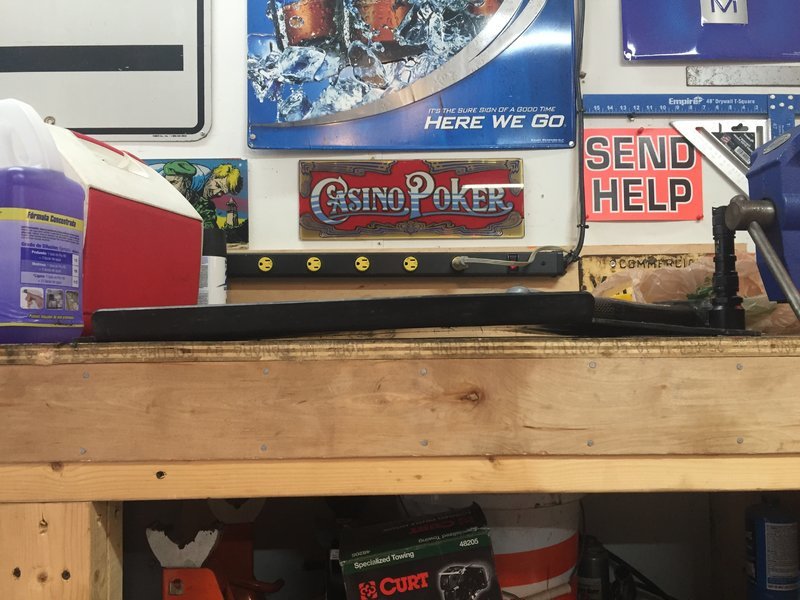

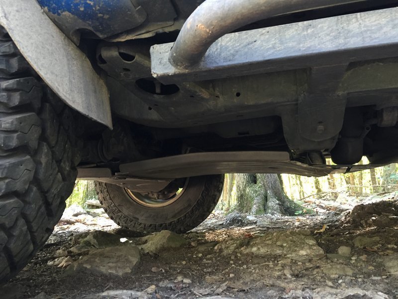

    Lighter, definitely not stronger than steel. I should have gone steel.
    If you look at the pic below, the tranny skid should be a straight line, not curved. Also note the washers I had to add to the provided RCI spacer (if you have stock exhaust that is not rerouted, like mine). If the washers weren't there, then the spacer would be flattened.
    Photo Credit @HolyHandGrenade
    3/16" Steel should be stronger, but a buddy of mine had similar bending issue with his steel RCI tranny skid. The long span of the skid (Aluminum or Steel) is unsupported along the length and prone to bending. He had to add steel reinforcement to his steel tranny skid along the length of the span.
    Anyhoo, the aluminum skids have done their job. Nothing in the underbelly of my truck that the skids were designed to protect, has been damaged. And the truck has been bashed and abused dealing with some serious shit at Rausch Creek. I'll use the aluminum skids until they can no longer protect the belly of the truck. Then I'll switch to steel.

    There are a couple of problems with the trans skid. The first, is that there is no reinforcement across the span between the two crossmembers.
    The second is that the up turned bends on the sides end inches before where the skid bolts to the rear crossmember. I (well my Wife actually) bent my trans skid all the way across where that upturn on the sides ends.
    The third is that the spacer is hollow and thin. That's a steel spacer in @Subway4X4 's pic. That's the second one he's squished on rocks.
    As you can see from @Subway4X4 's pic, if you're going to do any serious wheeling don't waste your money on aluminum. Not only are they weak, they're also soft. When dragging on rocks they dig in instead of just scraping across like a steel skid.
    See where it bent where the upturns end? This should be sitting flat on the bench.

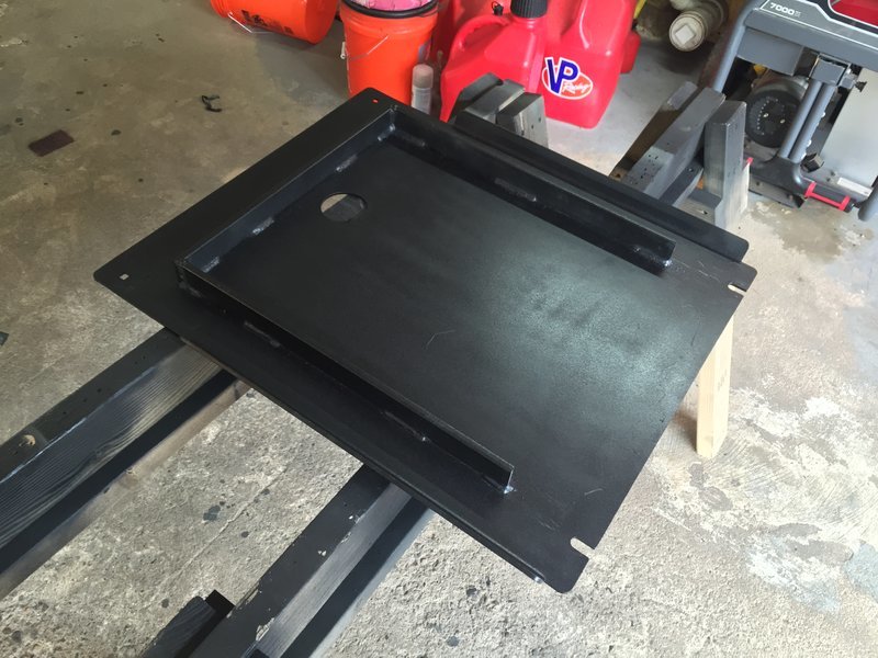

    How we fixed it. Hammered it flat and welded three lengths of 3/8" x 1 1/2" stock on the top side of the skid.
