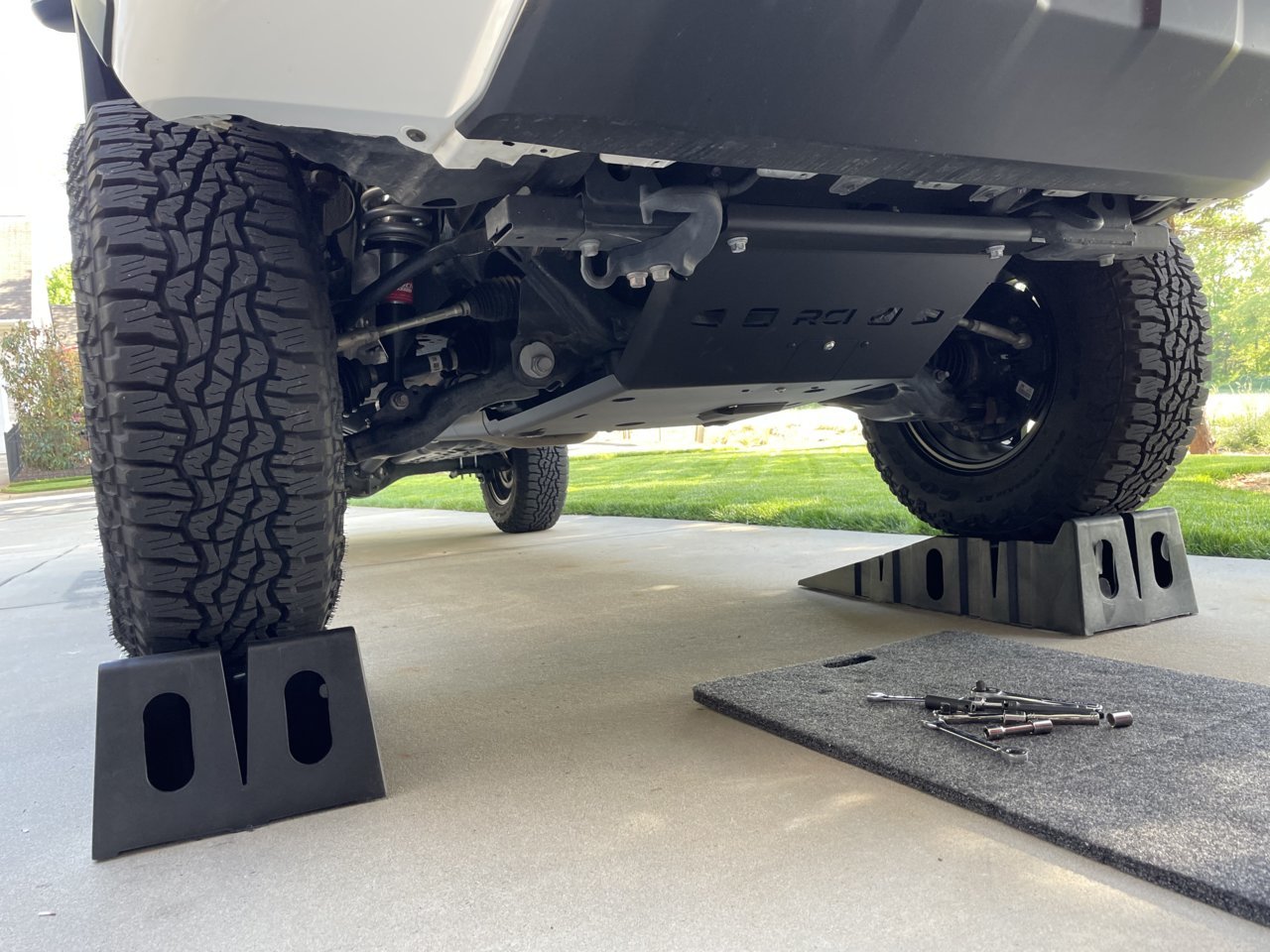

    Probably the best fitting parts I’ve seen yet! Easy 20 minute install thanks to Milwaukee cordless tools.

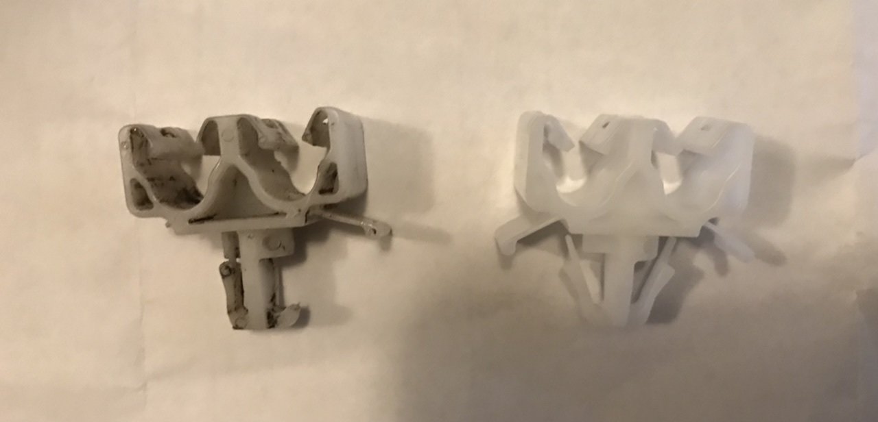

    Just a quick note on when I installed my sliders.....the cheap white plastic that holds the brake lines broke where they clip in the frame. I was careful, but they broke to easy.. part #90469-A0004 - clamp
    Old vs New

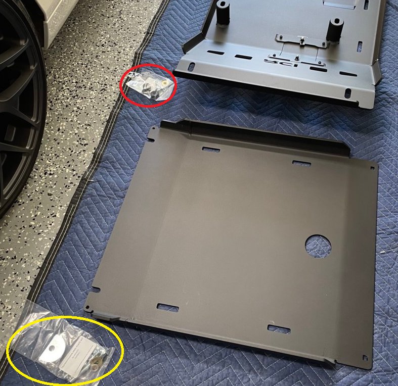

    Those spacers in the red circle were a pain. A flat-bladed screwdriver helped to hold the spacers up while I slid in the transmission plate.
    The "D" washers in the yellow circle. As I was getting the transmission plate installed, I dropped the nuts. I stopped, found it went back, and couldn't find that "D" washer. There was just enough gap in the transmission cross member for that washer to slide in. I kept looking, feeling for it. Finally, with a mirror and flashlight spotted it. It took a while to slide back out.
    @aturk thank you for posting the photo. Hopefully, these tips will help the next person out. Also for the next person, remember that supplied hardware is SAE. 17mm seems to work, but you may need a 3/4" wrench. Ditto for 14mm and 9/16". Hint, I should have checked before installing them.

    I didn't have any issues, but my skids were aluminum. Holding up the steel tranny skid while sliding it around under the truck would be tough I'm sure.

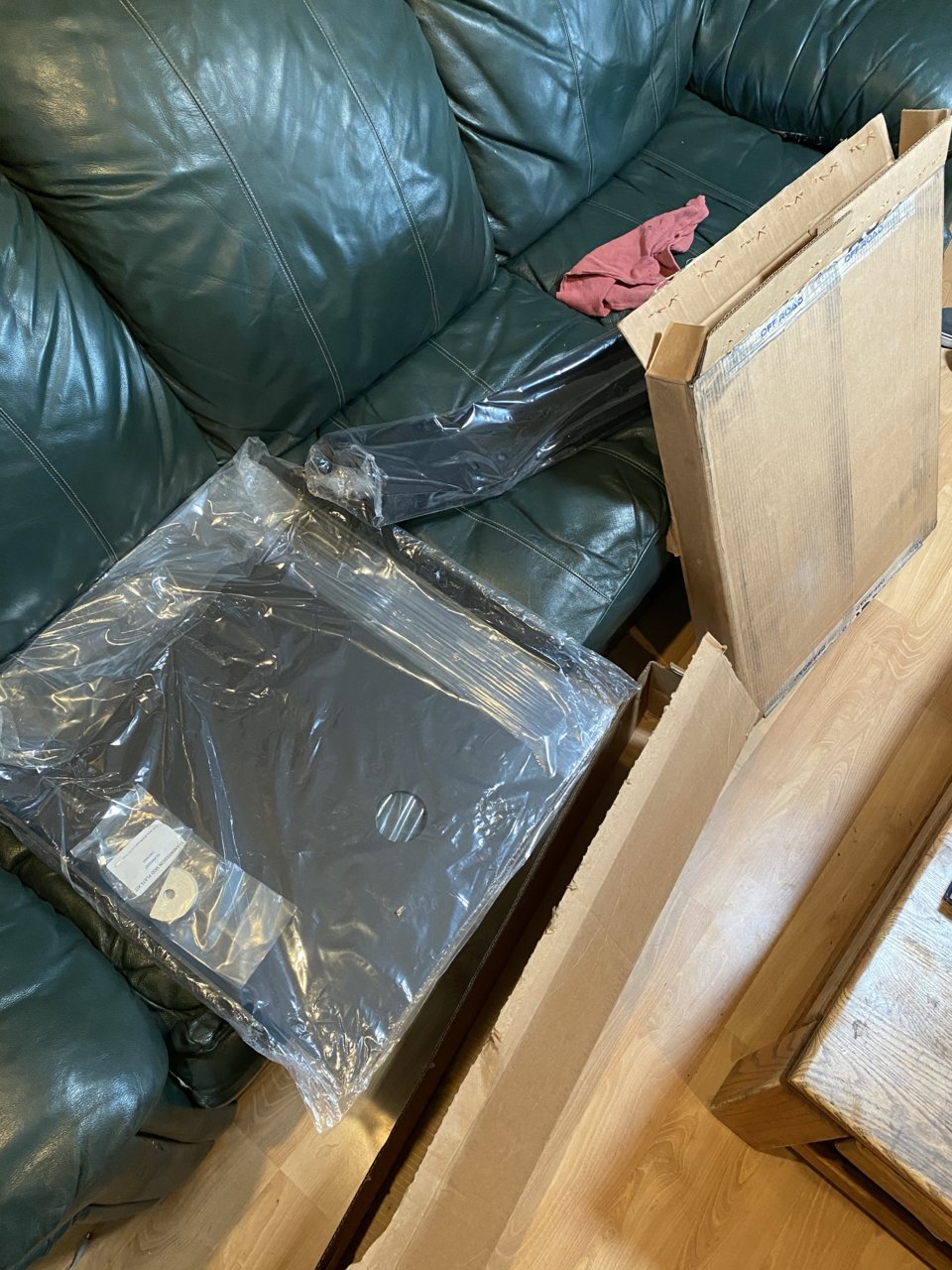

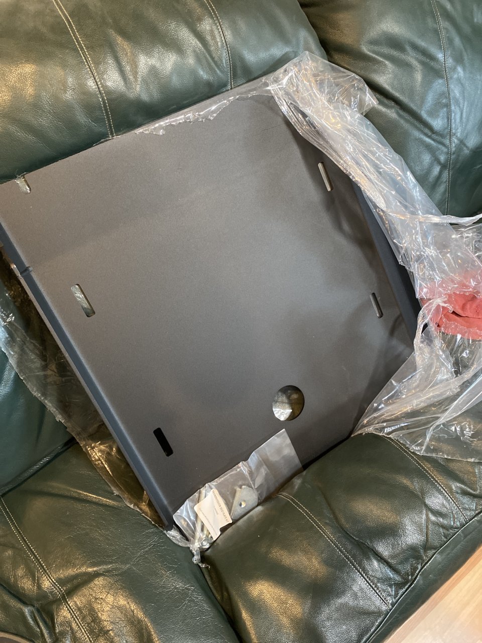

    Welp. Opened up my boxes from RCI, I've got the transmission skid plate, but not the T-case skid I ordered. They bothered to send me the crossmember, but no skid plate to mount to it. I get it, things fall through the cracks but after most people who ordered AFTER me got their skids, would have been nice to get my full order in.

    Look closely. The t-case skid is wrapped up tight nestled with your transmission plate!

    That was my thought too when only one square box arrived, but that’s a big fat negative. There is only one skid here. I emailed RCI so we’ll see.
