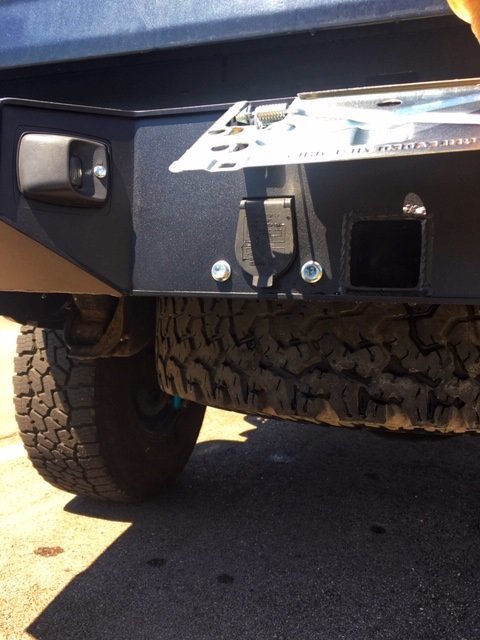

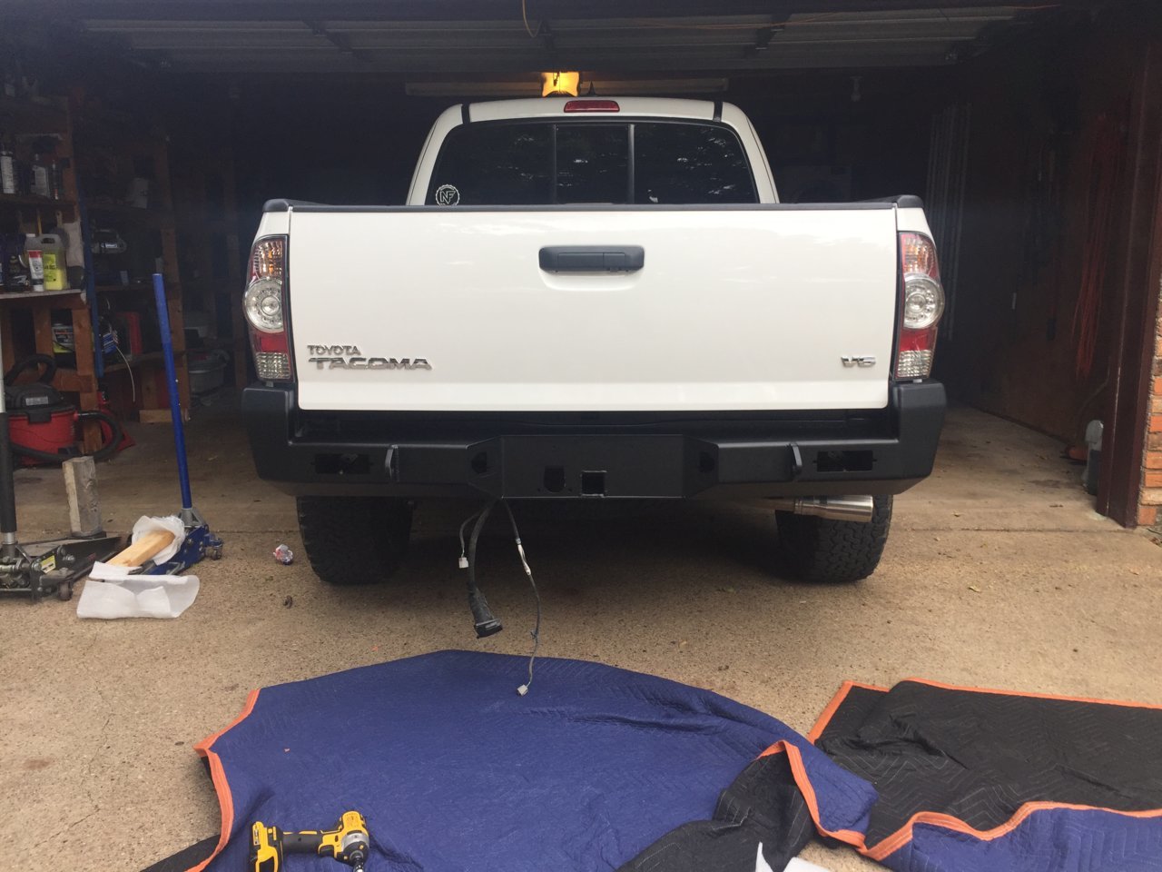

    How in the world is the trailer connector supposed to snake through? The internal bar has a recess cut to provide clearance when it’s in the final position, but I cannot get that plug snaked into position. It’s almost as if I’m missing a 1/16” of clearance. Any tips?

    About 2' up the harness, there is a connector where the trailer harness plugs into the truck harness. Unplug it and feed it through.

    Initially, I removed the sub harness as you mentioned, but noticed the bumper was actually designed to rear mount the connector per this pic in the first post:
    When trying to slide/snake it into position from the rear, there’s just not quite enough clearance.

    #146525
    3,269
    Justin
    Ogden, UT
    I was able to get the 7-Pin connector into position by using my dremel and removing about 1/32" off the bottom flat edge of the connector and sanding a radius on the upper edge, along the back edge behind the hinge point (for the cover). I removed approximately another 1/32" of material off the top edge in the process of putting the radius in it. It was snug, but it slid right into position.
    I've made RCI aware of the tight fitment, but honestly the light amount of sanding/sculpting required isn't a big deal.

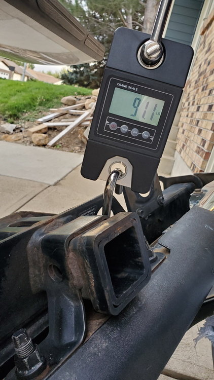

  8. Oct 11, 2019 at 7:47 PM
    #68
    nats
    nats Well-Known Member
    Jan 2, 2019
    #277793
    78
    Lakewood, CO USA
    '10 TRD Sport DCSB
    (this will change)

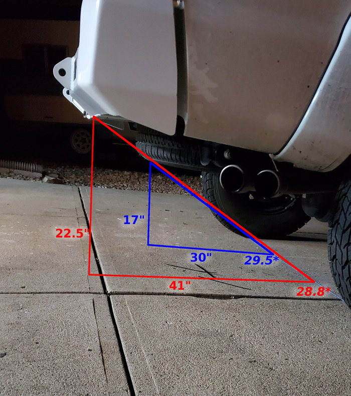

    This came out OK, eh @Joshp767 ?
    In my specific situation, it looks like I picked-up about 5° of departure angle and a few inches of clearance (gonna need to move the spare to realize more)
    Since some posts in this thread speculated about weight gain... I used my hoist's load-cell to figure that I LOST more than 15lbs (OEM includes the receiver and bumper; RCI weight had the license plate mount, but NOT the back-up lamps)...
    (for reference, 2010 DCSB Sport. Paint is Rustoleum Gloss White)

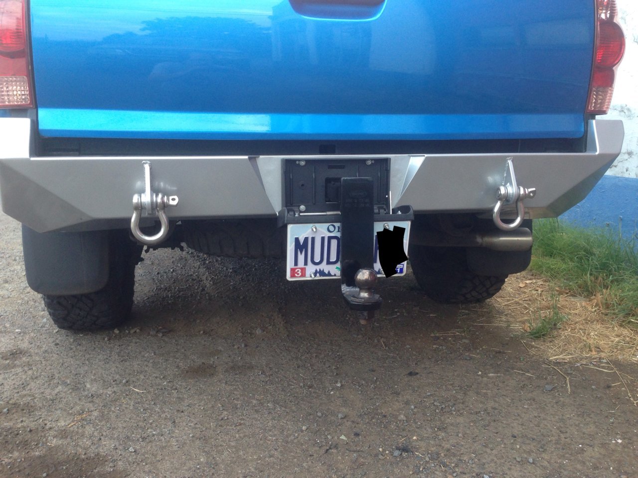

    So the license plate has to flip up to use the receiver that’s not rated for towing? That’s pretty much a ticket in every state guys. Can I retain my receiver hitch and still use this bumper?

    I've seen plenty of people with hidden hitches and flip up license plates. I think the consensus is that you can't really see the plate when there's a trailer in the way anyway. I decided I didn't want to risk getting pulled over and went a different route. Fold down step for getting into the bed and a hinged license plate for visibility when towing.

    The step was made for the front of motorhomes by a company called Fold-a-way. They are no longer made. I missed 2 of them on ebay. They sell within hours. I finally got 1. That was months ago and there hasn't been another 1 on ebay since. I cut a hole in it for the receiver hitch. Then I bought a drop stinger and extended it out. It's welded together with a reinforcing tube on the inside. The license plate hinge is a piece of piano hinge.
