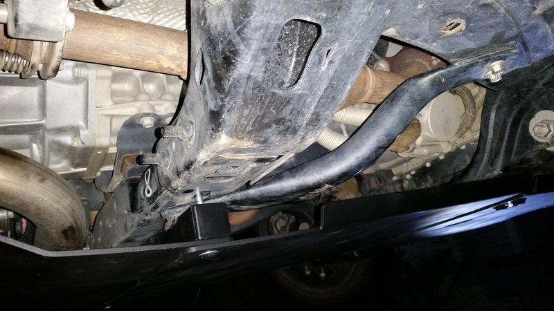

    I installed my set of three in steel today. I went to Home Depot and got 6 inch Carriage screws and used them in place of the 5 inch screws. The 5 inch barely had any threads in the nut with the cat bar, spacer bar, transmission skid, and transfer skid all stacked on there. It was much easier to start the nut on with the 6 inch screw and its not going to hit anything with an inch sticking up
    I'm very pleased that you kept the cat bars there for extra protection. I've already smashed them up once

    You are suppose to remove that CAT bar in order for everything to fit properly. That wasn't explained very well in the directions, however it looks like you found a good workaround.

    The last line of the directions for *2016 says to stack the cat bar with the spacer bar. I read it many times.

    Without exhaust reroute. And we are currently unsure if the cat bars were designed by RCI to be left or removed
    It would all sit flush to that cross member if it had a proper reroute. I didn't feel like chopping up a <1 year old truck to exhaust reroute

    I know they changed the instructions and I may have gotten an old one. Mine said remove for 3rd gen and when I did it all fit properly.

    No cat bars here. My instructions said remove.

    I think I have updated instructions but it says to remove the four screws for the cat bar and then says to use the hardware and stack the cat bar back in place. I like having them there, they are large and strong, so adding the 6 inch screw wasn't a big deal to me. Also, the spacer bar fits right into the bracket on the cat bar where it attaches to the cross member.
    I have the directions in the truck. I will get them later
