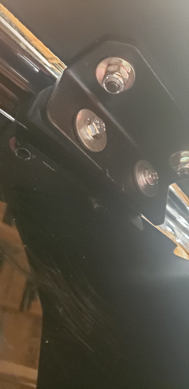

    I installed my rack this past weekend. I put it together on the truck. I placed an old piece of carpet on the roof to avoid scratches. Mounted the side rails first and left mounting bolts loose. Than I placed all cross bars and the rear faring on the roof. Installed all the cross bars on one side, leaving them loose. Than I did the same for the other side. Than I tighten all the cross bars. Front faring was then installed last. Than all roof mounts were tighten. Doing it this way I was able to do it by myself.
    As for the mounting blocks, they are solid rubber. The mounting bolts use a rubber backed washer.

    @Taco-Grinder thanks for the info. Looks really nice on your truck! I think my biggest concern is how long the blocks will last. I live in the PNW and get hot and cold weather every year. Maybe im putting too much thought into it? Otherwise its a good looking rack and im excited to get mine soon

    Sorry for the delayed response here! The mounting blocks are a solid piece of very dense rubber. These are water cut for the best possible longevity and accuracy. We have had our 4Runner roof rack on the shop truck for about 8-9 months now. That truck has been through the automatic car wash nearly 60 times and it has lived outside the entire duration as well. We have seen zero weathering on those blocks. The truck has been out in the heat(109 peak) and the cold(10 low) so far and we have found no degradation. Those rubber backed washers also prevent any water seepage over time and they have held up perfectly alongside the rubber blocks.
