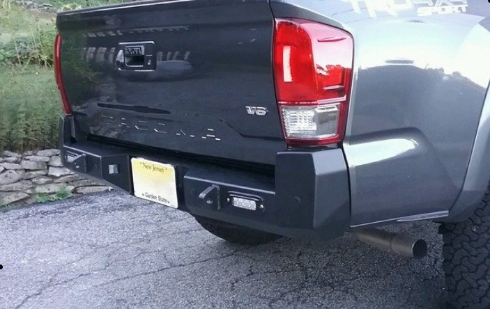

    I have an RCI bumper ordered like in the pic below. I don't want to spend the money on the Rigid SR-Q backup lights that go with it. Does anyone have this bumper or know of a cheaper Amazon light that will fit?

    I have this bumper, but I bought the Rigid lights.
    What I can tell you, is that the mounting screw holes are slotted, so there's room for variations.

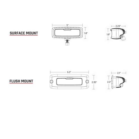

    Also, if the cutout size is similar or smaller than the Rigids, you should be fine. Attached are the Rigid dimensions.

    @Bertw192 Thanks man! I assume I need to be looking at the flush mount one

    Yes, the flush mount. I did the SR-Q Midnight Edition and really like them. Overall, the bumper is great. I sometimes think I should have kept the factory plastic... but I look at it again, and I'm reassured that the plate steel looks better and more rugged/masculine.

    They are approximately 2"x5". There are mounting holes on either side of the main 2"x5" hole, that overlap with it and create more of a slot.

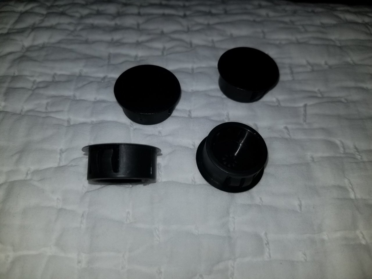

    Your bumper will come with fill plates for the light holes and plastic plugs for the sensor holes.
    However, I don't like the look of the filler plates, as they stand out. If you have the skills, I agree that it would look best to weld them solid. I look forward to seeing what you do. Of course post pictures.

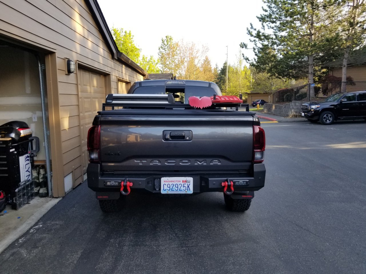

    For sure. That was a huge motivation for me and why I initially wanted a hidden hitch bumper. See my original post below.
    https://www.tacomaworld.com/threads/rear-hidden-hitch-bumpers-not-high-clearance.590385/
    Dragging the hitch was jarring and made terrible noises. I've also heard of people doing more damage to the truck than just scraping the paint off the hitch. I think in the true crawling thread, someone said it caused the bed and canopy to contact the cab and busted a window. No bueno.
