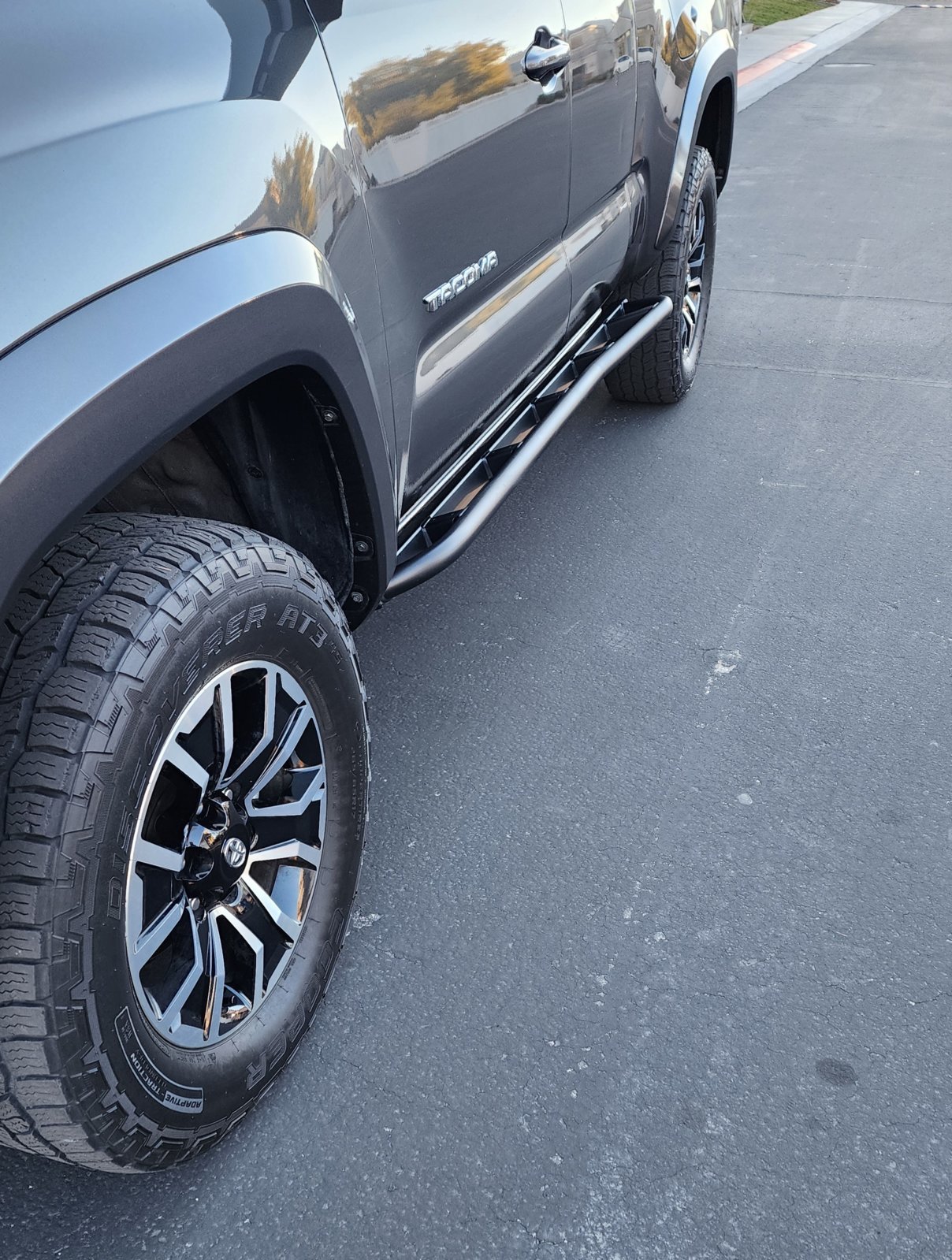

    These are the photos I wish I could find when I was searching for rock sliders, specifically RCI.
    2021 Toyota Tacoma TRD Sport 4x4 - Access Cab w/ Long Bed (6FT)
    • RCI Rock Sliders — 20 Degrees (Standard)
    I wanted heavy duty rock sliders to protect my truck off-road that I could also use as a Hi-Lift jack point. As a bonus I wanted door-ding protection while mall crawling, but it was very hard to determine if these would truly provide that with the 20 degree angle - I'm happy to report these do indeed protrude just enough to protect from trashy people dinging your doors.
    No issues with shipping. No damage. The powder coat finish is nice and arrived intact.
    Installation was relatively simple and these securely mount to the frame itself. Feels completely solid and good mounting hardware was provided.
    I'm happy with the dimensions and coverage. Only thing left to do is go scratch them up.
    Thanks as always, RCI.

    Was this a change that happened to 22 and later?
    Also thanks for this post, it is hard to find photos from all these angles to determine if the kick out comes out too far.

    Thanks for the pictures, they were perfect. I just ordered my set from RCI based on your pictures.
