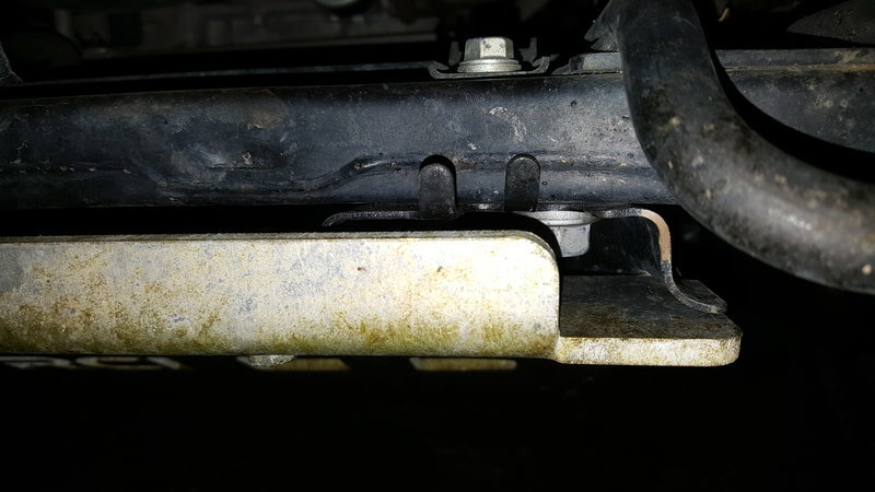

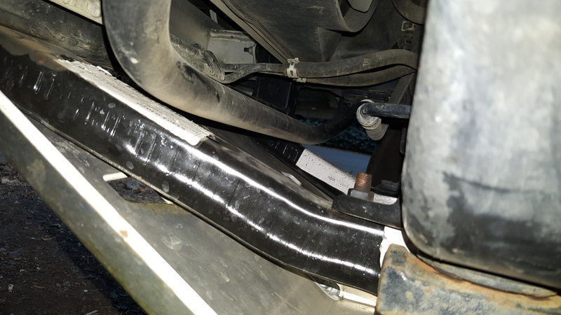

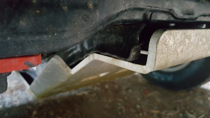

    Here are some pics of my rci ifs.most aftermarket skids have you remove the brackets to which the factory skid attaches. Some aftermarket bumpers such as Allpro also have these removed too. ARB bumpers do not. I get that the new skid replaces these and hold everything together but I feel as though the brackets provide alot of strength to that area. I was unhappy with taking them out. Plus if you bash in the skid in a wreck or on a rock it might hit these brackets rather than fold all the way in,. I put in a fumoto valve so i wanted all the protection i could get . I was able to leave the brackets in place. I drilled the skid and reused the smaller bolts that held the factory skid to the brackets. (I later upgraded to grade 8 actually) let us know how the install goes and good luck 20160907_191138.jpg 20160907_191210.jpg 20160907_191305.jpg 20160907_191219.jpg

    I am VERY happy with my ifs skid and would buy it again without question. It came super clean with perfect welds and finish. Though I chose to mod it in order to leave the brackets in place I am still very happy with my purchase.

    I for one was happy to sacrifice the <one inch of clearance to leave the brackets, which in my opinion are structural. They also back up the skid if you bash something way hard. Mine has gussets that fit around the brackets, you can see them in this pic20160907_191305.jpg

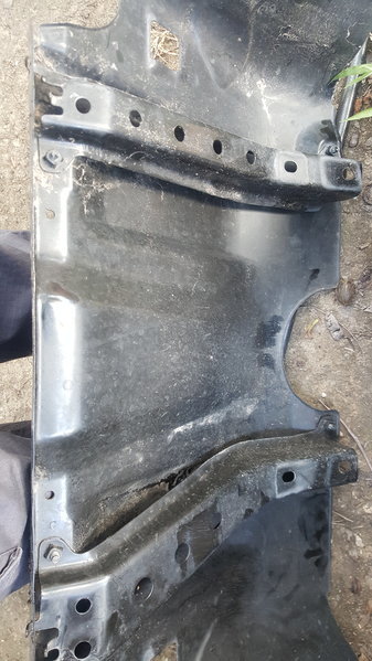

    You can see them in my pic from the other thread. The new skids don't need any additional brackets, as they're 3/16" steel plate, versus the tin of the old ones. I really can't see any additional support/ strength that would be provided by the tin skid plate brackets from the factory.

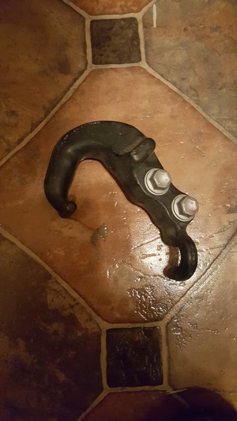

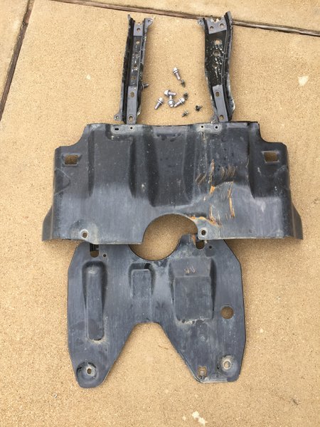

    The brackets that hold the original skid plate need to come off as well as the tow hook pictured below.20160908_172035.jpg 20160908_175348.jpg

    This is incorrect. I've done the install and you do not have to touch the tow hook.
