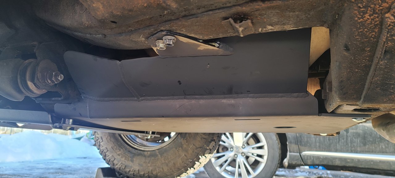

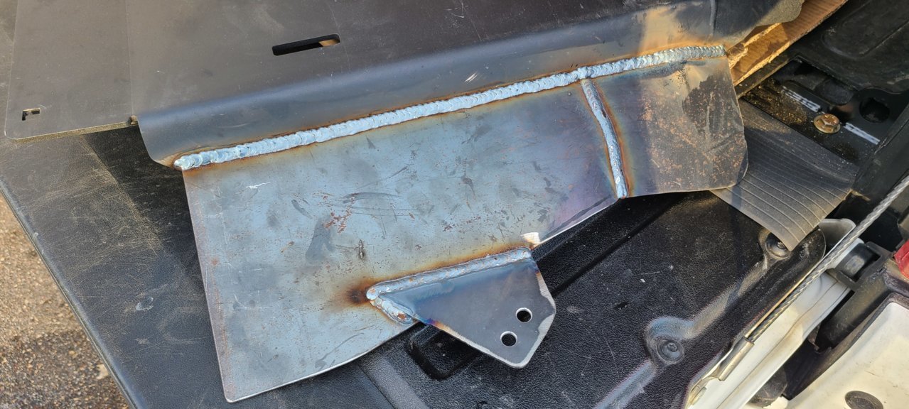

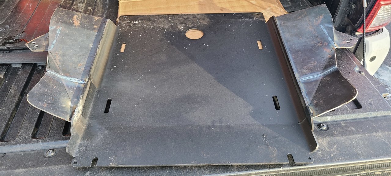

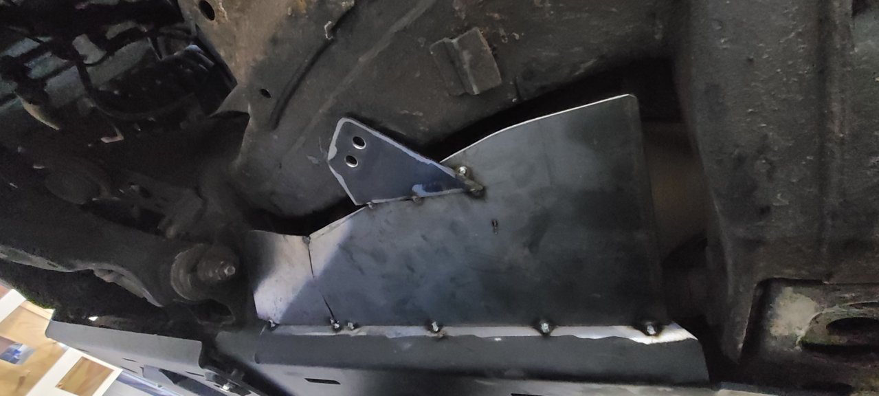

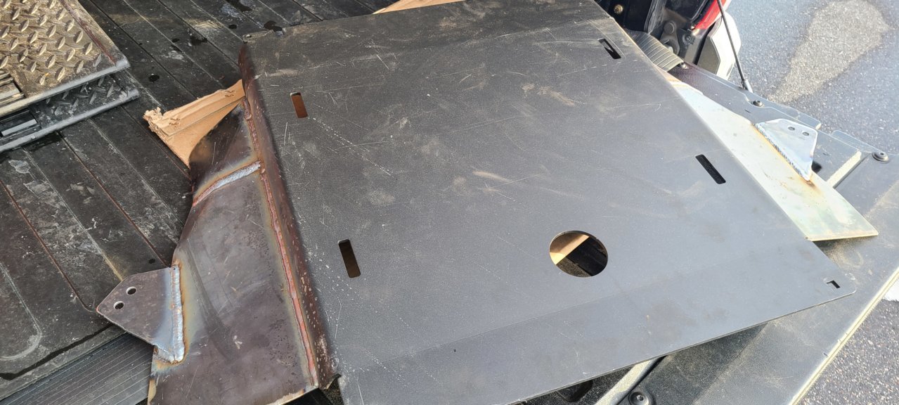

    I found a local welder to do the work from one of my Facebook groups. He did a pretty good job especially with the welds. Here some more photos after I brought it home to paint.

    YMH
    Black '17 OR
    That dude did a really good job of welding. Look at that penetration

    2021 Tacoma SR
    Yup, I was expecting to see some basic spot welds. That is some very detailed/meticulous work. Mind telling, how much did the welding run you?

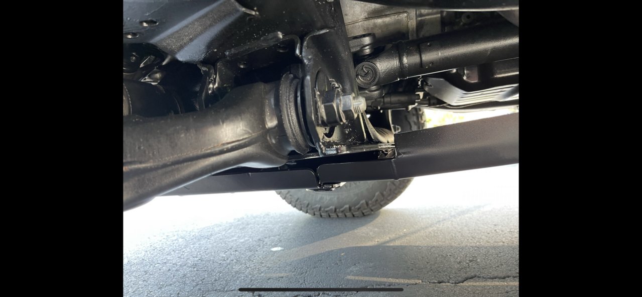

    Looks great! That’s some solid deterrent. No one will bother after seeing this.
    I do have to say tho, that your skid isn’t mounted properly. Those washers are suppose to be on top of both skids and not between them. This is my RCI set up. Skids should run completely flat

    Arm rest organizer, dash cam, popnlock, anytime backup cam
    Everything was fabricated by my welder. He had all materials too. He only asked for $100, but I gave him $110 because he went above and beyond what I was originally asking. There was another welder that wanted $200 so ymmv.
    Is that to aid in cooling the cats?
    You know I thought something didn't feel right when I was installing them. Thanks for pointing it out. I'll get fixed soon.
