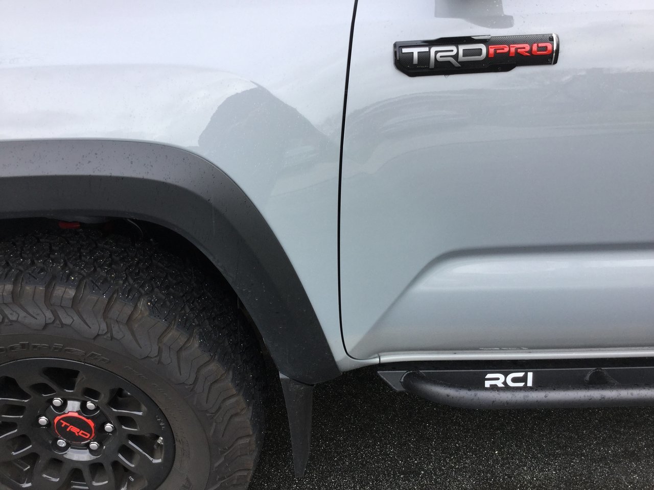

    Done!! Will upload some pics tomorrow. Not fun doing it alone but project complete. Put my softopper on before the sliders and now the frontrunner rack is next.

    360A57C0-E409-4D1E-9886-335745642E96.jpg 588906C8-C9DD-4C4F-A2EB-02BE726AFC77.jpg 5C193713-F69E-4640-95E4-163BB64D6BB7.jpg Just in case anyone was interested in the final product! Still have many mods to go..... thanks to all that chimed in with advice.

    Looks good Bro!
