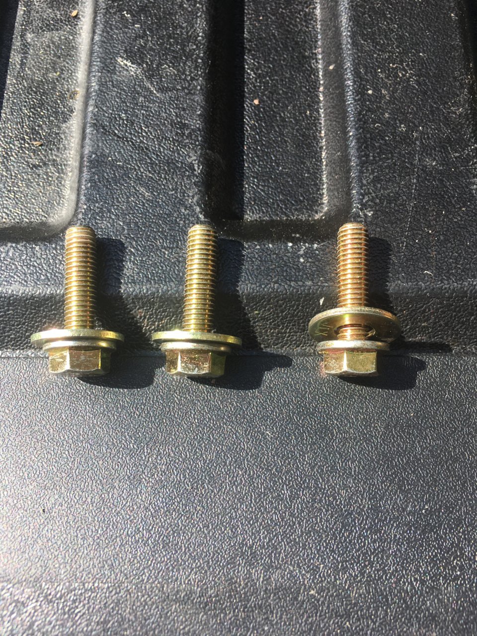

    I am wanting to take my rci sliders back off. Does anybody recall the OEM bolts that you have to remove to install the sliders? I am looking around my toolbox trying to find the ones I took off.

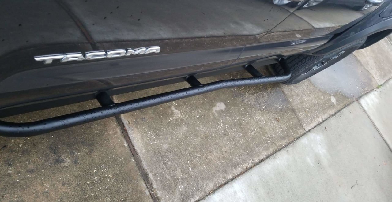

  10. Feb 25, 2019 at 2:06 PM
    #50
    pop.tremuloides
    pop.tremuloides Well-Known Member
    Dec 10, 2018
    #275450
    1,091
    Colorado
    2019 TRD OR DCSB
    DBACK HD, Armor, SP9100, lights...etc
    Probably the best pic ever for these!

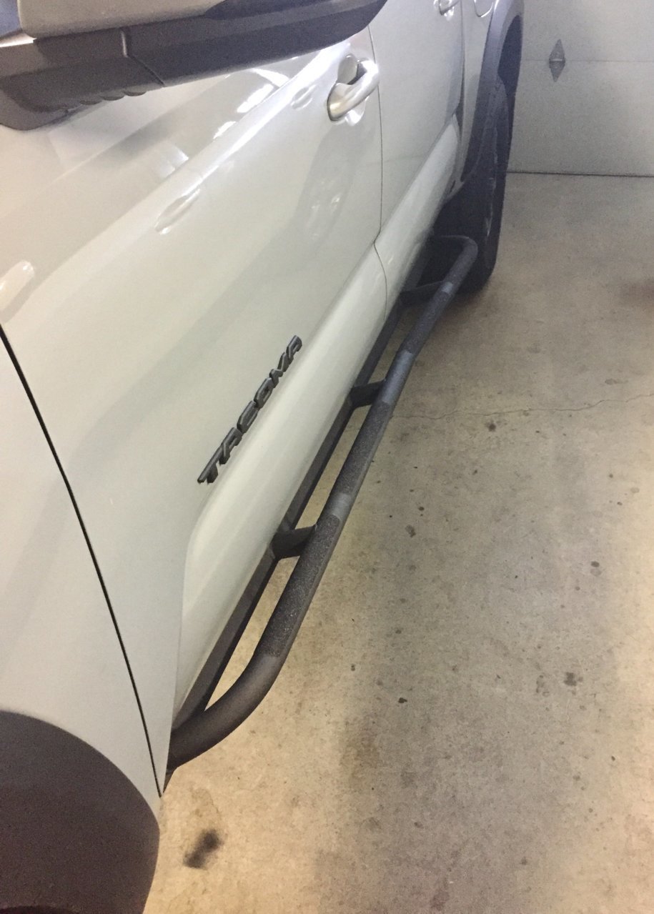

    Not a bad install. Having another set of hands makes thinks a ton easier as others have said. Everything lined up and was easy to install overall. Only had 3 beers so...

    I know this is an old post but just in case someone else ends up with these they were provided as longer bolts for the box that connects to the outside of the frame on the passengers side.
