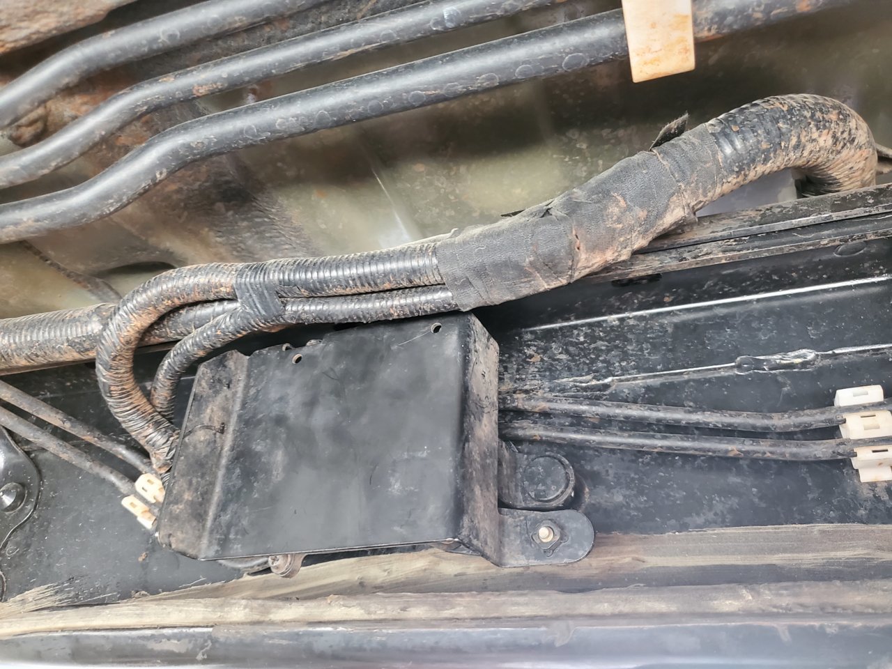

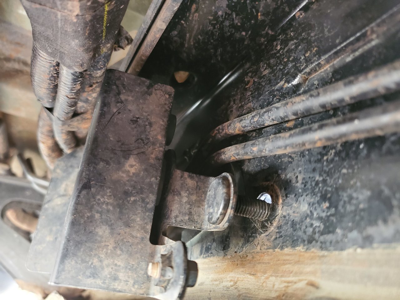

    Okay my turn. Installed these last night. The 2 bolts on this bracket that mount to the frame don't have holes! So I need to drill 3 holes? The 2 in the side of the frame for this bracket and the 1 in the bottom.
    On the driver side, there is some kind of module inside the frame rail that you remove to mount the slider. When reinstalling, the bolts are too short to mount because the slider mounting bolt sticks out too far.
    How'd you mount this bracket? And is anyone else having to drill the holes to mount that bracket?

    For future reference, I handled that module by cutting about a half inch off one of the RCI-provided bolts. I think what other people are doing is just flipping the bolt around (so it points out instead of in). Either way should give you just enough clearance to reattach the original bracket.
