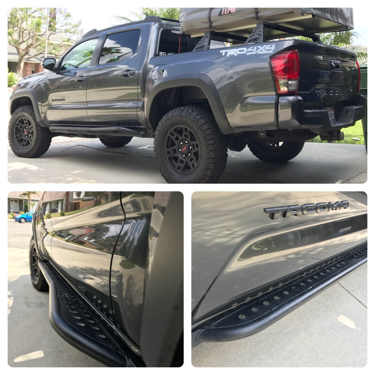

    Behind the relay you don't need extra washers, just put the bolt in through the inside of the frame.

    Look great, are these the 20 or 5 degree angle?

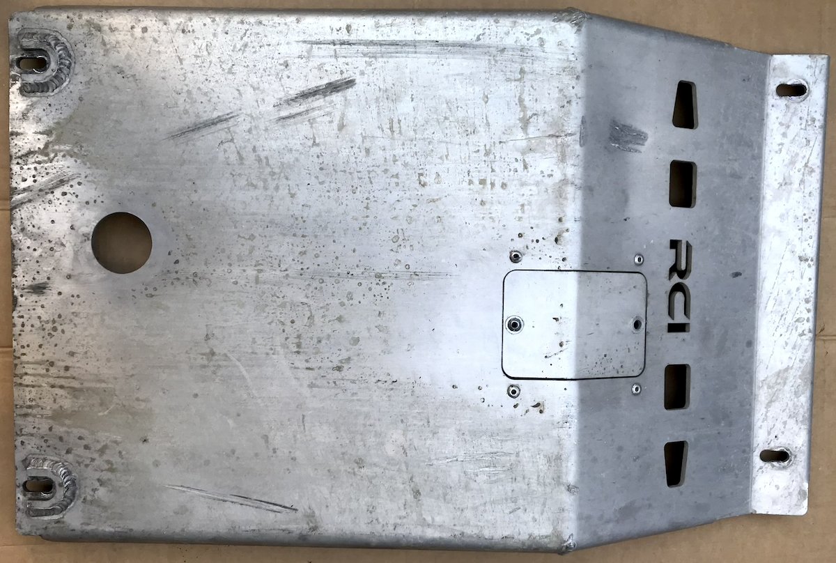

    You're running the same setup as me. Therefore I approve! I have the RCI front & mid aluminum skids, too. Not pictured because they're not pretty anymore!
    edit: oh now, here's when I took it off to drill out the over-torqued bolts for the oil port (thank you, free ToyotaCare oil changes).

    Not saying that they didn't over torque, but those bolts will seize in aluminium. Stainless has a bad habit of that.

    Are those the 20 or 5 degree?

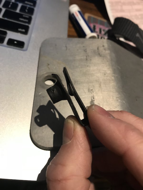

    They don't screw straight into the aluminum. There's a little stainless clip that sits on it and that's what's threaded for the bolt. Hard to explain but easy to understand if you saw a picture. I originally had the same thought.

    20.

    Actually, I'm massively lazy and haven't ordered the new bolts/hardware yet, so I still have it sitting in my garage. It looks like this:

    Gotcha. That's a good idea. I guess if you put them in with an impact like the dealer probably did, they will have issues.
