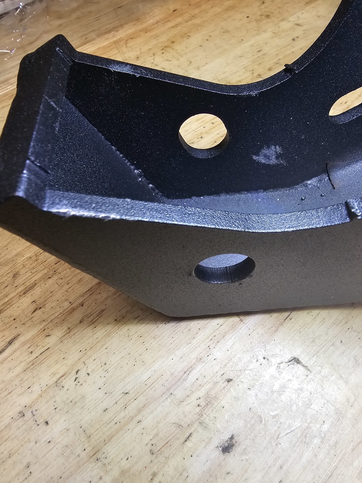

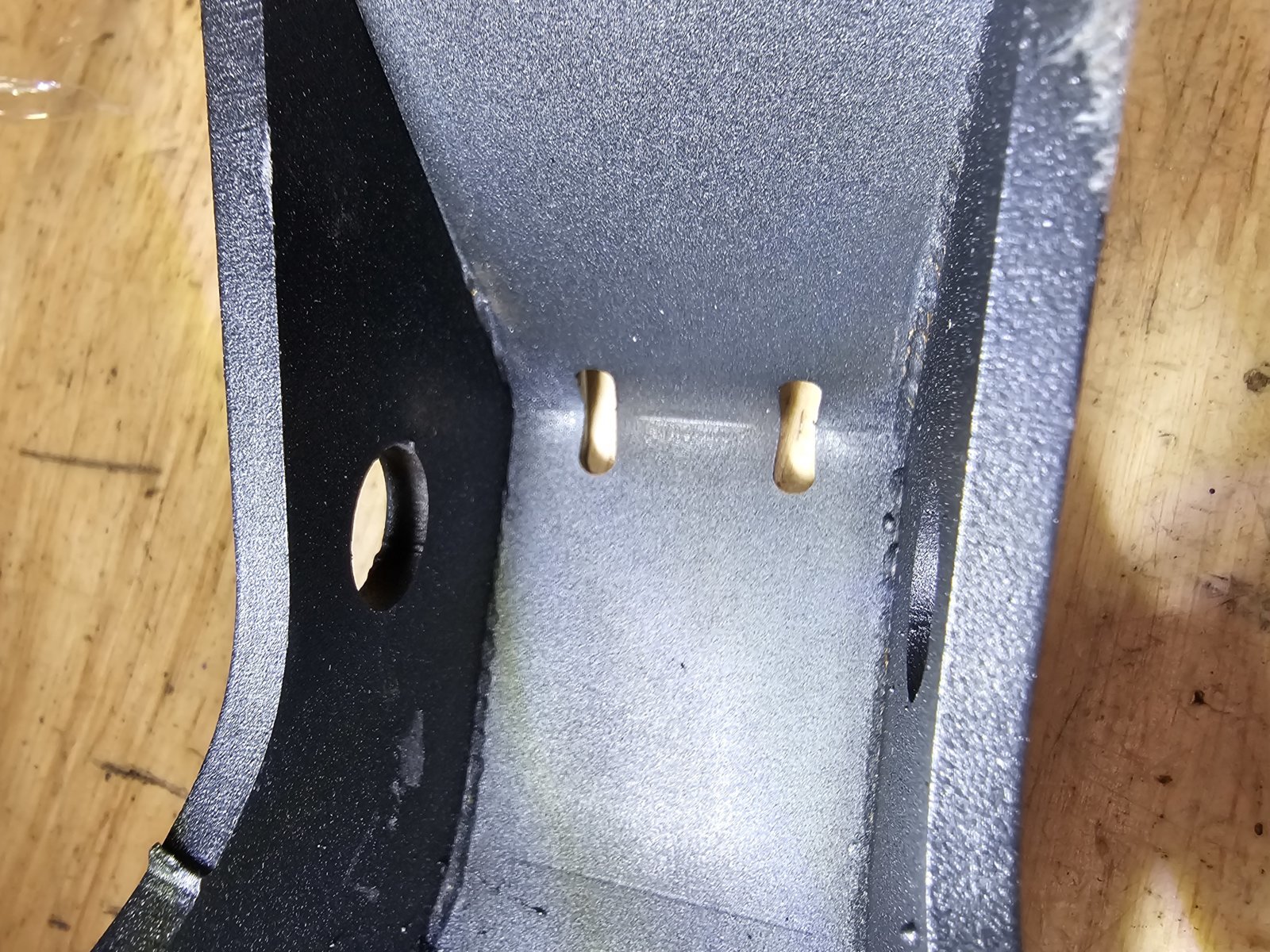

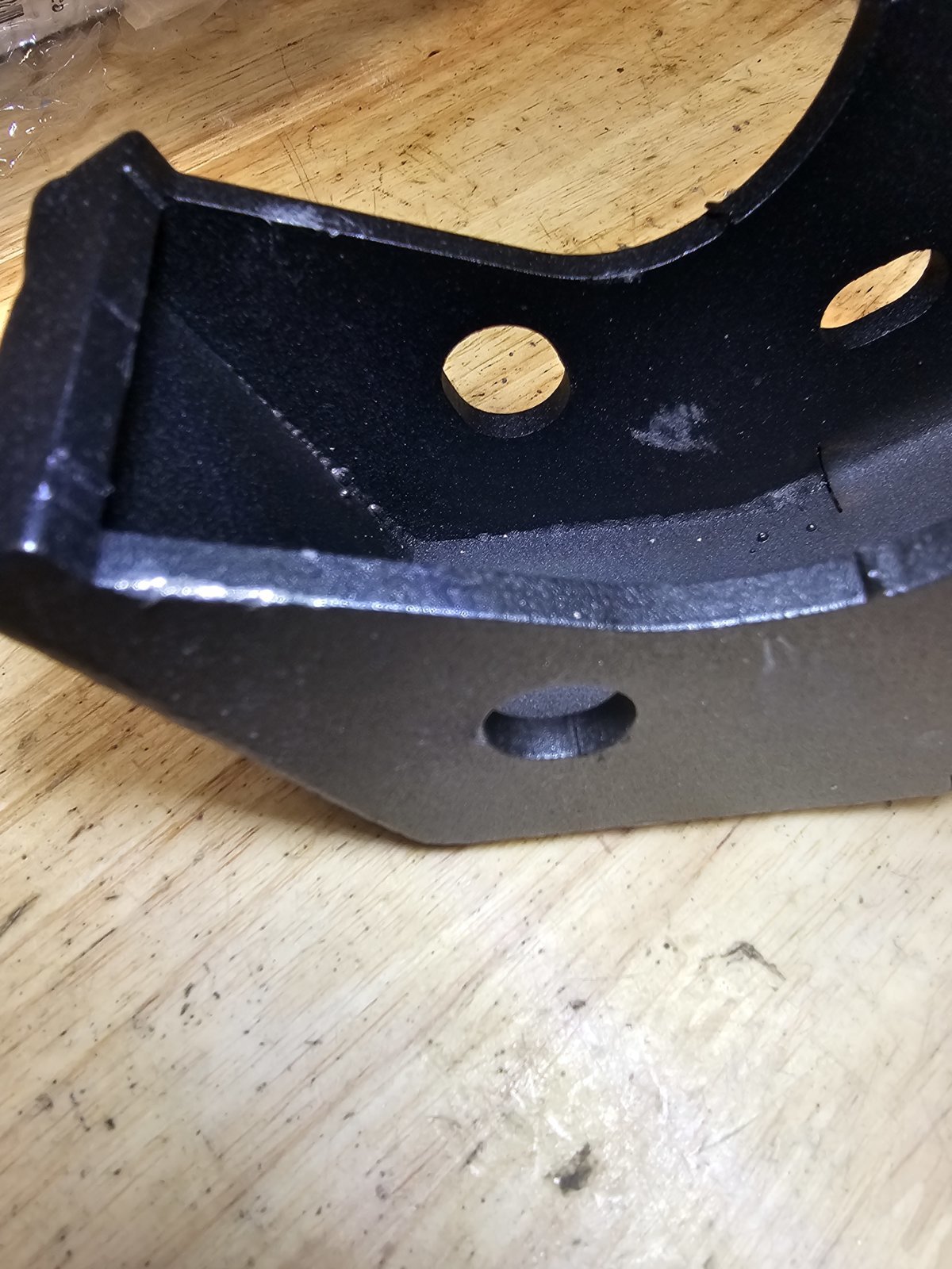

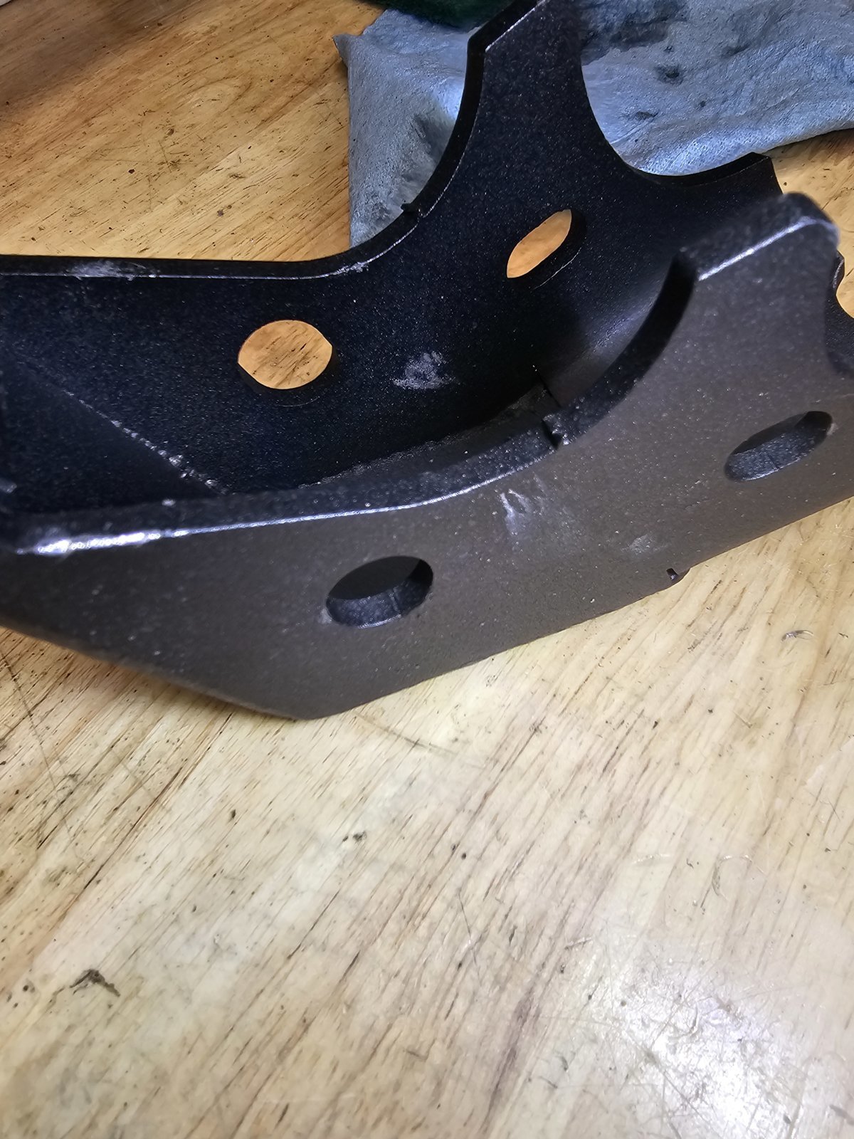

    My experiencea have been similar to yours,
    Their base products themselves are solid and well designed and their support is awesome, however their powder coating quality/strength, packing and their post weld QA and cleaning have left a lot to be desired.
    I've started requesting that they send me anything I've ordered as bare metal as ive had a significant issue with pretty much every item I've ordered from them in some way involving or being complicated by their PowderCoating, which so far has come to me pre-chipped on almost every order as well as seems very thin/poor quality in general, many time with corners having so thin of material they come pre-rusted. (Here's a photo of the shock skids I received today, which had.
    - rust In the corners due to sparse coat.
    - chipped corners due to the pair clanking against one a other during shipping
    - welding splatter that was powder coated over, some I could easily knock loose with my finger whereas others came free easily with a tap from a flat blade screwdriver, exposing raw metal.
    Id rather just get the bare items, do any touch up and then coat them myself that way I know for sure I'm not going to have to take them off and deal with substantial rust on them as water has somehow worked it's way under the PC or the PC rubbed off from daily, non off-road driving.

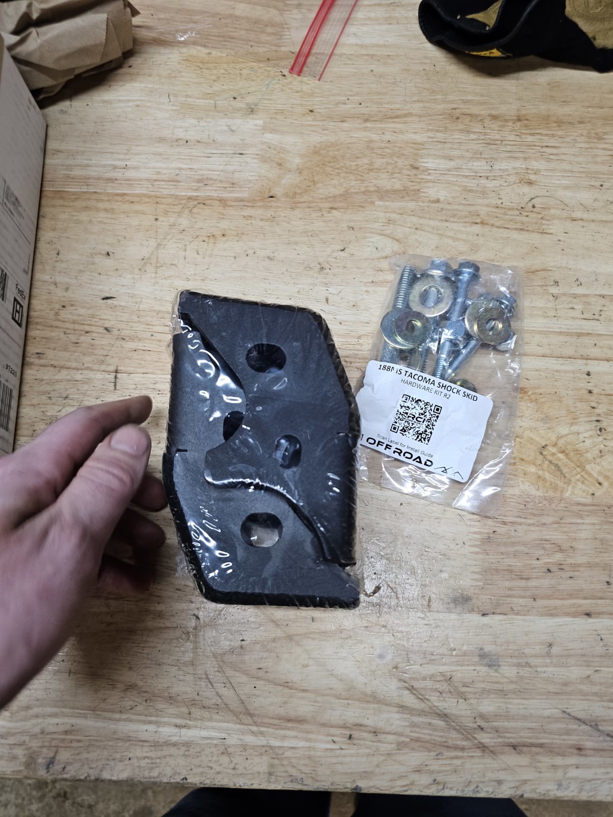

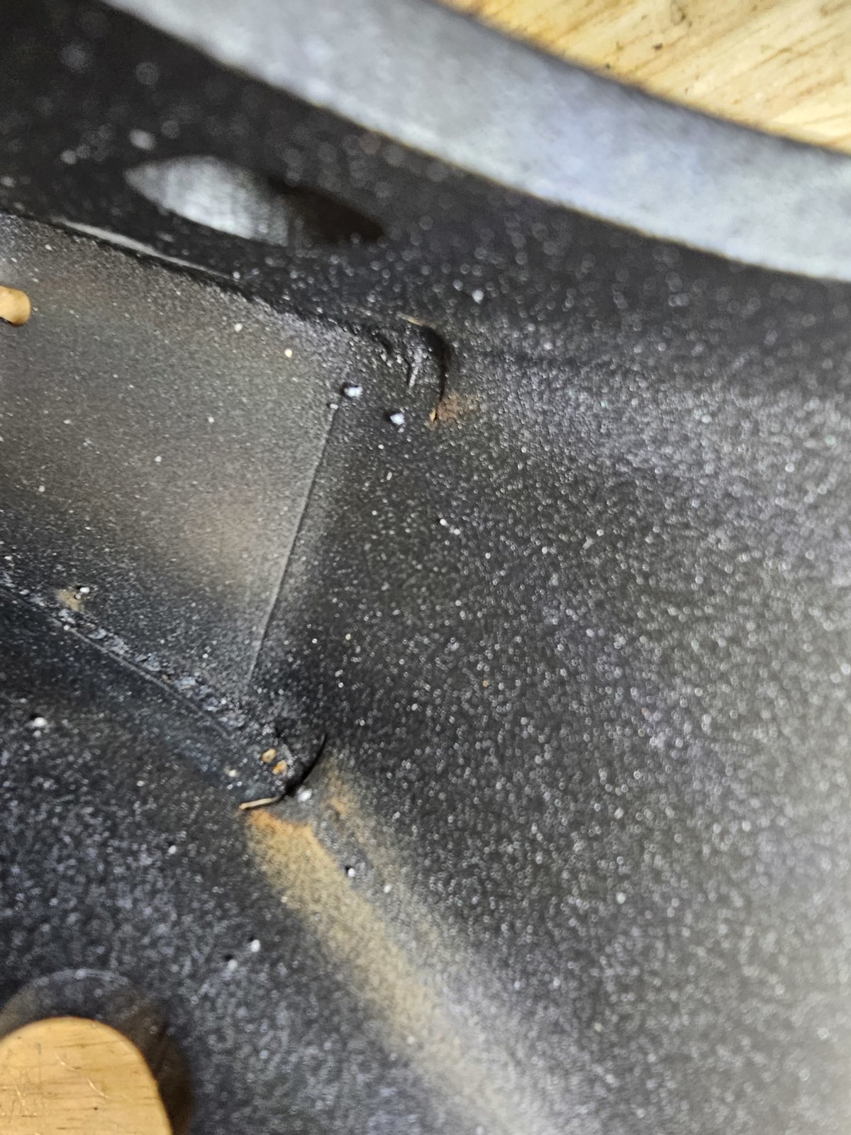

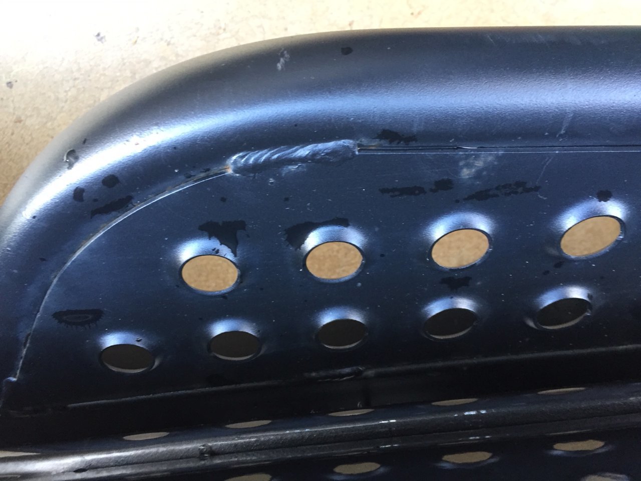

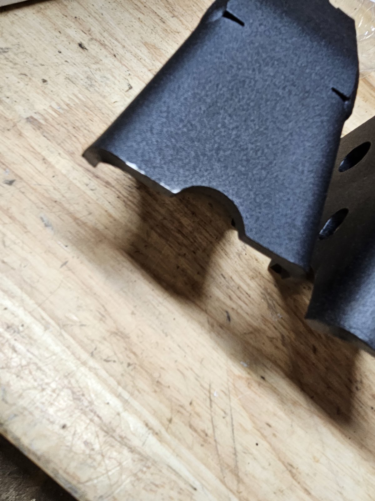

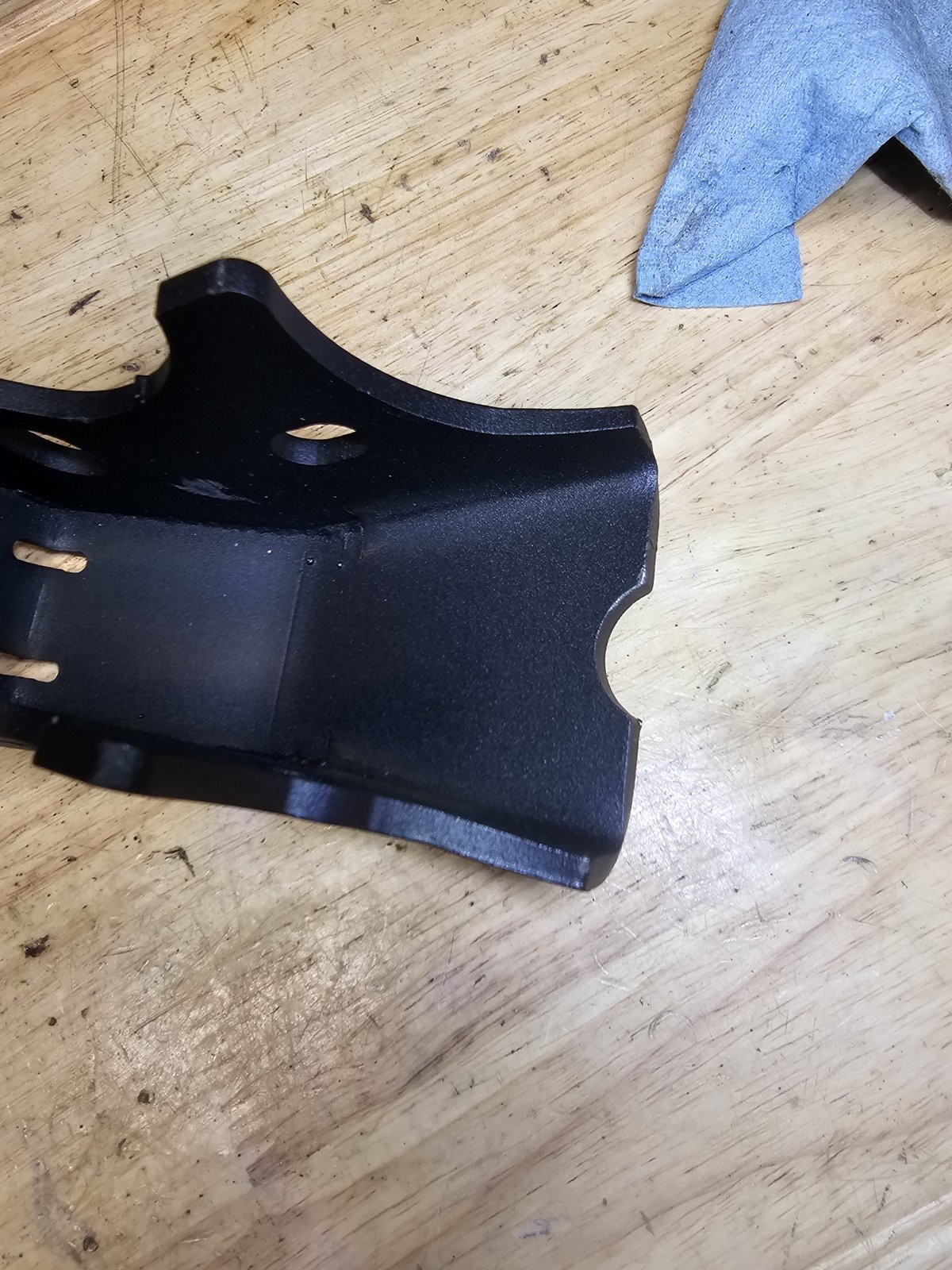

    They were wrapped together like this and placed inside a cardboard box, which compounded the issues with the powder coating's durability as they just clacked against one another during shipment causing the PC to chip at pretty any point the two skids touch one another.
    Ive been pretty unhappy having to touch up every item I've received from them prior to installation and then having to worry about the long term durability of the powder coating as it's not even surviving the journey to me before chipping or things like bumping it with a hand wrench or dropping a couple of inches onto dried dirt have caused it to chip, the fact it seems so brittle and i keep having to touch it up before I've even taken it off road, makes me worry about potential long term maintenance and labor ill have to put into them due to possibilities such as rust forming under the surface or just failing and peeling off in general which ive seen a few mention in this thread with their RCI PC.
    Id rather just prime and paint them myself that way I know for certain it's done right and will stand up several years only needing to be touched up when they've been scraped against something.
    I find myself going back to them as Id rather stick with one vendor for my armor, the underlying products are well designed and their customer service is 5*.

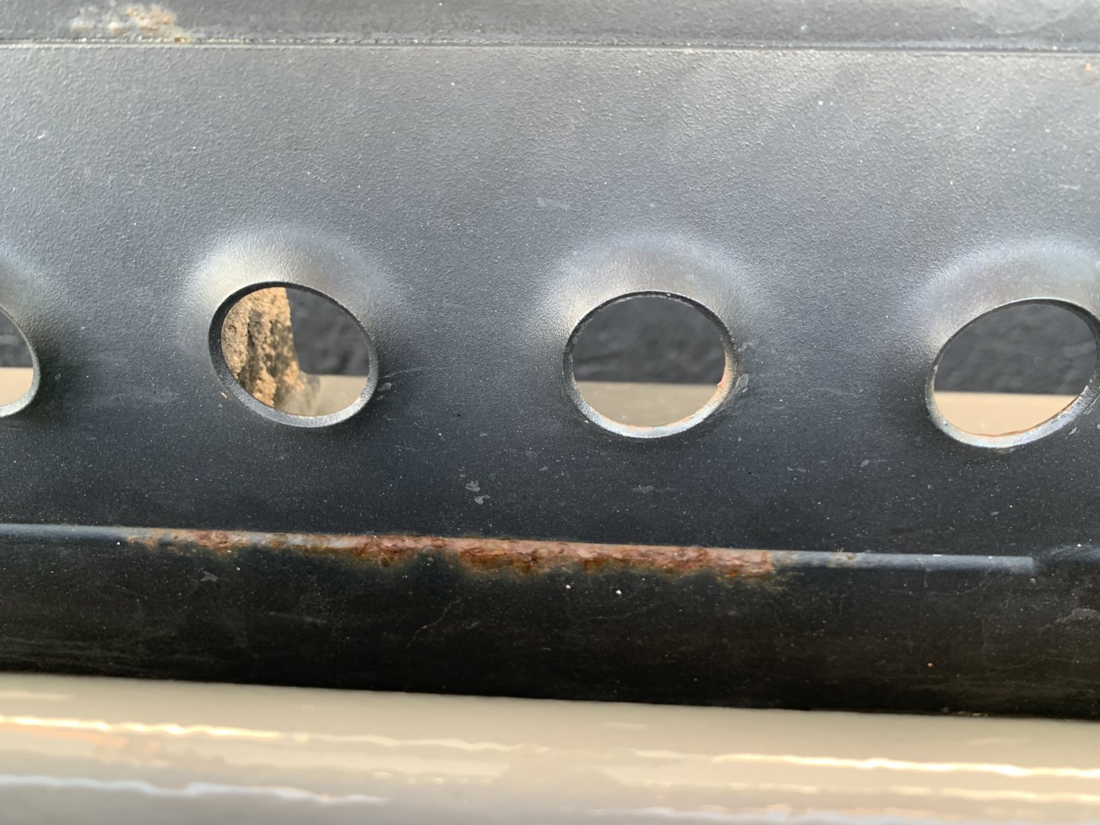

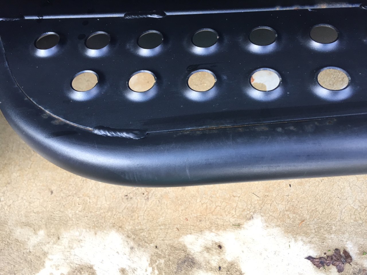

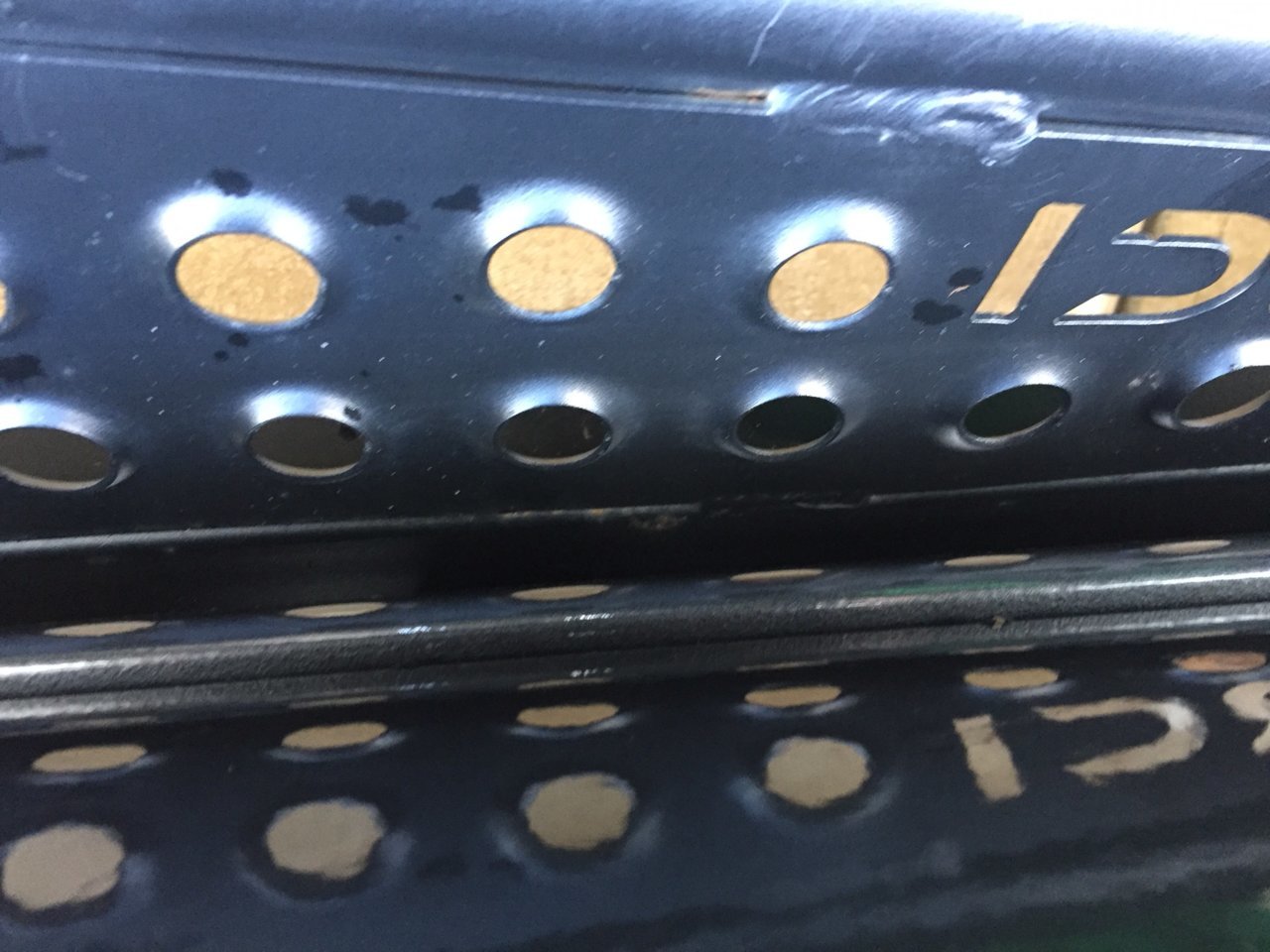

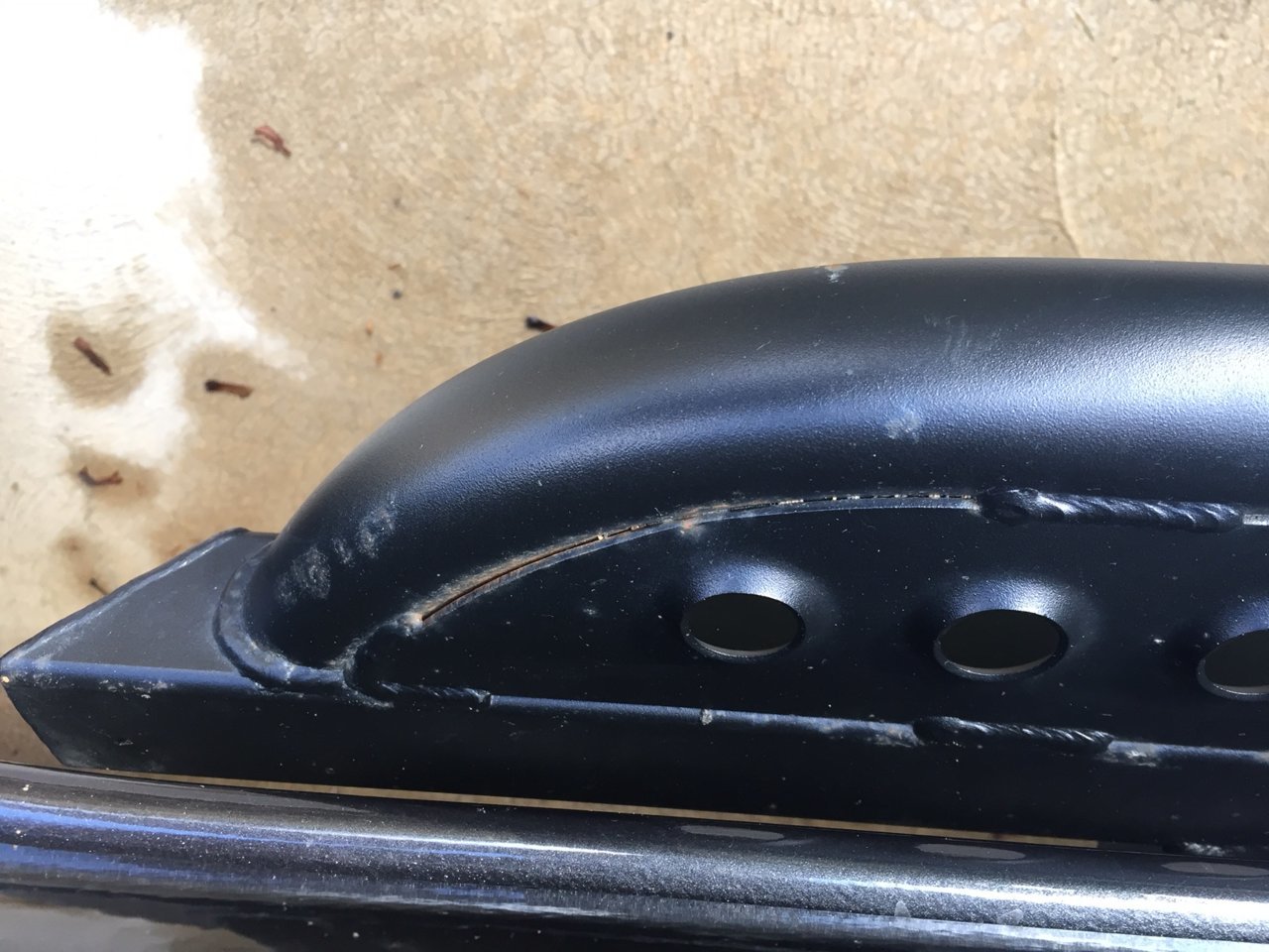

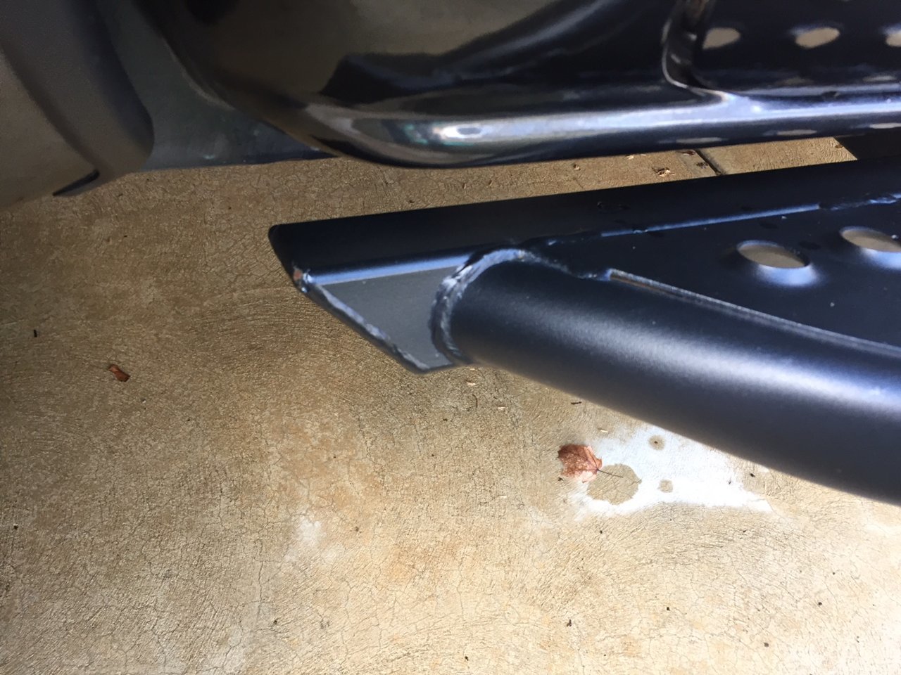

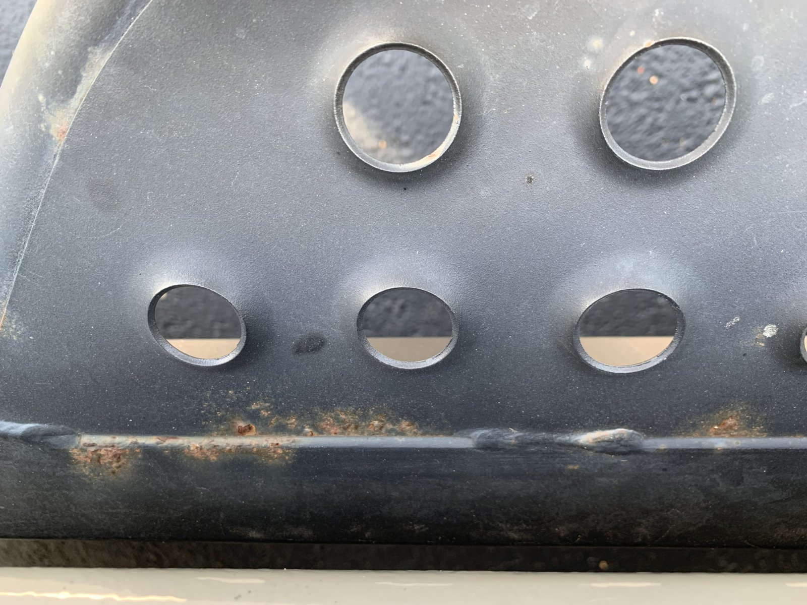

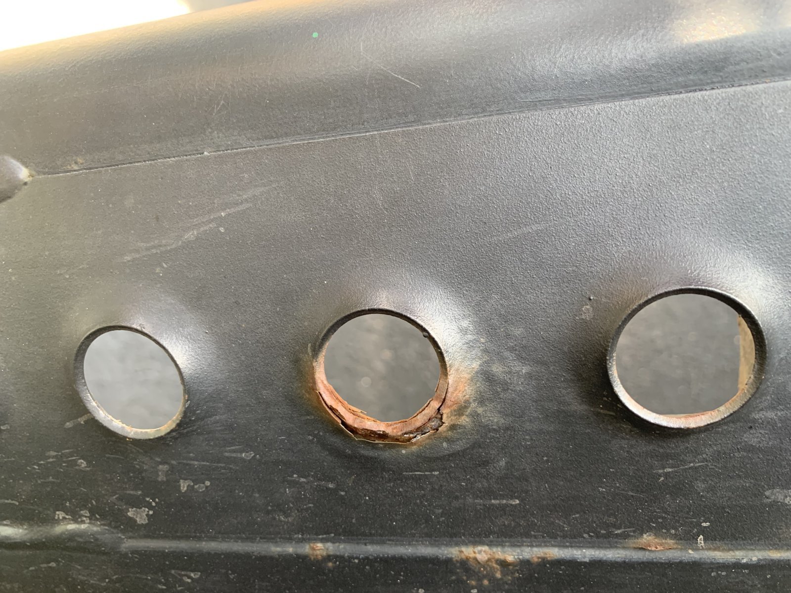

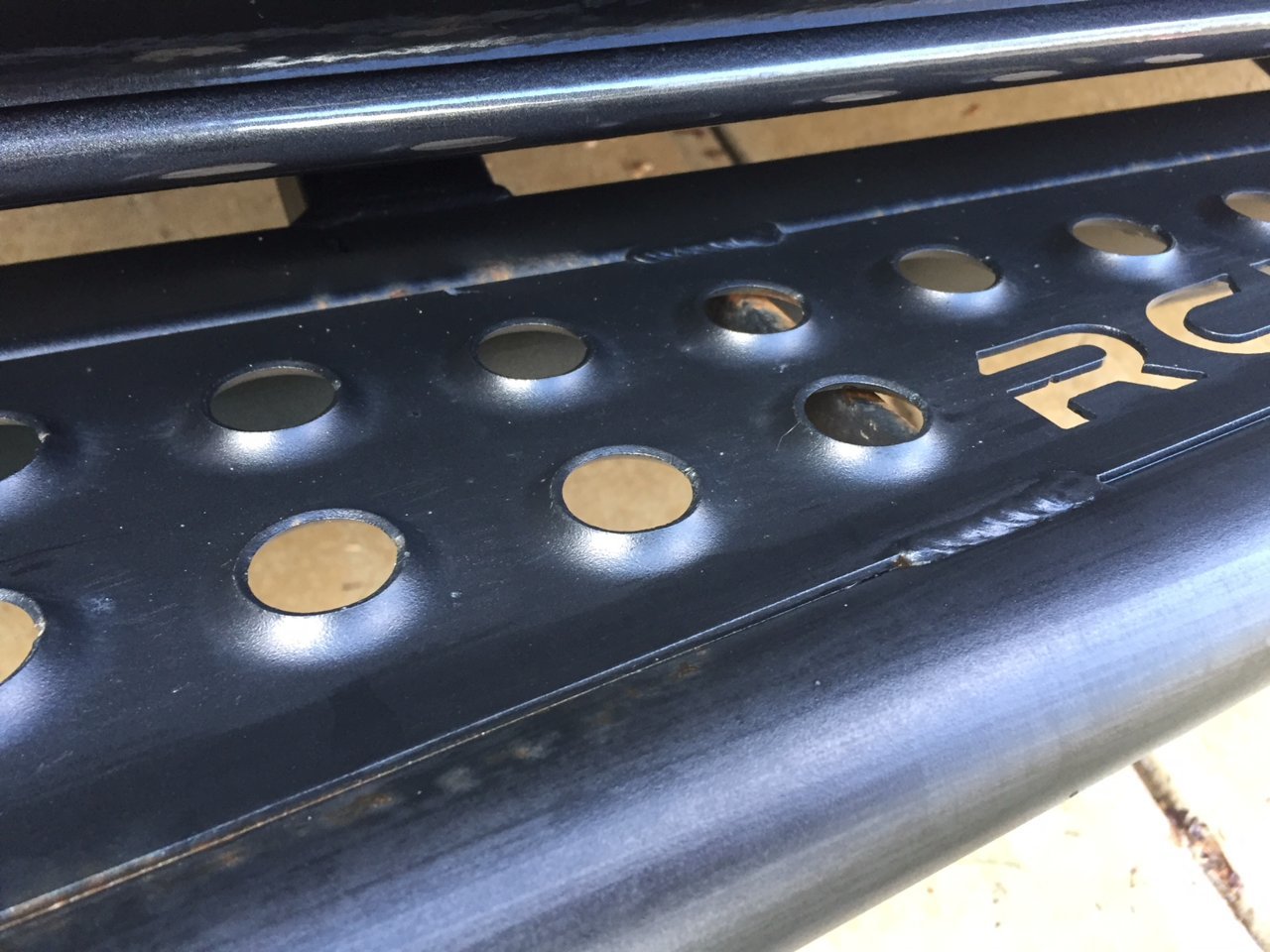

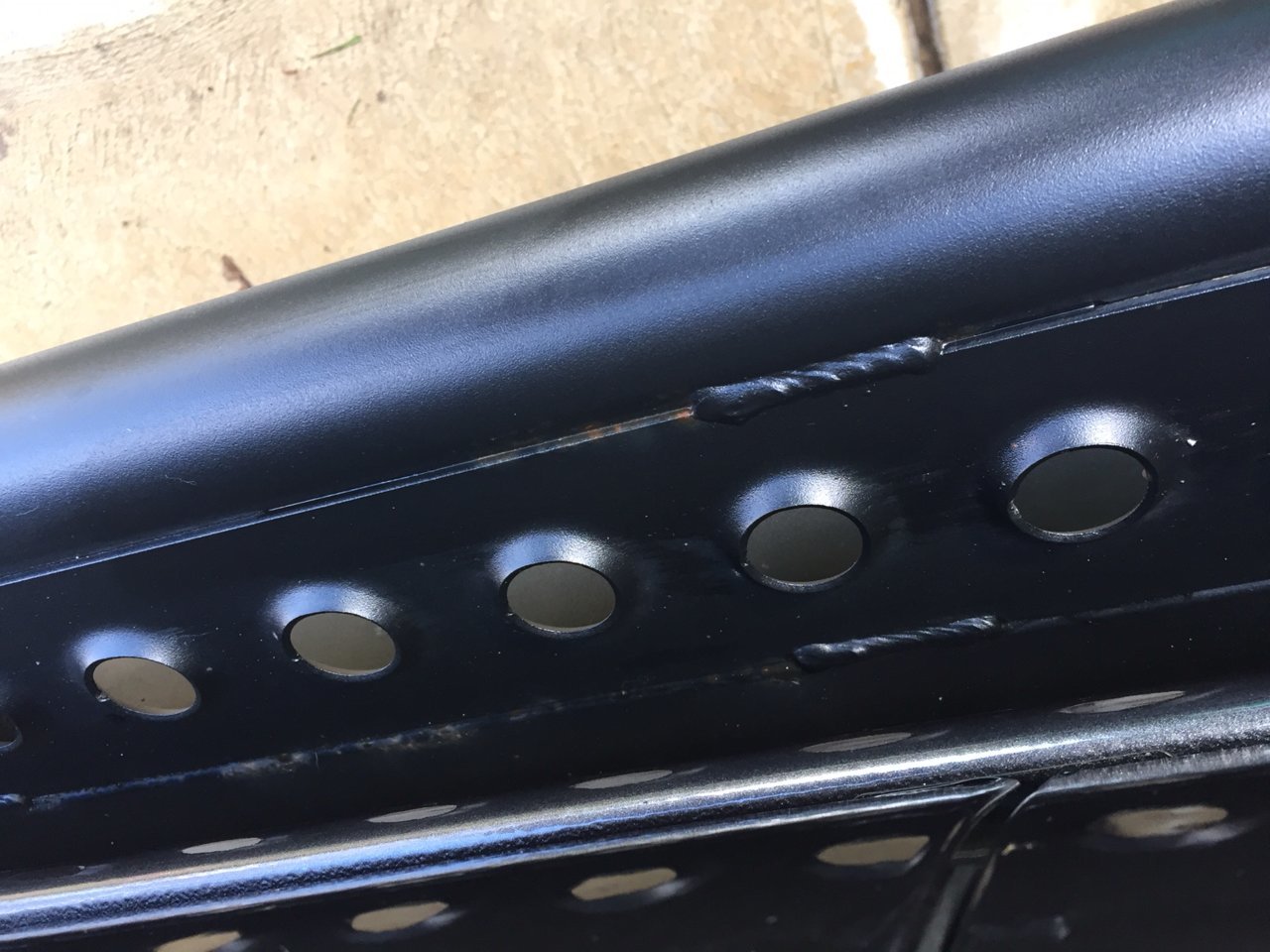

    IMG_8036.jpg IMG_8035.jpg IMG_8034.jpg I’m on my second set of sliders from RCI. The powder coat on the first set began to flake off on day 1 and the rust followed immediately. RCI requested that set back and shipped me a new set. While the new set was better they too began to rust very quickly. Pics below are of the second set. And I live in Central FL, no road salt down here.
    From RCIs website:
    • Available with our heavy duty black textured powder coat finish, plus we take it a step further and coat all rock sliders with an epoxy primer for an exponentially more durable finish than competitors. We now powder coat in-house allowing us to provide better quality, and shorter lead times for the same cost!
  9. Jun 9, 2024 at 12:40 PM

    I would just get that thing media blasted, treat the rust, sand and then rattle can it or have it powder coated locally. Their powder coating has been consistently weak on every single item of theirs I've had, often coming rusted in spots out of the box.
    I would also suggest enlarging the hole in the end of the sliders, treating it with some Eastwood internal frame spray, plugging it and then adding an additional drain spot on the bottom. I'll be doing this myself as soon as the sliders start to show signs of rust under the surface, which I expect they will based on my experiences and this thread.
    I wouldn't bother trying to get a replacement set as they'll probably just do the same thing based on everything here.
    Their powder coating has made my experience with their otherwise solid products sub par.
