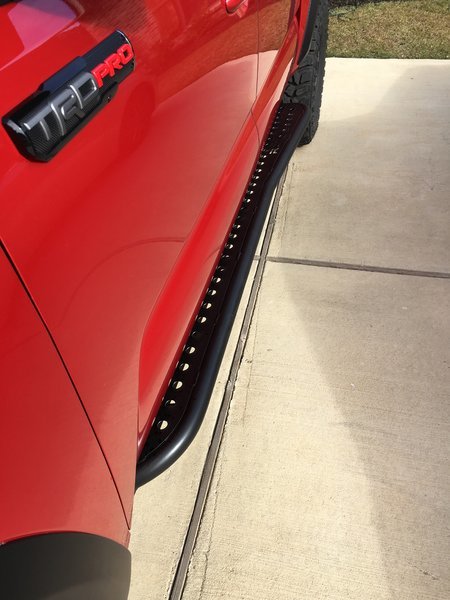

    Anyone have em? like em? pics? Debating ordering them from Toytec

  3. Jul 17, 2016 at 4:21 PM
    OkTacoTRD
    OkTacoTRD Well-Known Member
    Mar 29, 2016
    #182732
    182
    Jerry
    2016 Black Tacoma TRD Off Road

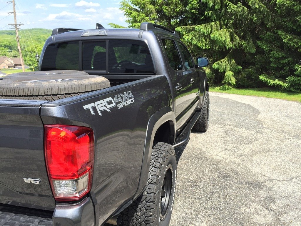

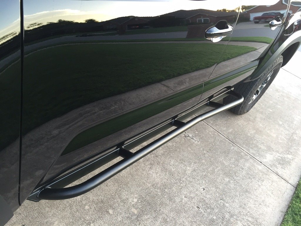

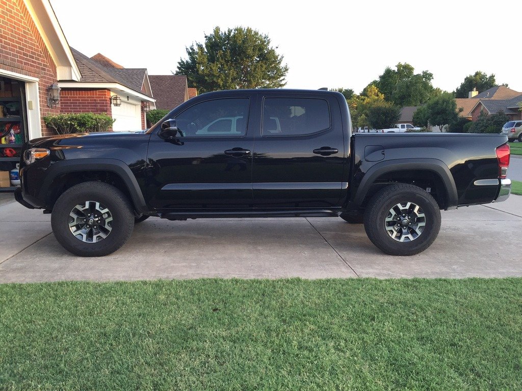

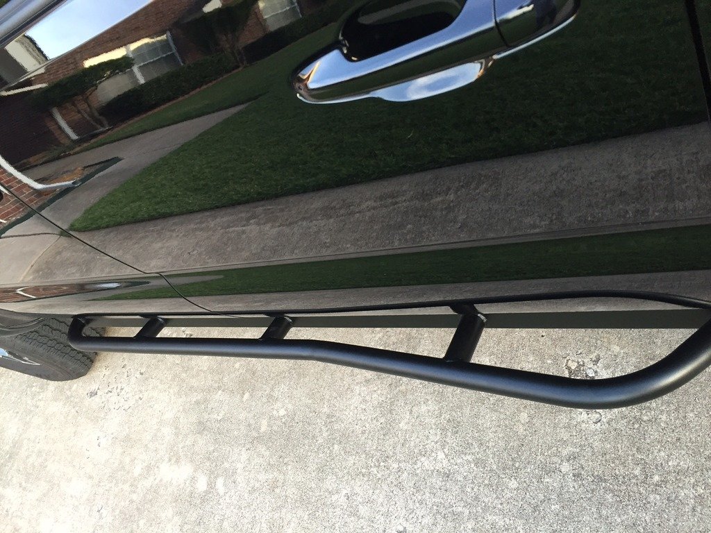

    Just installed my RCI sliders last weekend. I do like them. My only significant complaint was my kit was missing two bolts that replace existing bolts that are in the bottom of the frame. Ended up stripping out the nut welded to the frame. Had to tap it out and go buy a new bolt, actually two new bolts. Other than that, it was pretty straight forward. Allow a couple of hours to complete though. It certainly helps to have someone help you.
    DubfromGA, Dirtbag51 and Foggy Noggin like this.
  4. Jul 17, 2016 at 4:22 PM
    Riding Dirty
    Riding Dirty Sinner; saved by grace
    May 27, 2016
    #188065
    2,391
    Before: '16 TRD OR 4x4 AC QS//After: 17 T4R Pro 040
    PlastiDip
    Those are sweet!!

    Thank man! those look really clean. That has the optional kickout. Everything bolt up ok other than not having the proper bolts included?

    They did. There are a couple of boxes attached to the frame that you have to unbolt to bolt on the sliders, but then they go right back on with longer bolts that are included with the sliders. There are only 3 of them. The break lines are in the way a little bit but you can make it work easy enough. I put one of the bolts in the opposite of the others so it wouldn't hit the break lines. You would have these issues with any bolt on sliders I would imagine.

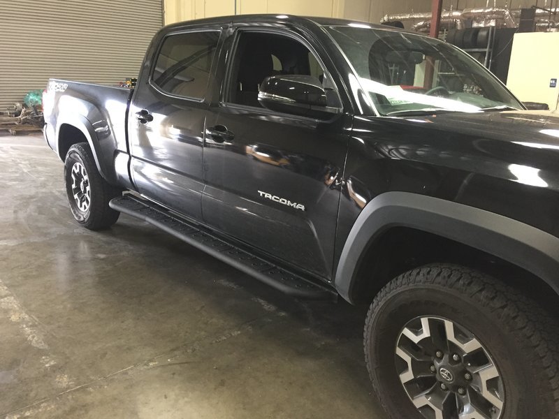

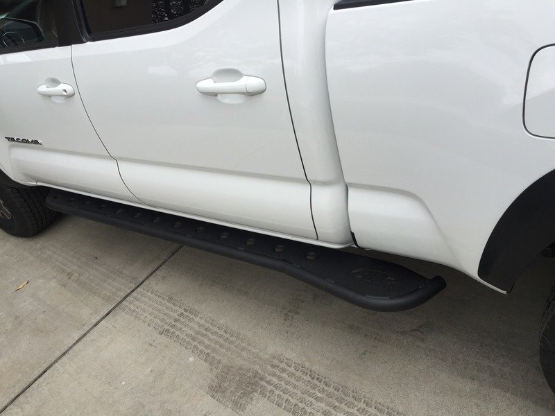

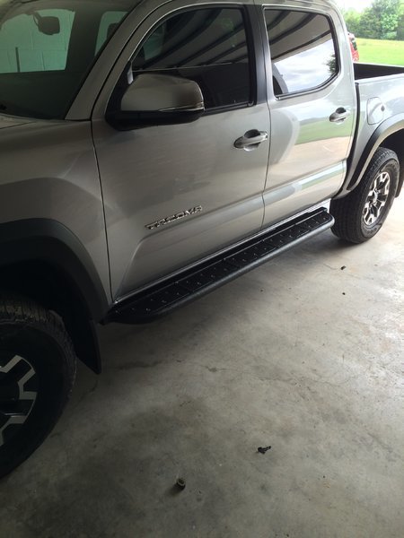

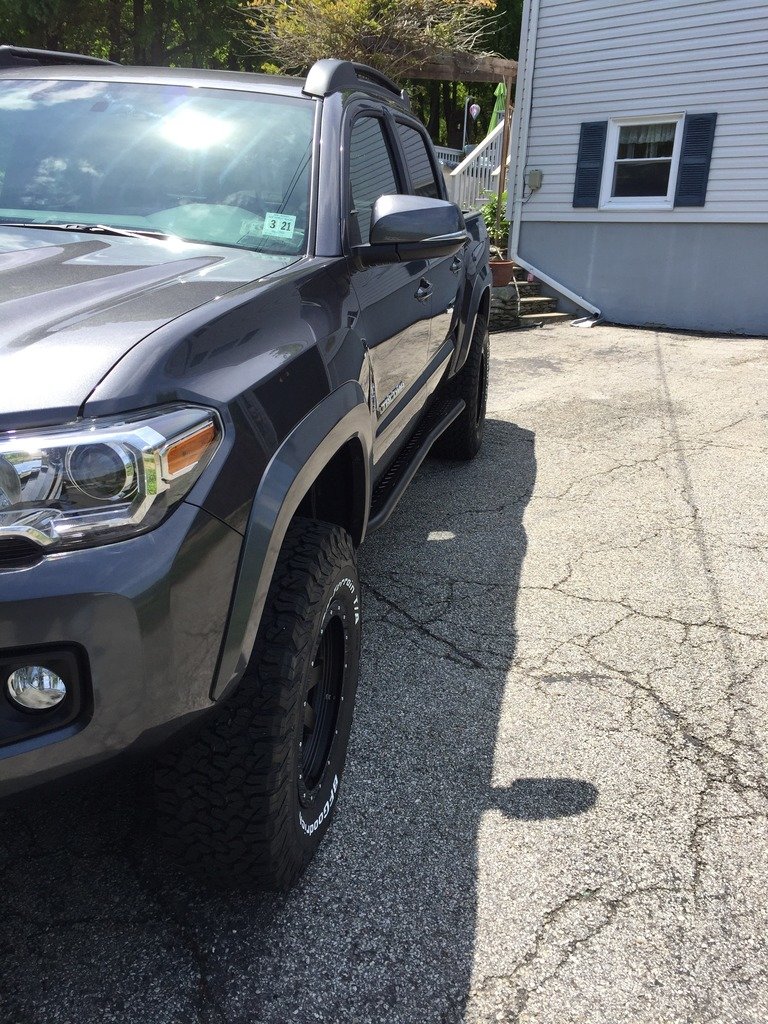

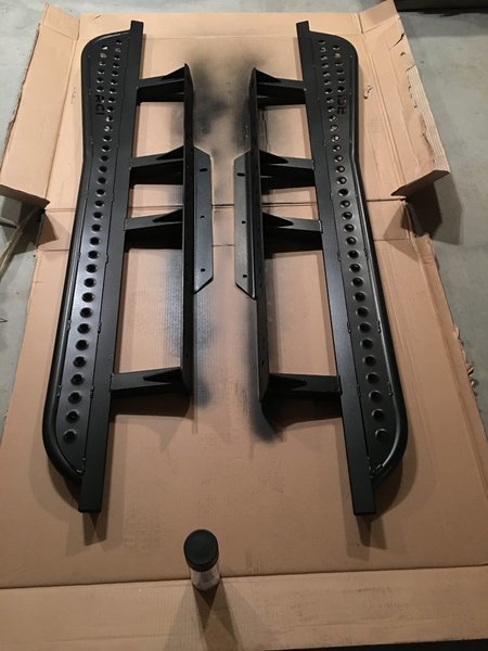

    I really like them, pictures don't really do them justice
    7CADC327-114A-405A-A4F2-D47D8EC512FF_zps_f859da695b04b793bc67108026c65f87e6a87507.jpg
    3B98D411-D225-45DB-AB9F-20CDC88338BA_zps_01c01b4ca794d9f184f1fad9f452217b1c7ef8b6.jpg

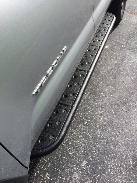

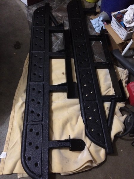

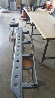

    apex_2b911959db7fd4dfc6e1ddc146600c551f15af55.jpgApex Sliders arrived on time. It's been really humid and rainy the last 5 days so I took the wire wheel to them today got rid of the light rust coating and got a coat of primer on them. I'll spray them with the bed liner tomorrow and let them sit another couple days before attempting to put them on.

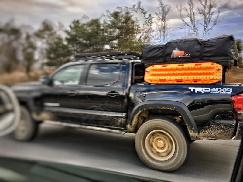

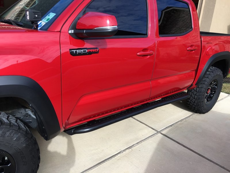

    No complaints here.

    Are those the 20⁰ version or 0⁰?
