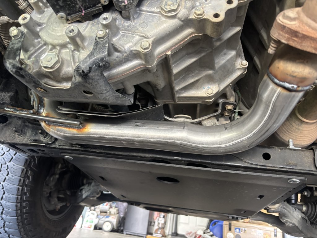

    I just installed my transfer case skid from RCI, Aluminum with standard exhaust. When I reverse the exhaust sound like it’s vibrating against it. Has anyone had this problem? Seems like a crap fitment. I also have the RCI trans skid. ‘23 Pro 6MT

    May need to shim it…

    I had to put some washers in between the skid plate and crossmember after having the exhaust relocation done, mine did the same thing while in reverse. Pic is before adding the washers.

    Yeah. Just irritates me you try and buy a higher quality product to have to modify it.
    Looks about the exact same. So you went with the relocation after a while?

    no I bought the skid then did the relocate
