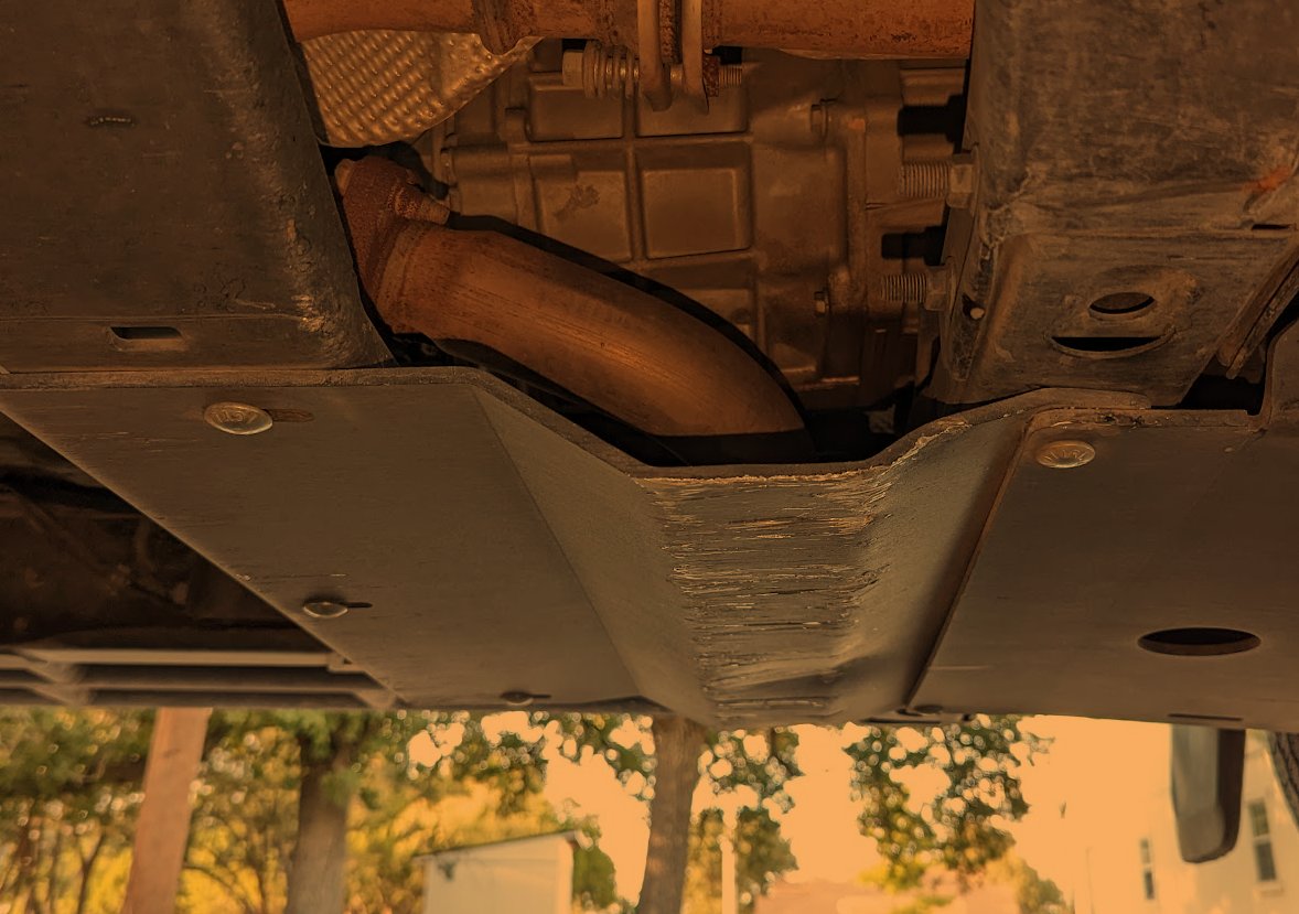

    I'm trying to keep as much payload as possible, hence aluminum skid plates.
    Skid Plates (80#), Rock Sliders (132#), and RSI Cap (240#) all subtract from my 945-pound payload (DCLB). Camping with my 180# son leaves 300 pounds for gear.
    Fourteen gallons of water, 112 pounds. Camping gear (100 pounds). Just about maxed out.
    I'm looking at 6000-pound travel trailers (600 to 900-pound tongue weight means Tundra time).
    The engine plate took huge damage from a pancake rock that had flipped up. Replaced it with steel.
    My rear aluminum RCI after two years.

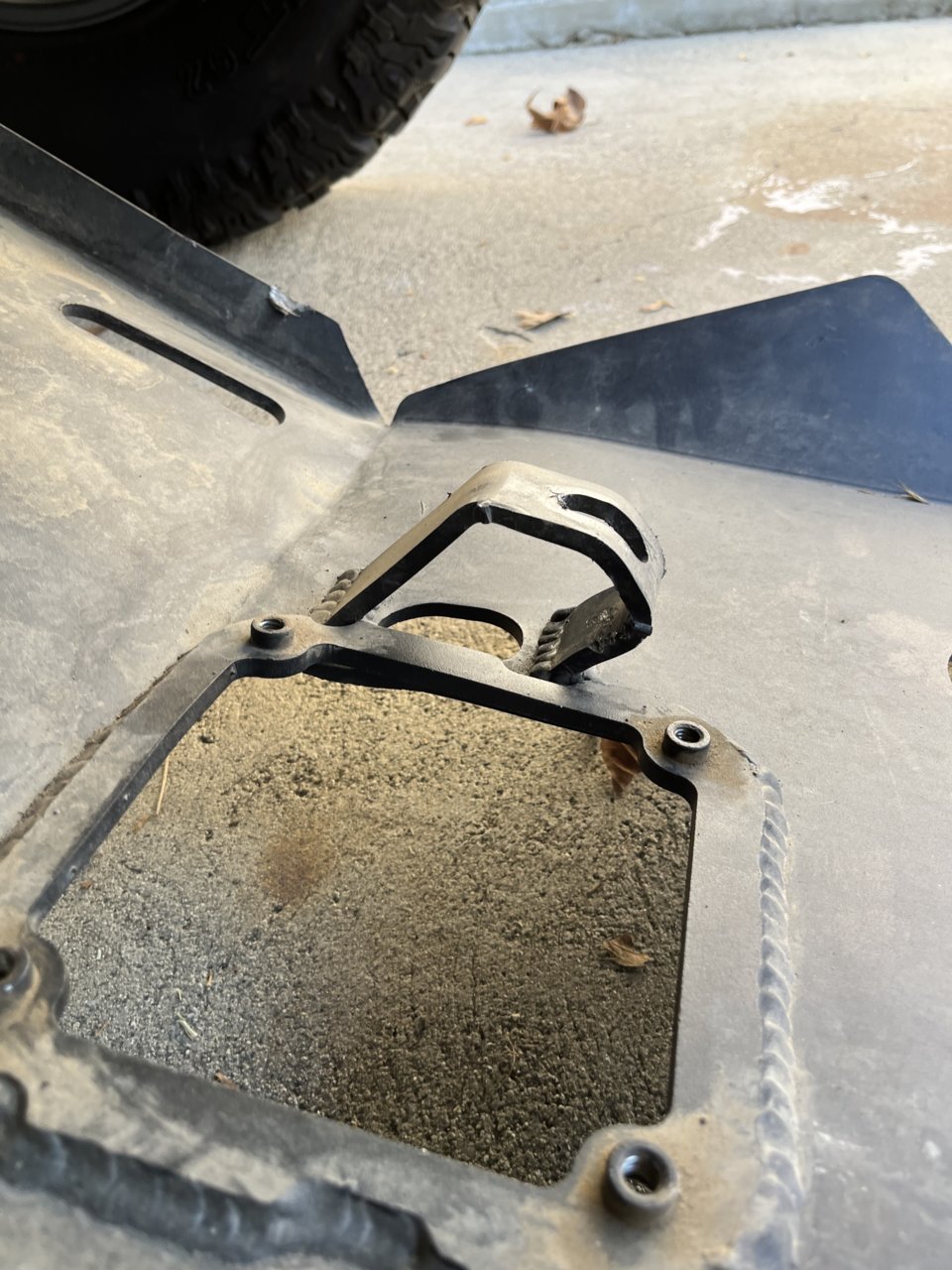

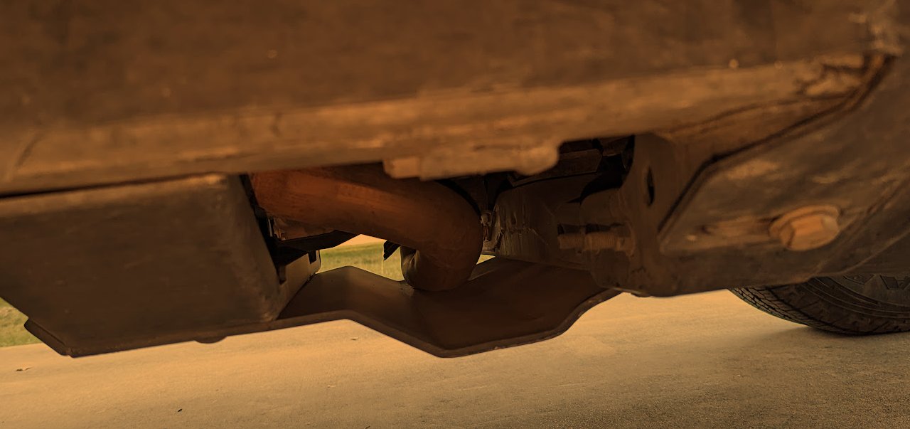

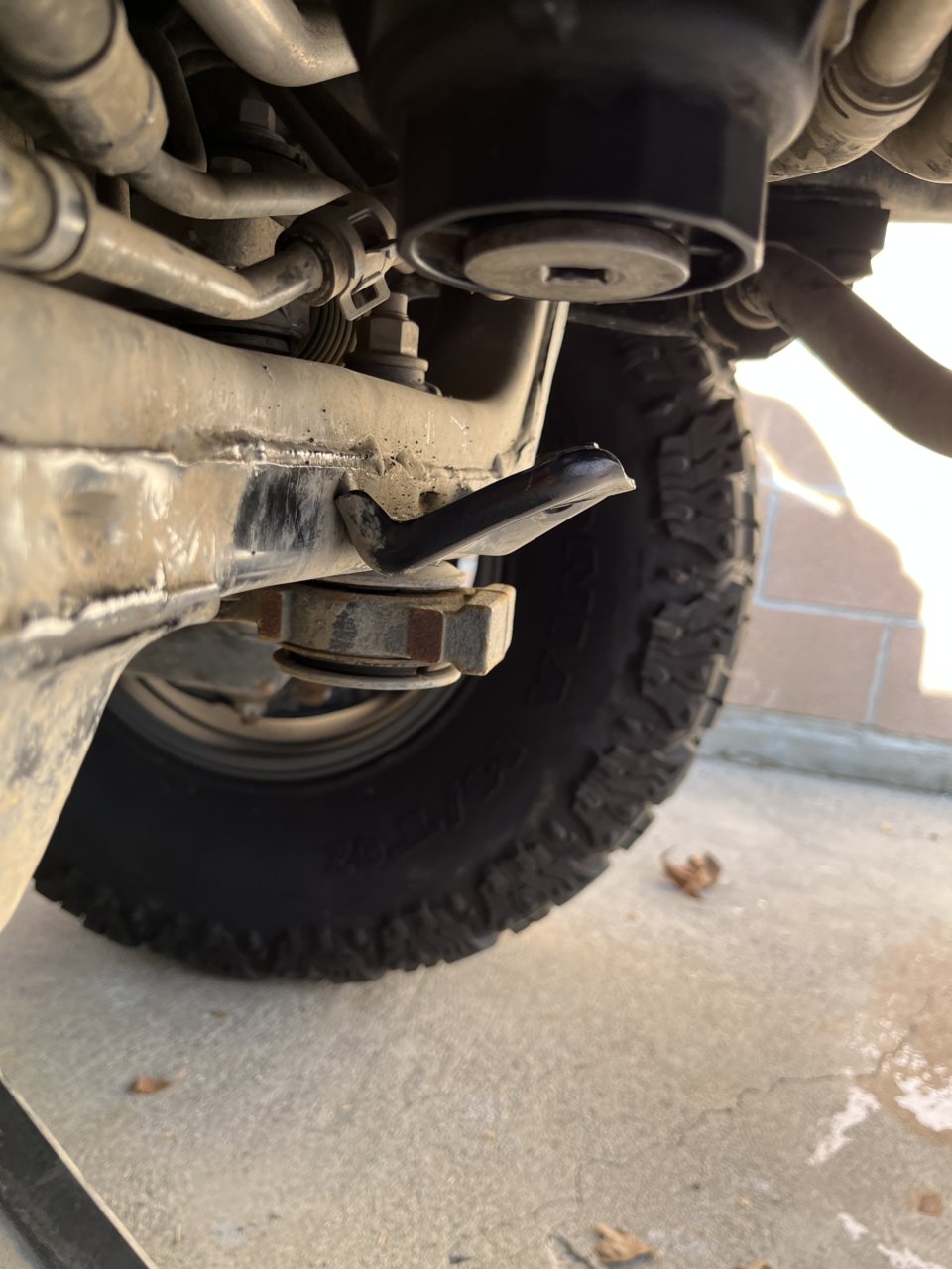

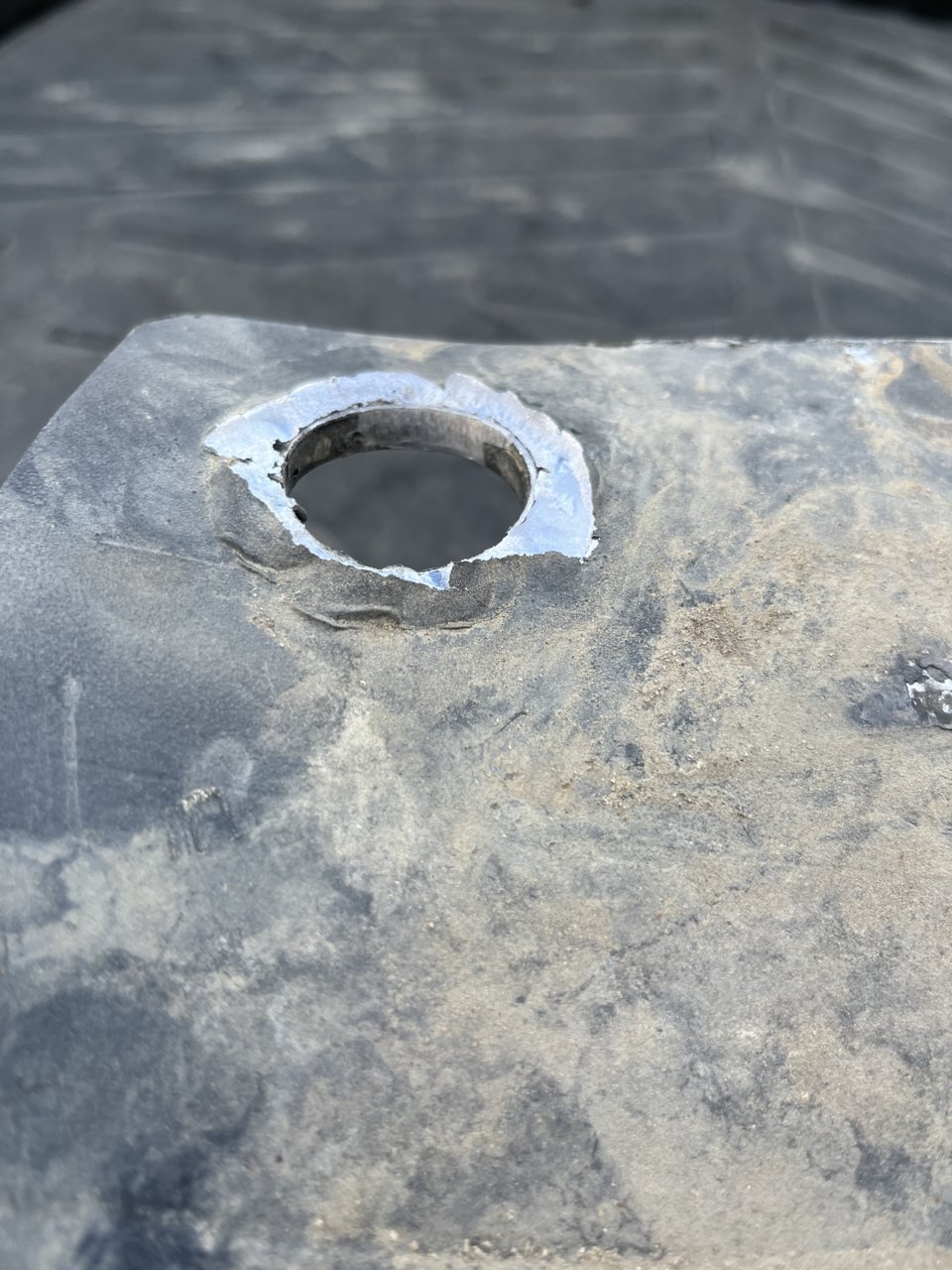

    Hopefully these pictures mostly speak for themselves. I hate to say it, but unless the user is a pure Overlander, these skids are junk. I'm going to patch them up next weekend, and ill be running costal skids later next year:
    The front engine skid mount is a 90 degree backet without gussets. Bent on the first trip, took out my frame support too. Gotta cut and weld it next weekend finally:
    Frame support bent 45 deg:
    And the weld on the rear mount of the engine skid cracked, and ripped off the plate. This failure actually caused the bolt there to fail, and I had to grind it out:
    The other skids are buckled and bent to hell, but these were the catastrophic failures

    Wow, that “support” in your first pic is super flimsy.
