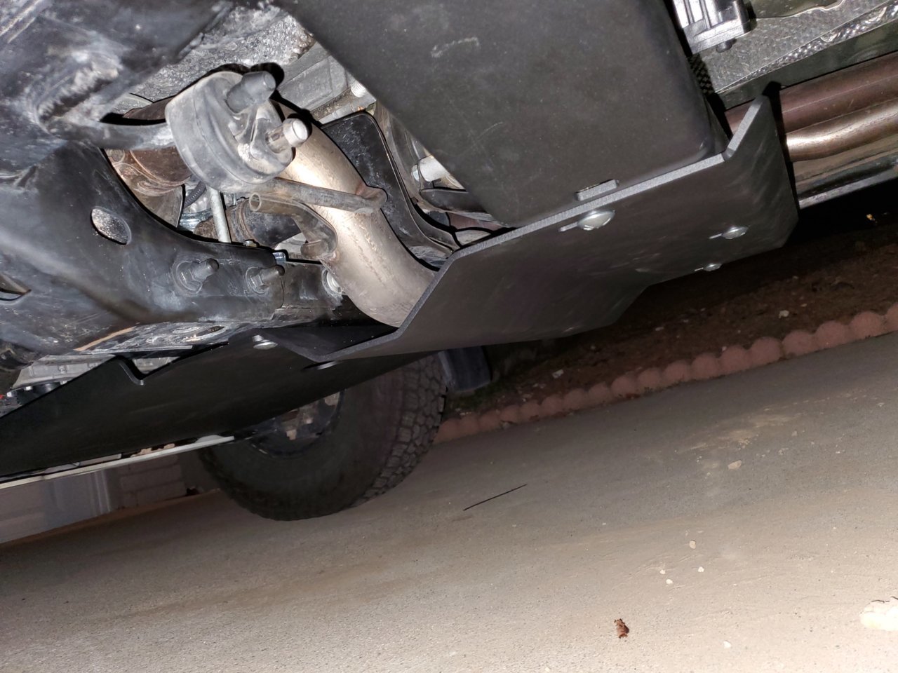

    I don't purposely rock crawl but on my last trip to the old dale mines near joshua tree it was pretty rocky and unavoidable so my trd pro skids took a few scrapes.
    As a result I ordered the rci transmission and transfer case skid plates (steel).
    The transmission skid plate is fully compatible with the trd pro skid plate and the install was easy enough

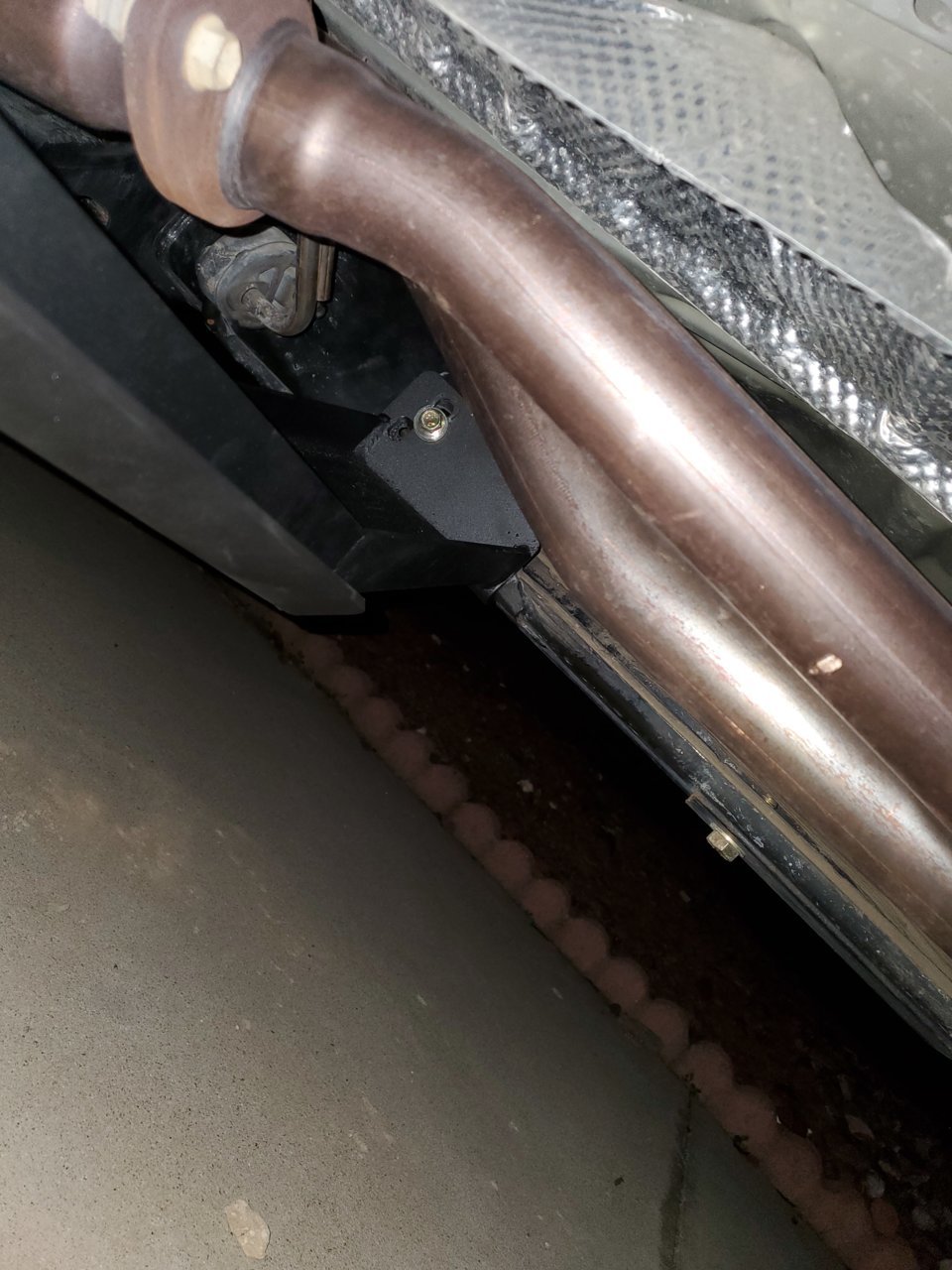

    The biggest design flaw was the crossmember where the transfer case skid bolts into. On the driver side you remove the brake line bracket bolt which is easy enough, the passenger side imo has the biggest flaw.
    I'm not sure if it's a "universal" crossmember rci uses on multiple vehicles but the way they cut the holes on the crossmember for the passenger side bolt doesn't make any sense (see the attached pic). I did use washers as instructed and it just looks like it will still have the possibility to drop or move a few centimeters.
    Also it seems like the weakest link where the crossmember is only supported by the two bolts since the rear of the transfer case skid bolts on to it as well adding more weight.
    Another thing to note, I watched a few YouTube videos on the install and I'm guessing the early 3rd gens (before 2018) didnt have the plastic blocker on the inside frame near the brake lines and on the passenger side where the bolt goes because I had to remove those for the install. (None of the tacomas had them on the YouTube videos). It appears the plastic blocker is to keep from debris getting into that part of the frame so I'll probably dremel it out to make it fit and reinstall.
    Lastly and ironically the transfer case skid does drop down a little (to clear the exhaust).
    I think it added about 80lbs between the two skid plates and the crossmember, I haven't tested them out yet but if I do hit some rocks I'll update to see how well they hold up.
    Overall the fit and finish look good and hopefully the crossmember on the passenger side holds up

    The bolt is just to keep the crossmember from moving around. When the skid plate makes contact with an object the skidplate will be supported by the metal of the bracket that extends under the frame not the bolt.

    I just installed mine 2021 sr 5 and I don’t like how that cross member bolted up 2 bolts and I snugged it up to frame but feel it may droop down due to how the holes are. I’m debating taking off. Plus said pull plugs for frame. I don’t like it being exposed now. They need to fix the holes on that crossbar. Cuz if bolts loosen it will probably bounce up & down.

    I did my father's yesterday, mistakenly put a little write-up in the RCI cat guards thread https://www.tacomaworld.com/threads/rci-cat-guards.762881/ post #20, instead of here. Wasn't difficult. Modified the "blockers" that are bolted above the frame on both sides right at the spot where the RCI crossmember bolts up. Was able to put them back into place after cutting a little so that they'd fit around the crossmember.
    I do see where it appears a little odd how the crossmember for the TC skid bolts and that movement could be possible but I plan to check periodically anyway and torque bolts until I'm sure it's not moving around.
