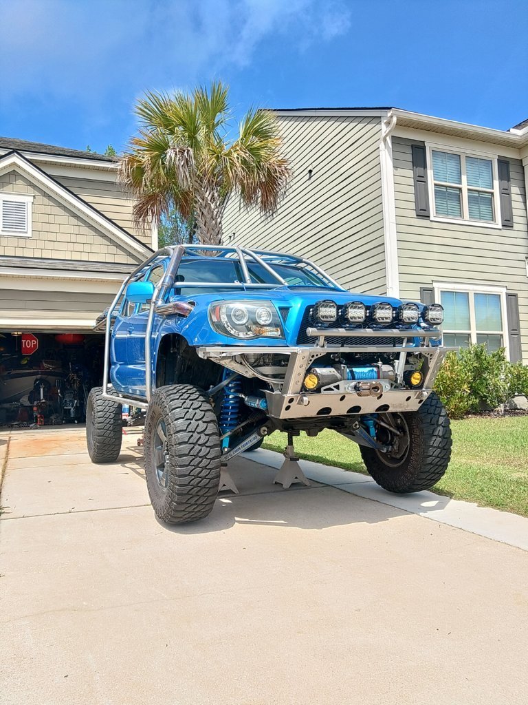

    Food for thought on width....
    I have a total chaos 3.5 race kit not marlin, but 3.5" is 3.5"
    I dont think most people truly grasp how little an inch of width per side really is. With any 3.5 kit, asuming you dont have some wild offset wheels, the outer sidewall of your tires will still be multiple inches narrower than your side view mirrors.
    I'm on the east coast with all the narrow trails you could ask for. Not once have i thought to myself a 2" narrower WMS and a bit less travel would have been beneficial.

    I dont have any head on photos on flat ground at ride height. This is full drop. Plemty more photos in the build thread. Start on page 256 if you want to see the major rebuild from the last year or so. https://www.tacomaworld.com/threads...hread-now-with-4-link-and-long-travel.163804/

    Well, that looks like a beast of a truck!
    I've asked a couple people on insta and so far what I understand is most of them picked the 2.75" because they didn't want to run super wide spacers in the rear to match the front. I can see that. And depending on the wheel specs it might end up being pretty wide. I have 8.5 0 offset bead locks. Even with a 3.50 track width I would be narrower than some folks with the 2.75 and a 9 -38 off set wheel. I think it's a balancing act. If I get the 3.50 and want to run really aggressive offset in the future I might end up too wide. I haven't made up my mind yet. I need to mull this over for a bit longer before I drop $10k on the kit.

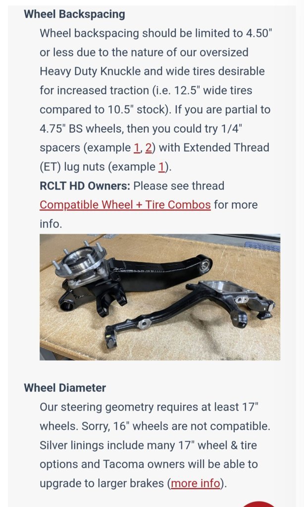

    As for wheel offset you may need spacer in the front to run a 0 offset wheel. 4.5" is the minimum backspace to clear the spindle upright. This is on RCLT product page.
    I run a 17x9 -12 offset beadlocks with a 12.5" wide tire and it's very close to the spindle.

    I'm so glad we're talking about this because a 8.5 wide rim with 0 offset translates to a backspacing of 4.75. That means if I choose to go with the 3.50 kit I will need a 1 inch spacer. I'm already running 1.25" so might as well leave them on in which case the 3.50 kit would be SUPER wide.
    Would you happen the know the difference between the full capacity installation of the RCLT vs the limited installation? There is a thread somewhere on this forum where BigMike dropped travel numbers of each installation but I could not find any explanation was to what the difference is.

    If you keep your 0 offset wheels you could install a 1/4" spacer in the front. Which effectively would put you at a 4.5" backspace. If going that route it'd be smart to also install longer wheel studs. This would be true for either kit.
    My understanding is the limited install is using the stock CVs but changing the axle between them for a longer one. The stock CV are not able to achieve the higher working angles of the RCV Axles so you'd have to limit travel so not to bind the stock CV joints. If that makes sense.
    The if using the stock CVs with the replacement longer axle shaft it is only available for the 3.5 kit per the RCLT product page.

    That makes a lot of sense. I wouldn't want to use stock CVs. I'm still leaning more toward the 3.50", though. BigMike's truck has the 3.50 and due to his wheel offset it looks about the same as some other 2.75" builds. But he gets about 20" of flex in the front which is INSANE for IFS. Even for a SA build, 20" requires some fabrication work beyond just installing longer shocks and lift springs.
