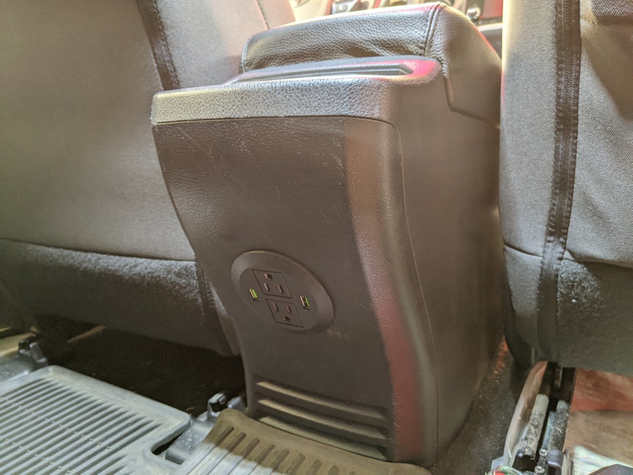

    I just wrapped this up. Did a quick test with a corded drill and a charge verification on my phone. Separately obviously.
    The slowest part was the time it took me to realize that the rear console just lifts out. LoL!
    Thanks for offering the PnP harness. That made the job a piece of cake.

    Looks great! So you cut my connector off I assume and just used the 3 wires to power your own AC outlet?

    Yessir. I had that outlet on the shelf forever.
    I wanted the mod for a few reasons. Primarily rear USB, but also A/C charging in the cab (R/C and tool batteries) and device power.
    Your harness made it all very easy though.
    Thanks!
