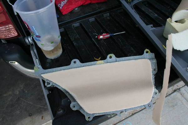

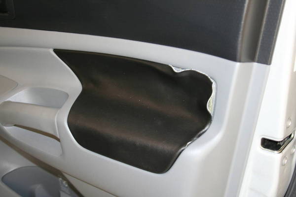

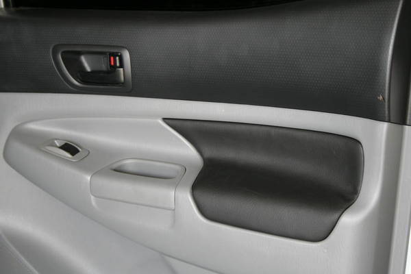

    So I decided to re-do my leather armrests today. I installed my leather back in november and the everything looked awesome until it started getting hot outside and the leather I installed on the armrests started separating from the door panel. My guess is the glue I used wasn't strong enough to hold the bond in the heat. (dont use the permatex headliner spray adhesive like I did)

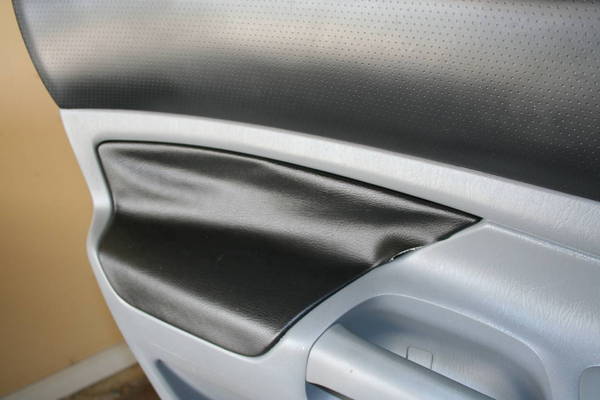

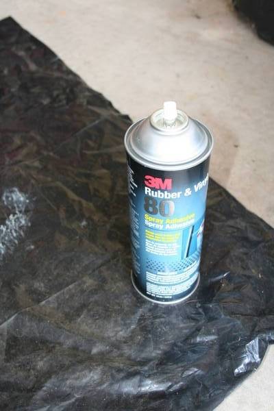

    Today I pulled the door panels off, peeled the old stuff off, and re-did them. I actually wanted to try something else this time by adding a little padding. I went to Jo-ann fabrics this morning and bought a yard of black vinyl/pleather and a yard of headliner foam. I also went to home depot and bought a can of 3M Super 80 spray adhesive.
    Here are some of the steps:

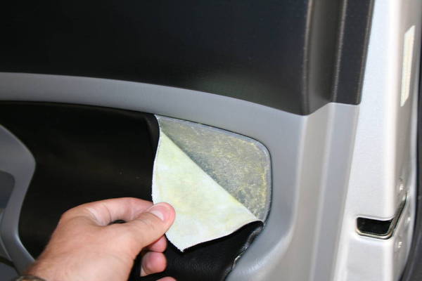

    Here are a few pics of the leather peeling off the door panel. Quite embarrassing because I'm very much a stickler for doing something right the first time, I blame the shitty glue. (yes I followed the directions on the glue, I have done contact cement and spray adhesive a thousand times before)

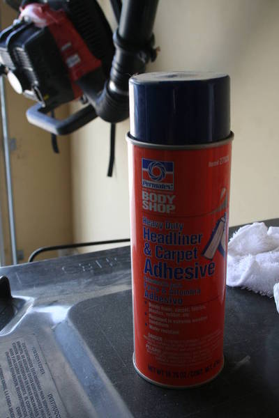

    Here is the shitty glue that you shouldn't use because it looses its bond when it gets hot.
    Here's the good glue I have used in the past for all sorts of projects...should have just bought this in the first place :(
    Door panel removed

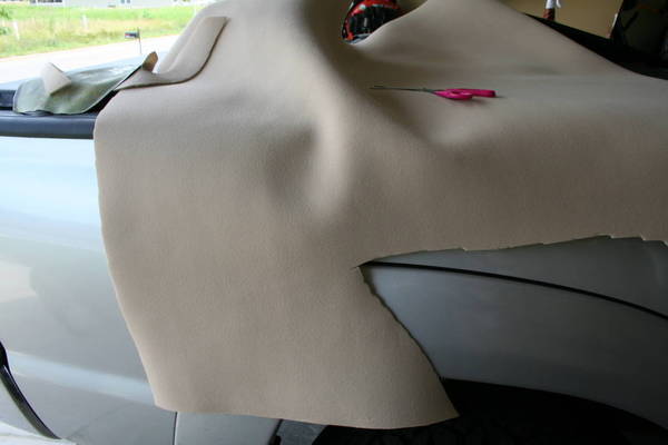

    Headliner foam
    Headliner foam bonded to the door panel insert and excess material trimmed off with a razor blade

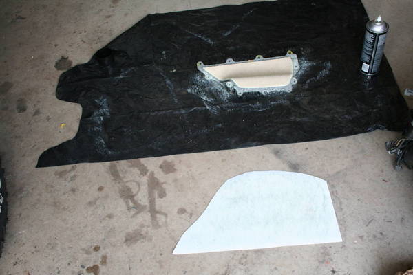

    Then spraying glue on the insert with foam already glued and spraying glue on the back of the vinyl. Let it sit for 4-5 minutes then bond the two surfaces together. Roll out bubbles with your hand and a roller starting from the inside curve outwards. Be careful and bond the inside curve first, keeping the vinyl off the foam then working your way outwards.

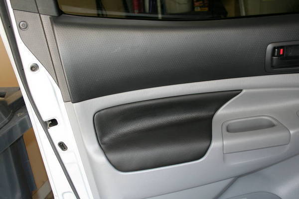

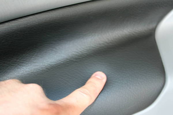

    Finished product of new vinyl with foam padding and the good 3m glue.
    Notice the padding :D
    Driver's side rear door done.

    So the moral of the story is...don't buy the shitty permatex glue. Also I probably should have done this originally which is to not trim off all the excess. This time I left a good 1" of material on the insert piece to allow any expansion and contraction of the material and not show a seam.
