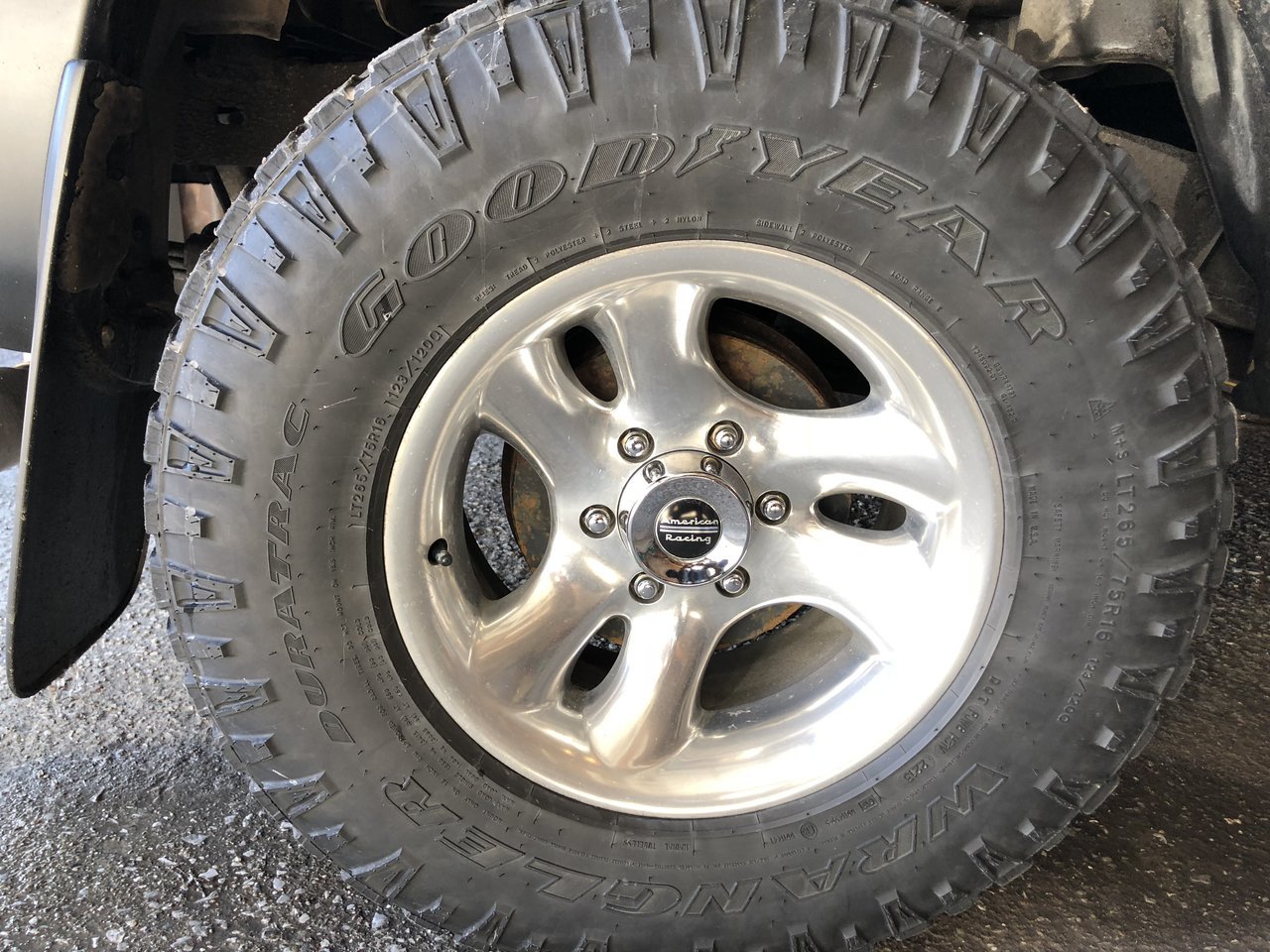

    Use a fine sandpaper to remove any paint clear coat.
    I used mother’s aluminum polish and a scotch brite to clean then used the mother’s with a powerball on a drill. These have became my winters the oxidation can be held at bay with a good sealer.

    The sue will be getting any old clear coat off. That won't polish off, at least not easily. I'd bet if there is clear on them, somewhere it has cracked and there is corrosion going on under the clear. Or this, you'll need to media blast them with something like walnut shells. Anything too hard will eat into the metal and require more polishing.
    As for polishing.... depending on how shiny you want them, be prepared to spend days doing it, especially with a drill. I'd personally pay a shop to polish and clear the, if that's the look you want. Could also have a decent powder coater coat them with a chrome like high temp coating... mine does this and it's very durable and shiny without all the aluminum headaches.

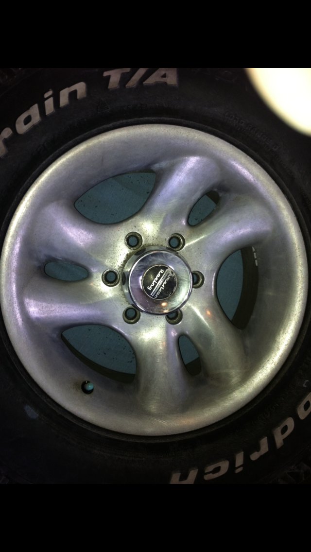

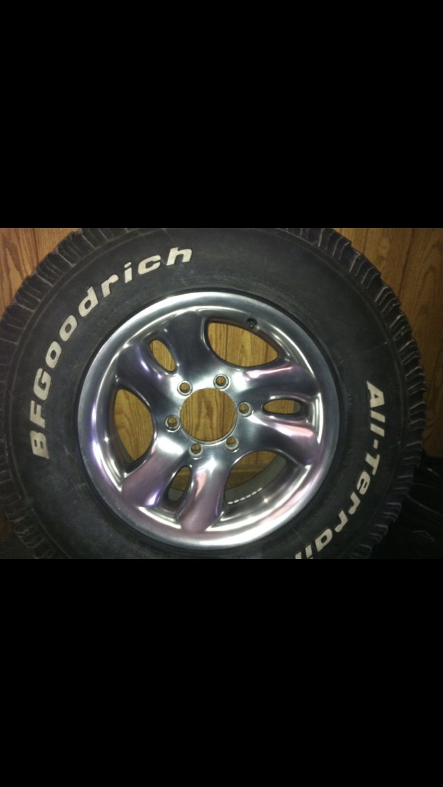

    those don't have a clear coat on them, it is raw alum.. you can get them shining with some work, but keeping them that way is another story.
    I started with a metal finishing pad (like scotch brite) and heavy cutting compound, and work to finer compounds they will get mirror polished..

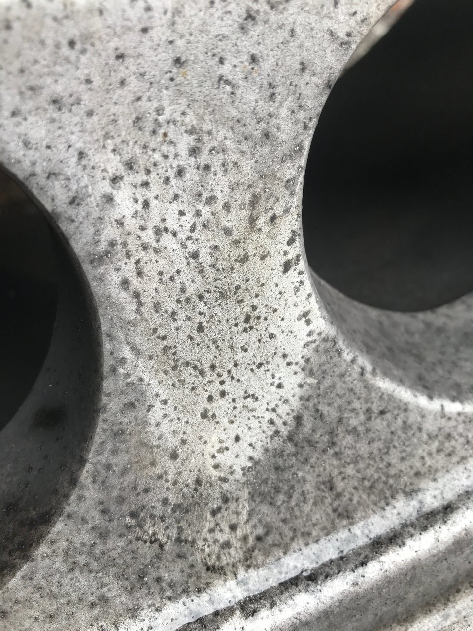

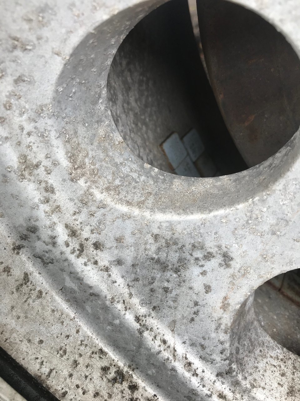

    Did you take a look at my last two pictures? Will those raised bumps be like rust where if I sand it down it'll create divots and uneven areas?

    Should not be any rust, the surface may not come out perfectly smooth depending on how much time and effort you put in.
    They are aluminum and aluminum is very workable. It is pretty easy to remove material so being to aggressive will leave more finishing work. Also being to aggressive will change the lines/shape. Mother’s makes a cone shaped polisher that may work well in the holes. My wheels are actually pretty easy not a lot of tight spots. And they are actually easy to maintain with no worries about scratch’s or clear coat peeling.

    I think I might pass on buying them. A lot of work to make them look very good with all the bolt heads on the outside and some deep corrosion.

    Those look pretty heavily oxidized. Does the decorative bead lock ring remove? If you can't get that ring off, it will be a hassle to try to clean up around the bolt heads. There is a substantial amount of work to bring those back. Not impossible, but I am in the camp of it being more work than what it is worth.
