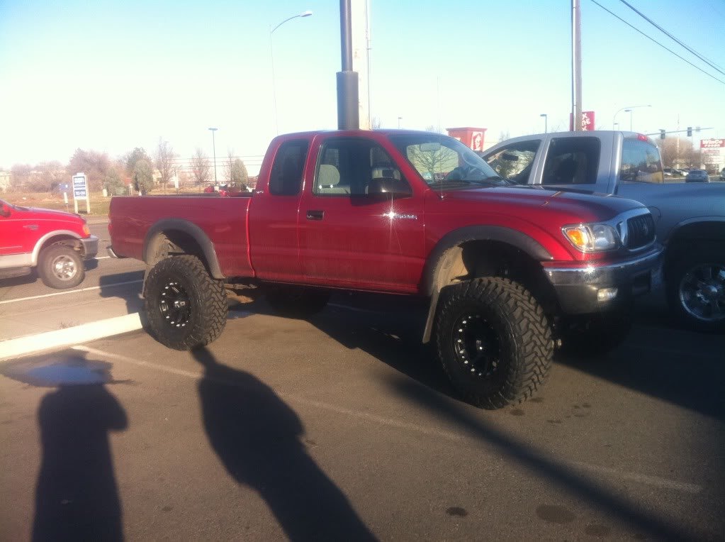

    Hey Everyone,
    First off i have a 2004 Toyota Tacoma SR5 4x4. I recently added a 6" fabtech lift and 35"X12.50 toyo Mt's. Ive been searching on the fourm for a few days now and cant find a thread with somebody with the similar set up as me. My truck drives fine in town but i do find myself at loss for power on the freeway and pulling hills "which was expected". I planned on regearing my truck shortly after the lift but cant find any information with similar setups.
    My Questions:
    What would the correct gears be to put in my truck?
    Is it possible to have the stock power back with 35's?
    Does anyone sell a kit that comes with everything?
    What is a respectable brand name for gears?
    Thank you for any information that can be suggested!
