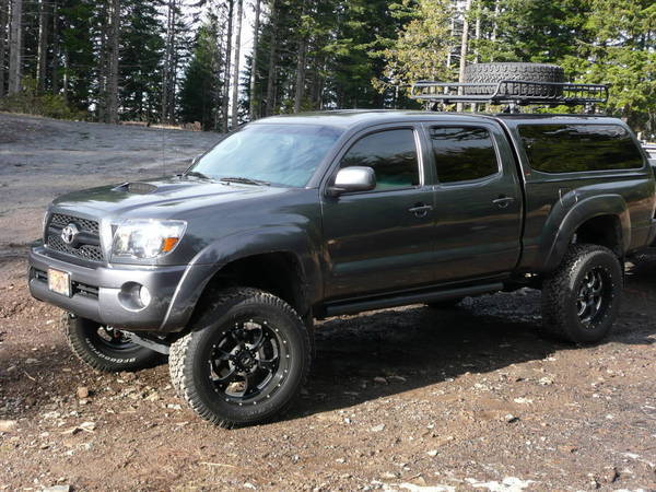

    heres a picture of the truck

    is it invisible?:) haha

  11. Feb 1, 2012 at 9:23 AM
    97yota4wd
    97yota4wd Well-Known Member
    Aug 26, 2010
    #42280
    12,834
    Eric
    Mesa, AZ
    alot of metal, small engine, decent travel.
    caged, camburg long travel, 50t leafpack (soon to be installed) light rack over cab, 5pt harnesses etc
    nice! how big of a concern is gas mileage to you?
