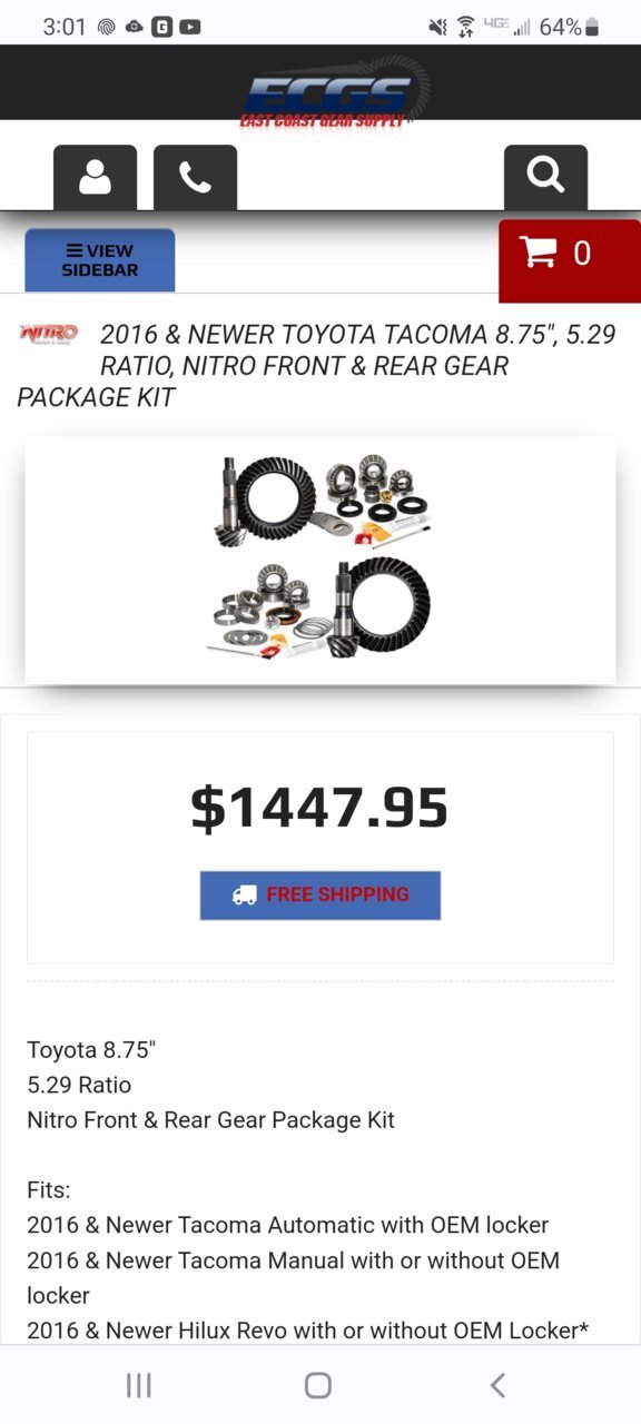

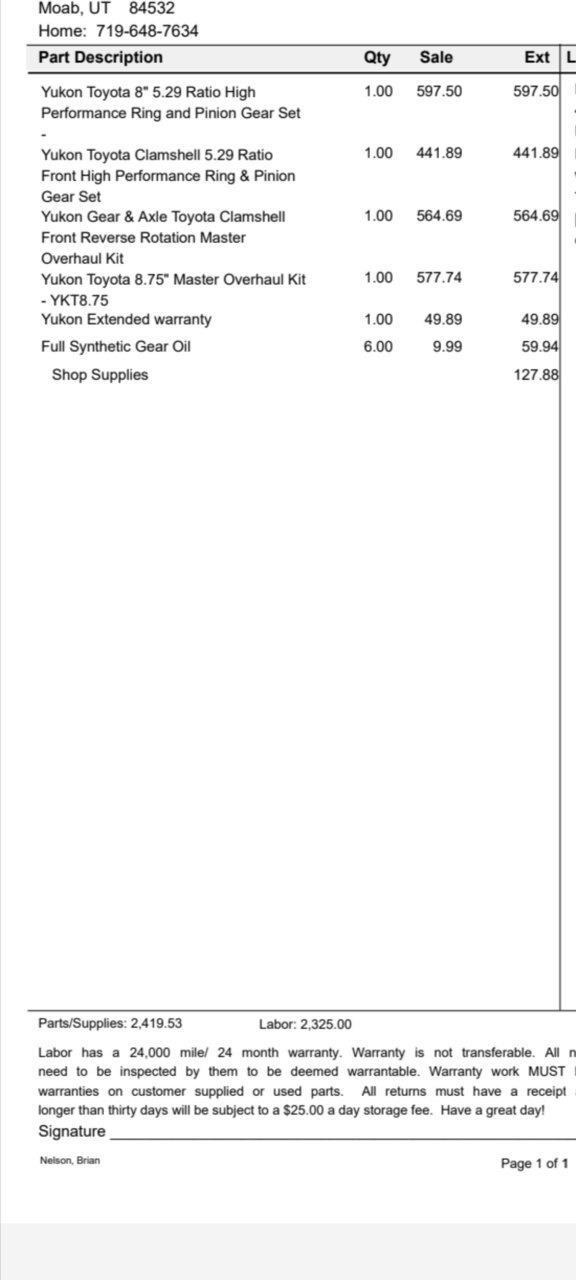

    What is wrong with this parts list? I found a kit from Nitro that's $1400. My shop sent this parts list that's a thousand more but I'm thinking they added parts that aren't needed or correct?

    Here is what looks like a complete kit for mushers and a more preferred brand

    They stupid. They got the wrong R&P for the rear diff too. Should be an 8.75 and not an 8. Go find someone else.
