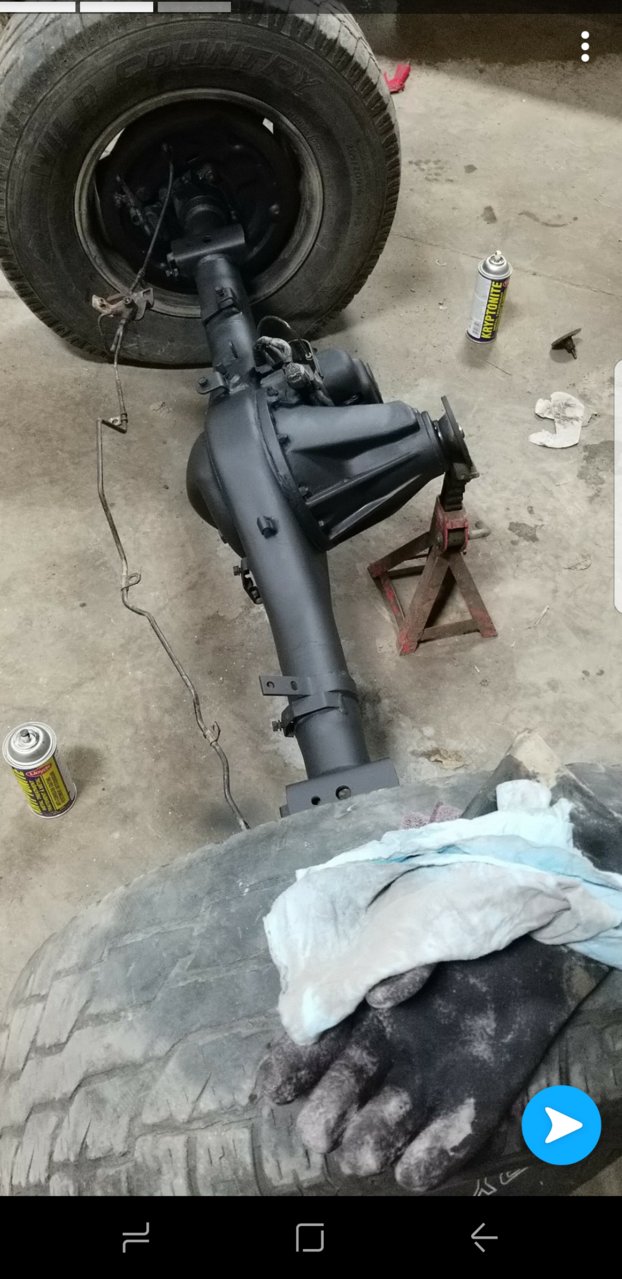

    Re gearing is worth it if you find a known good used elocker rear and front that matches. I bought a friend's truck he rolled swapped all the components myself and wired it all up.
    It cost significantly lower than a re gear kit for front and back.
    No I didn't end up with the perfect ratio but it was also a locker.

    It is a 8" rear axle instead of your 8.4" they look similar but you will see the elocker ACTUATOR! on the drivers side of the pinion. You can get 8" non locking but I think they were only in 4runners. (Could be wrong)

    ok, any issue with having the locker on the outside of the differential? seems like a bad idea when considering off-road applications.

    Locker is inside the diff. Elock Motor is mounted externally.
