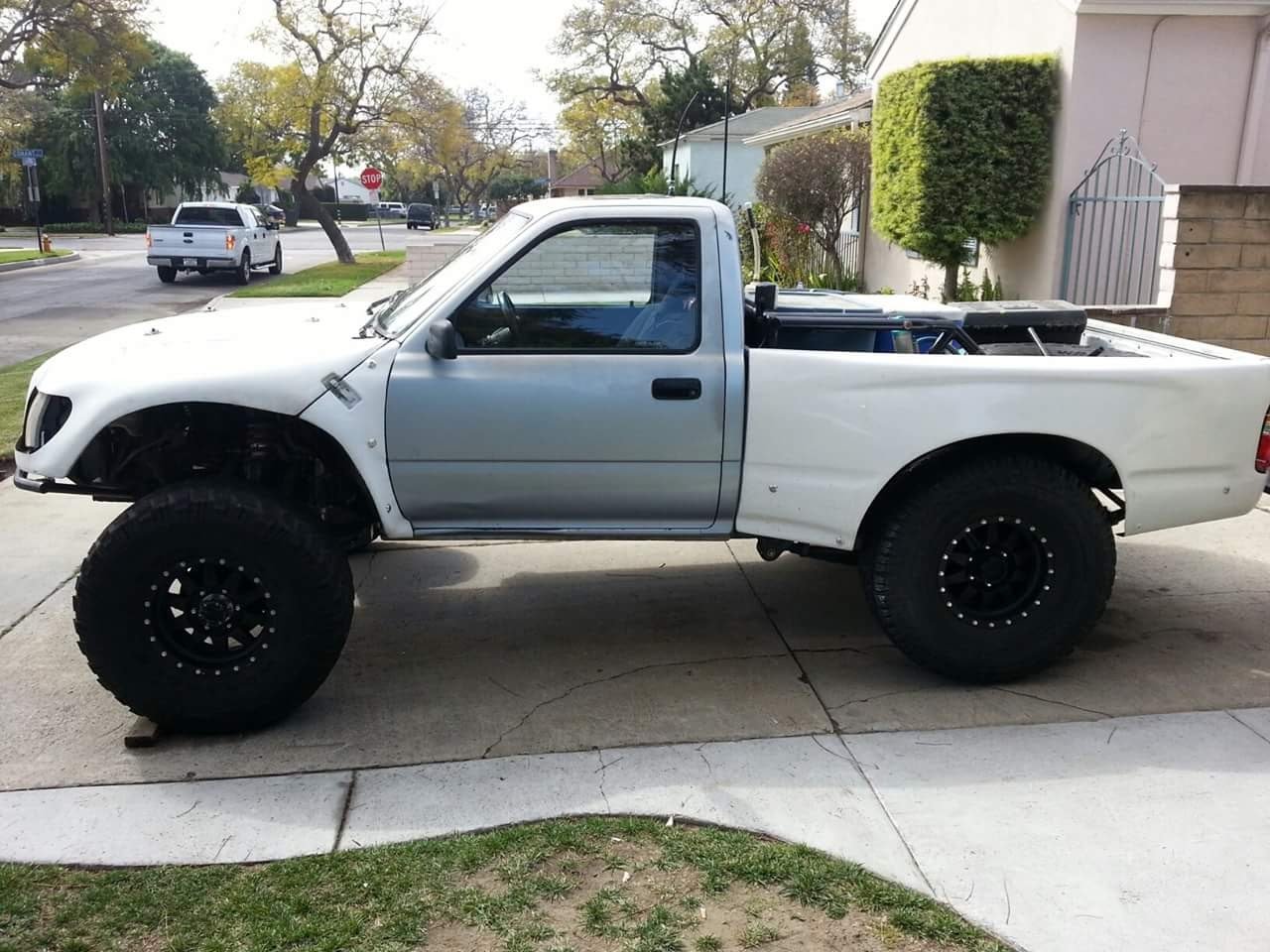

    I remember using the calculator when I did my Toyota pickup, but I didnt listen.
    4cyl, 5spd, 35's and I went 4.88s. I was scared to go higher but i should of went 5.29 when it calculated to do so.
    And it was a daily, so I needed highway and low end
    Miss that little fucker
