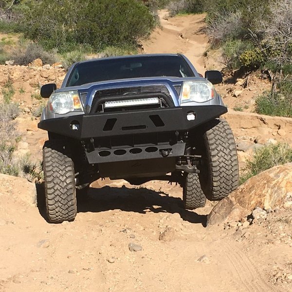

    anthony250f
    anthony250f Well-Known Member
    Feb 18, 2012
    #73066
    16,748
    Anthony
    San Diego, CA
    2008 dcsb trd offroad 4wd
    I have 2.5" of lift and 35s...be prepared to cut everything
    I'm not re geared and it's fine

  8. Mar 26, 2017 at 9:39 AM
    drr
    drr Primary Prognosticator
    Oct 17, 2013
    #114681
    2,715
    Dan
    Seattle-ish
    02 4WD Tacoma
    That estimate was just for the front diff, you would need to do the rear to match as well. I have no experience with a 2nd gen, it seems like they can get by without regearing but I would imagine there would be a fair amount of power loss.
    Sounds like your suspension setup would be fine for the weight of bumpers, etc without sagging. As was noted above, you'll definitely have to do some cutting though for the tires.
