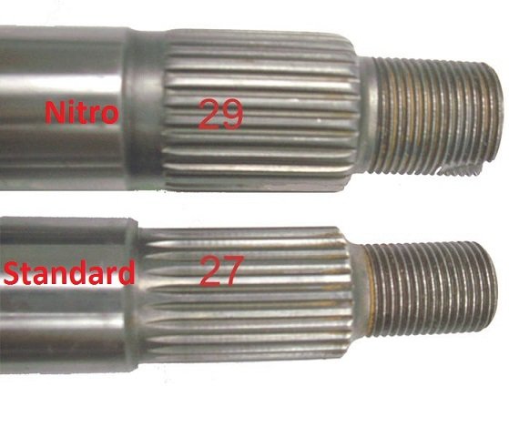

    Nitro makes a damn good gear set...I highly recommend it.
    They also offer the Heavy Duty front pinion for Tacoma's.
