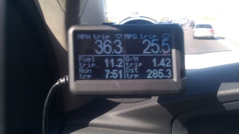

    Ok now that I am home.
    Here is a picture of my info:
    So without taking gearing into account, such as Andrew mentioned, my mileage shall equal:
    Miles= 285.3
    Difference in diameter per TW tire calculator= 8.5%
    Actual Miles = 285.3 x 1.085 = 309.551
    Fuel per this trip= 11.2
    MPG per this trip = 309.551/11.2 equals......
    27.64 MPG :eek:
    How the hell can that be right lol
