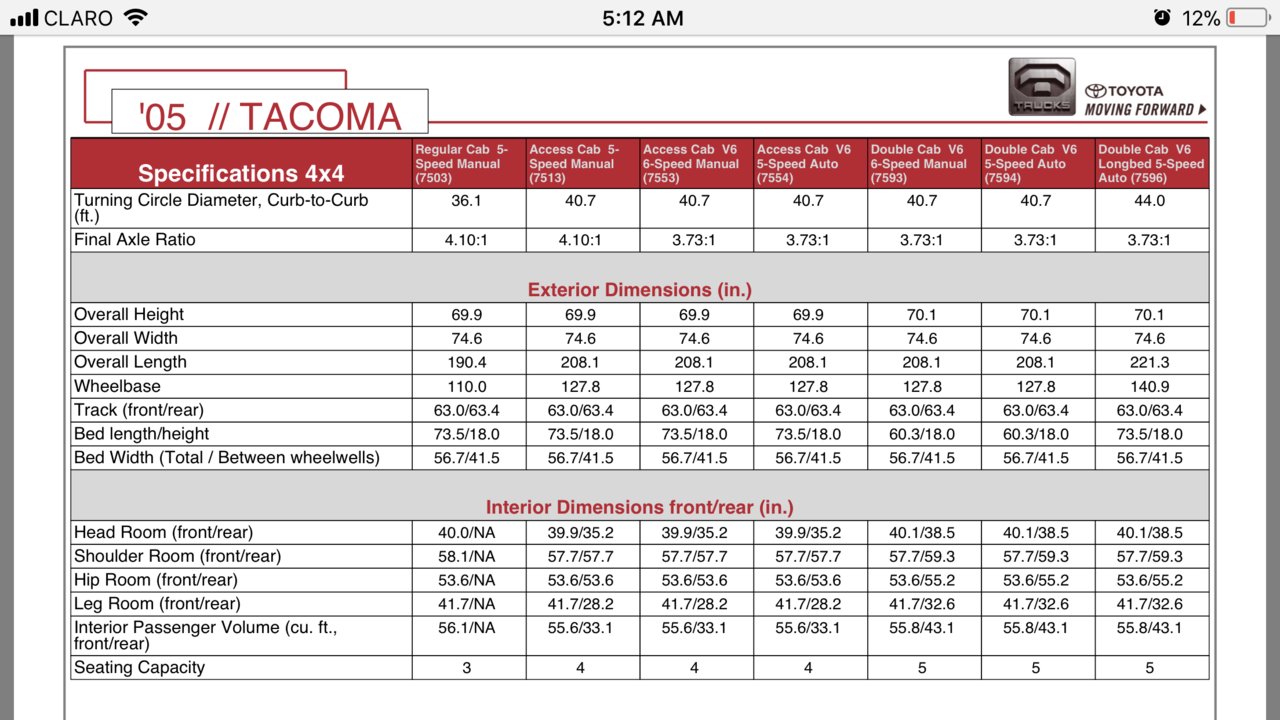

    All the 2nd gen 4x4 autos are 3.73 is what I keep seeing?

    All gen 2 with V6 actually
