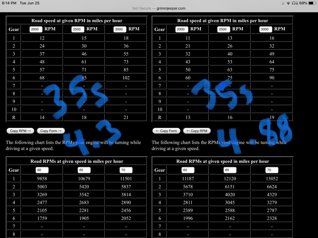

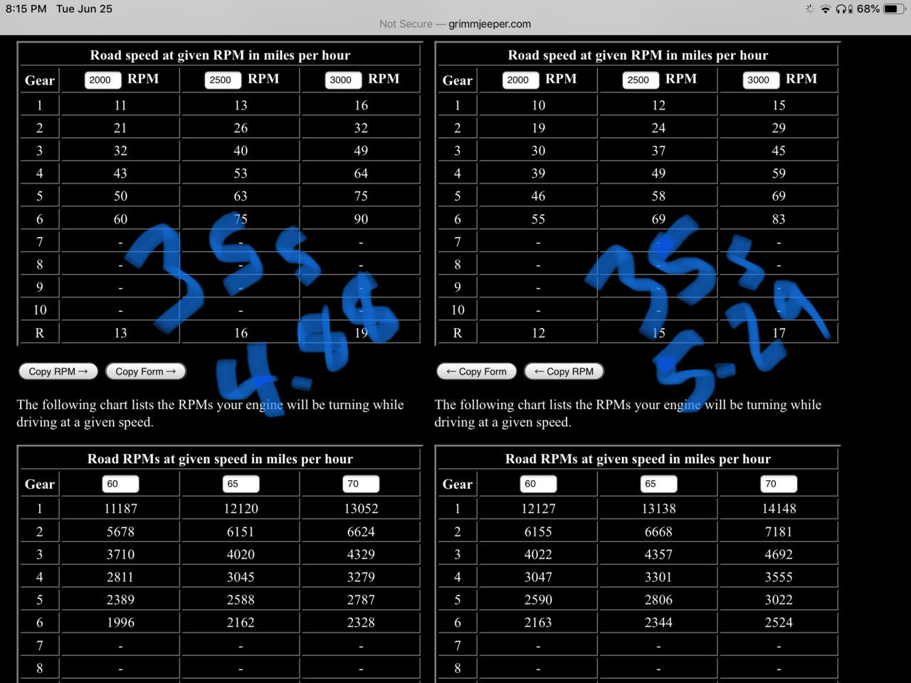

    I don’t see much discussion about regearing manuals. Here’s a breakdown of highway speeds and RPM with 33s and 35s, combined with 4.3, 4.88, and 5.29 gears. It looks like the stock 4.3 gears will be adequate, even with 35s, but I know guys have been happy they switched to 4.88s too.

    Ive got 315s and am perfectly content with the 4.30s for all on road scenarios tbh. I spend most of my time on trails in 4LO to save my clutch and thats perfectly fine as well. Looking at the speed charts, the difference in highway cruising speeds between 4.30s and 4.88s is only about 400 rpm on average, which is a bit meh for a multi-thousand dollar upgrade.
    At this point Im only considering regearing to 5.29s so it actually feels like I did something, and so I can get a front locker at the same time. Its literally my lowest priority remaining mod on this build, and definitely not a "need". Your mileage may vary, I guess. But for reference i can still chirp tires on stock gears, and wheel just fine, so Im thinking many of the responses from people saying "you cant get out of your own way with stock gears" either dont actually have 315s (most likely), have autos and forget that manuals come with 4.30s from the factory, or are just parroting bad info theyve heard the instagram legends say.

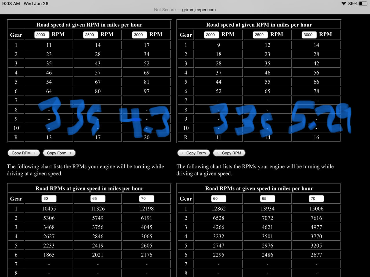

    I didn’t even screenshot 5.29s with anything less than 35s because it looks like such a bad idea. But here it is...
