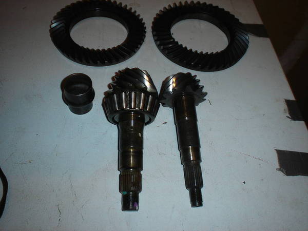

    How do i figure out what the gear ratio is? the numbers on the side are 03 7 24 3 90

    Count the teeth on the ring gear and on the pinion and divide the big number by the small number.

    Count the teeth on the ring gear, and divide by the teeth on the pinion.

    3.90
    If i was to sell these how much would they go for?

    Probably 50 to 100 bucks.
