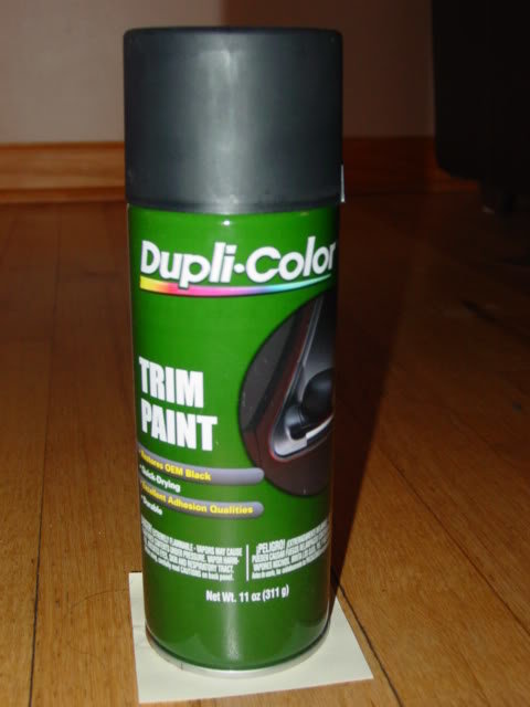

    I have repainted black plastic trim on other vehicles with duplicolor "trim paint" it comes in a green can. Make sure you wetsand with 600 grit, clean it really well with a degreaser, wipe down with denatured alcohol, then paint. I did it to the door trim my honda accord I used to have, when I sold it last year after 4.5 years it was still holding up well.
    SEM also makes a trim paint. (probably better than duplicolor) It can be purchased online or at most autobody supply stores.

    Here you go
    Or this
