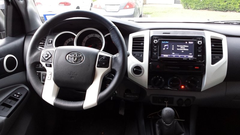

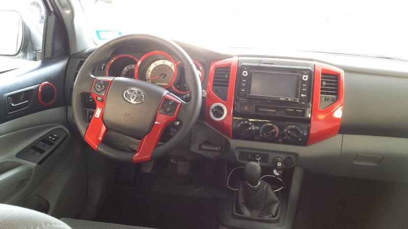

    I originally had it painted red. I didn't like it much so I decided to color match it instead. I think it looks 1000 times better.
    Before
    After

    White does look better.
    I would suggest a white shifter knob then you would be set!

    Question what kind of paint did you use? Any prep work done or spray and pray?

    Dupli-color perfect match primer, super white II base coat and clear coat. I scuffed then wiped down with isopropyl alcohol and sprayed 2-3 coats of each. I baked them in the oven after the primer, once again after the base coat and then one final time after the clear coat. I baked at 200 degrees for 5 minutes each time. Baking isn't necessary but it helps a lot. Hope this helps.

    How did you apply it? Is this a rattle can or spray gun? Is there duplicolor match for other tacoma paint codes?

    The white looks awesome. Much better than the red. I have a black truck so OEM painting my interior would be boring. I'm jealous haha.

    It's a rattle can. They had a few different ones at advance auto parts. If they don't have the one you're looking for you can probably get it on line.

    Awesome, thanks. White looks great, more so color matching looks great. I didnt want to shit on the red. I just admired the painting skills. +1

    I hated the red and that's my favorite color. It was just way too much. Thanks for the compliments. I have a lot of experience painting. Painting is a big part of my job as a fabricator in the Air Force. I have spent a lot of time in a paint booth. It's a lot easier with an HVLP gun though.

    I agree... white looks much better than red. Good job on the paint work.
