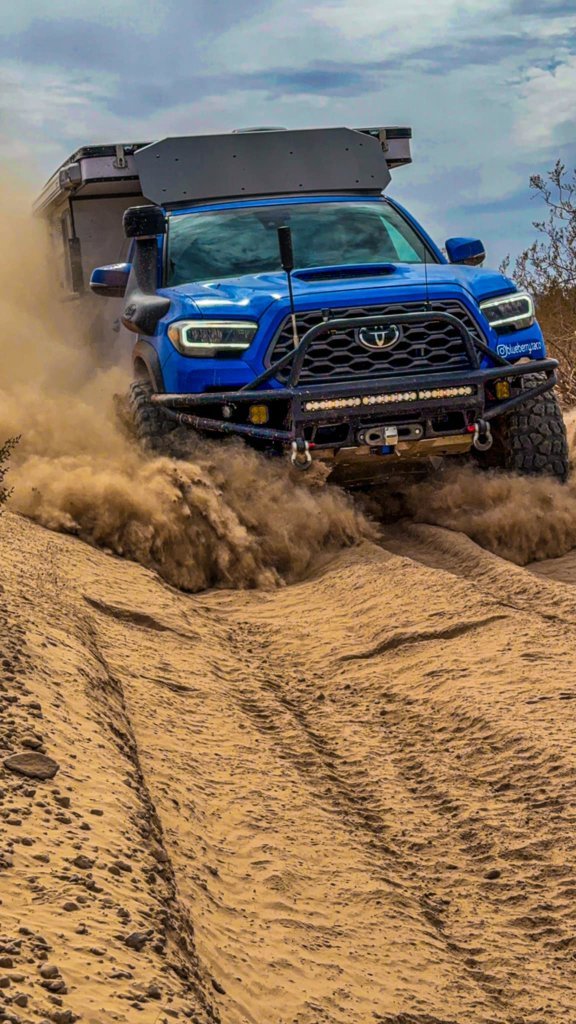

    quite positive I'm a bit heavier than you, never had a problem with sand as long as I air down.
    with my weight, I'm usually running 14/24psi frt/rr for general offroad, but if I'm on deep sand or dunes, I start around 10/15 and am willing to go down to single digits as needed.
    481060377_10102546419945877_532770934934_8606b05ffe7af1bb21d9030ae7790f3418d12d1b.jpg

    where did you get that wind fairing?

    Designed it myself and then had xometry/sendcutsend cut, bend, anodize it for me. Then I bolted it together
